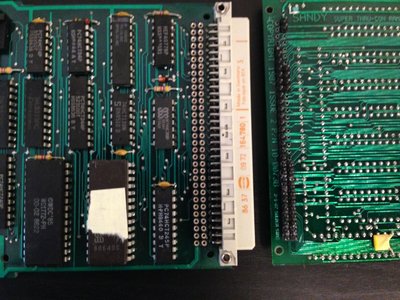

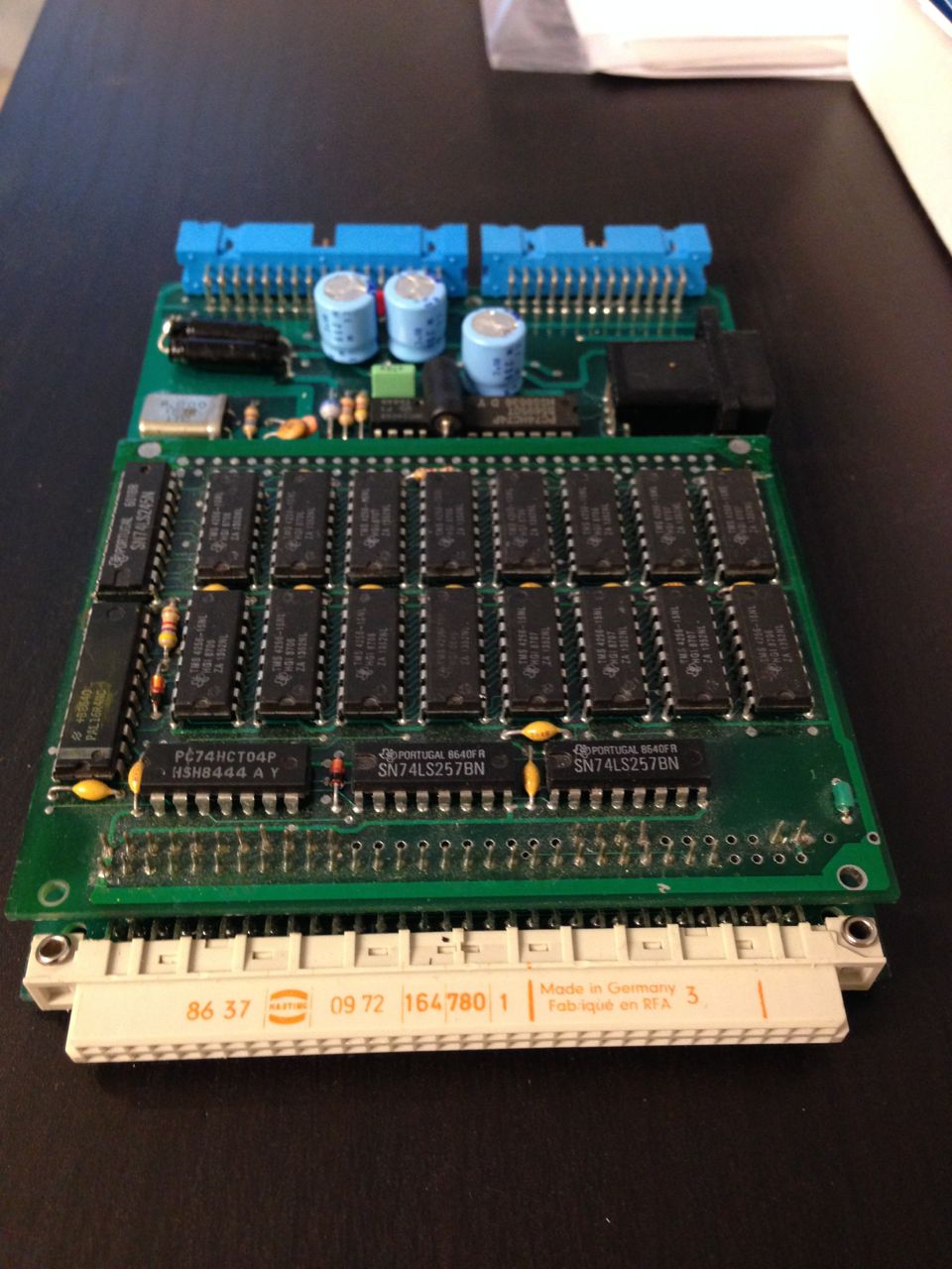

Can any ram be added to the SQB Mouse board?
Posts: 2809
Re: Sandy Q Board problem
Yes. A 512K RAM daughtercard can be added in the second row, just by adding the pins.
You need to connect as follows in the two pics:
If you need more info, let me know. :)
