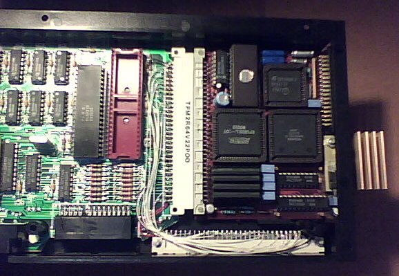

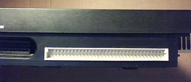

My quick solution to the same problem was to fit DIN41612 as shown...IanJ wrote:
Being new to QL, and with the idea I'll be working on some hardware projects I figure I'll need a backplane so I can plug in a memory card floppy controller and a slot free for the project I'm about to start.
David

Re: QL backplane edge conn
Ha, I like that one!
Solves the "my desk has never been wide enough for the QL" problem.
(Although it might not be ideal with respect to signal quality - But if it works, it's good enough)
