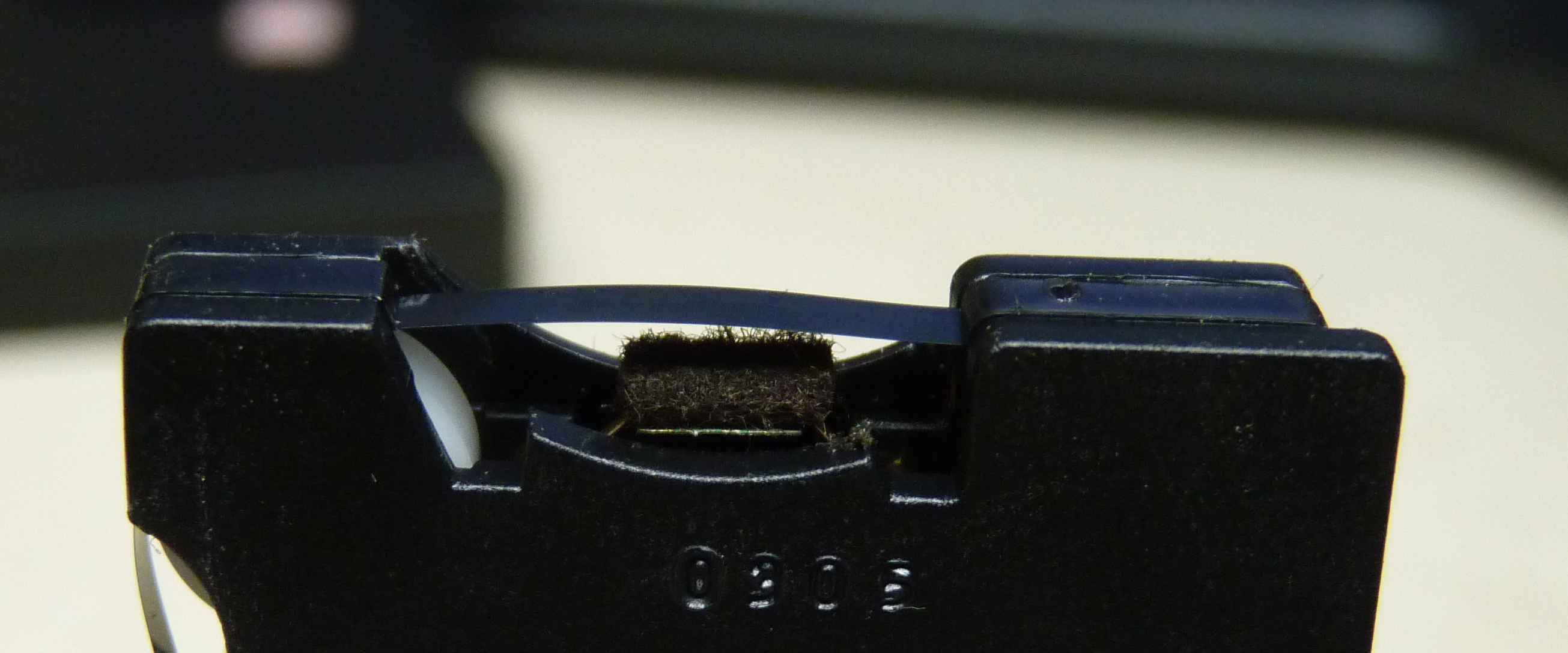

Greetz from Brazil!
I don't know how useful this tip is, but this is what I did to my microdrive cartridges
Got a small sponge (felt?) from a new (eh....never used) cassete tape, cut it in small pieces and glued with cyanoacrilate on the small yellow metal level that used to fix the old sponge.
Hope that helps :) I can do a more detailed tutorial if needed.

I've been trying the same sort of thing recently, using pieces of new self-adhesive felt tabs (http://www.ebay.co.uk/itm/281170901231? ... 1439.l2649). So far, the experiments have been quite promising, although getting the thickness of the tab correct is the key element. The self adhesive nature of the tabs makes fixing them onto the brass spring easy, and so far, they have stuck nice and firmly.
I've been trying to find out what the composition of 'proper' cassette felt tabs should be, and where to get hold of them. It seems like a waste to have to butcher tapes just to get the pads, but I am conscious that the ones I am using are a little too firm, and perhaps need to be a bit more compressible.

I have obtained the correct felt material from 3M and today I will be doing the test laser cutting to create exact felt replacements. This is a type of felt used in data cassettes, loop cartridges and was used by the music recording industry until tape died in the 90s.

As an analog photography fan, I successfully used as a replacement for the Sinclair microcartridge felt : very small pieces of the black velvet that covers the opening of used 135 (24x36) film cartridges (initially suited to ensure light-tightness), it works well and will be totally (I hope) undestructible.
