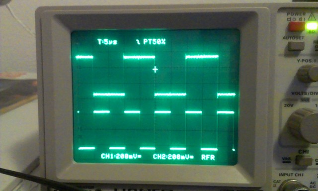

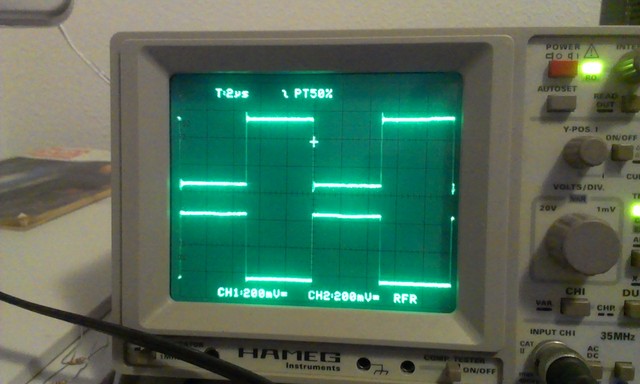

When I connect the oscilloscope to Data1 and Data2 and run the test program from the service manual I get a picture like this:
A null (0) is written into the TRACK1 register ($18022)
After writing 255 in the TRACK1 register it changes to this:
How do I interpret this ?

Shouldn't this be the opposite?
Higher frequency for 1 bits (byte 255) and lower for 0 bits (byte 0)?

* Static testing results in a square wave of 100 kHz on DATA1 if a 1 is poked into the transmit register and a 50 kHz square wave when a 0 is poked into the transmit register.
* DATA2 is always a 100 kHz square wave, just the polarity changes relative to DATA1 when poking data into the transmit register.
* How is the 8 bit data divided over the two data lines ?
* Is bit 0 transmitted first or bit 7 ?

From your scope, it seems to me that the bottom trace (2) is the clock and the top trace (1) is the data coded as FM: 100kHz = '1', 50kHz = '0'.
That way, if the microdrive is slow or fast it doesn't matter because the recorded clock that matters.

When sending all zeros, DATA1 is 10 usecs low or 10 usecs high aka no change halfway while a '1'is encoded by 5 usecs low followed by 5 usecs high (or vice versa).
FM encoding dictates that when there is a level change halfway the bit time the bit is a '1' and if there is no level change it is a '0'.
To read a bit I have to wait for an edge, then wait 1 usec to make sure the data level is stable after the edge, sample the level of DATA1, wait 6 usecs to sample the level half a bit further and compare that level with the level sampled before.
If it has changed it is a '1' else it is a zero.

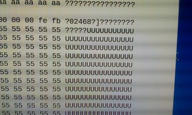

This is part of a hexdump of a received datablock from the QL during the command
format mdv3_0123456789
hexdump
hexdump
Data track2 is not read out properly so half of the data is missing.

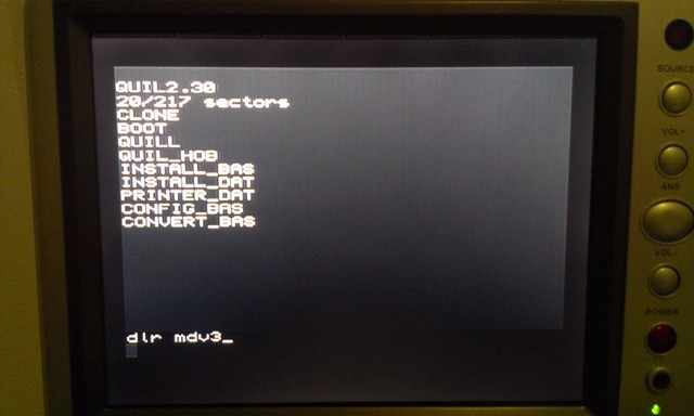

Well, result! Yes... My first directory generated by the mbed and recognized by the QL.. :D
After some more fiddling the QL now can start and stop the virtual Microdrive and thus read in any sector it wants. The mbed MD emulator keeps track of the current sector and just cycles around and around from 0-255.

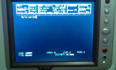

Manual loading of the boot file with LOAD MDV3_BOOT and modifying the lines which had mdv1_ in them to mdv3_
The magic RUN command was then given and behold: The Quil started...
Next step is to attach te sdcard to the mbed and get the sectors from there instead of my (huge) include file with the Quill MDV image... :)
