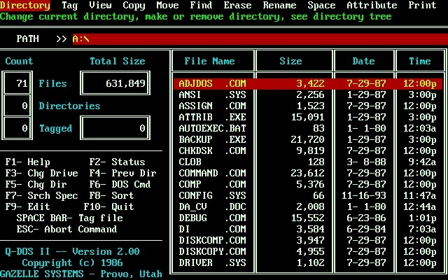

I am reminded in the early days of Microsoft DOS of a file manager type program called, of all things, Q-DOS II (Gazelle Systems). It could copy delete etc. etc. using a DOS window cursor controlled interface and was very fast.
One brilliant feature was the ability just to highlight a file and look at it in HEX form.
I used it extensively to look/hack at saved games in Commander Keen and Wolfenstein and early Command & Conquer saved games looking for lives and money values and #FF the values to get maximum yey :)
