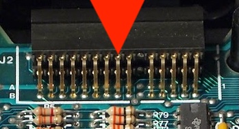

My plan is to cut the ROMOEH line at the rear of the socket (as per image) and fit a switch to the case (not concerned about making the hole as already have a switch fitted for the JS/Minerva Mk2 ROM Switcher in this QL)
Dave mentioned I'd need a 100ohm resistor, but I've no idea where the resistor needs to go from/to please?
In the QL World of 1986, November, in page 46, it's explain how to install a switch on a ROM cartridge to disable it, you can see the resistor on the disconected pin to Vcc, similar can be applied internally on the ROMOE line, just tie the resistor to GND (because of the NAND gate that invert the signal).
In the schematic is not very clear but C is the common pin of the switch, and A/B are the N.C./N.O. pins.
So the idea is in one position you link the cartridge signal to the internal ROMOE, and in the other position you leave on air ROMOE and link the pin of the port cartridge to GND, in this way the cartridge is never activated.
