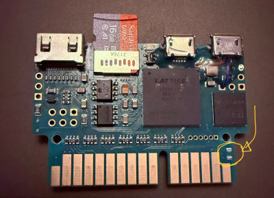

Hi
Could Peter or Stephan tell me what the diode was that I have somehow broken off from my Qimsi Gold PCB please… picture attached…
Posts: 2461
Re: Broken qimsi gold component replacement
TS4148RYG
Pepperm
Brittle Membrane
Posts: 108
Joined: Thu Jun 08, 2023 9:42 am
Post by Pepperm »
Thanks Peter

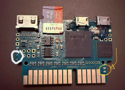

Maskenlos
Posts: 227
Post by Maskenlos »
To me it seems there is another component missing on this PCB.
Pepperm
Brittle Membrane
Posts: 108
Post by Pepperm »
Go on, which one do you think is missing?
Maskenlos
Posts: 227
Post by Maskenlos »
Posts: 2461
The one on the left: CUS10S30
Before ripping off further components, it might be helpful to get a case for protection.
Pepperm
Brittle Membrane
Posts: 108
Post by Pepperm »
Thanks I'll look into it, I do have a case though, I took it off for the photo and to allow me to replace the diode.
What does that other (CUS10S30) diode do because my qimsi does work, seemingly without it
Posts: 2461
It is for the lefthand I/O connector, typically used for QLNET with the accelerated CPU.
