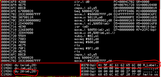

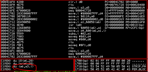

02 01 FF FF 00 00 00 20
Looks good: 02 01 is the code for a string (which I have expected).
FF FF (-1 as word, Technical Guide 9.2) indicates it's a nameless item (parameter was a literal string as 'This is a SuperBASIC string') all okay, that's what I have expected.
The second longword (last 4 bytes [00 00 00 20]) points to the SuperBASIC Variables Value area and (IMHO) should point to the string, which was passed to the function. The SB VV area is offset $28 from the BASIC variables so (IMHO):
du 20(a6,28) should point to the (QDOS) string, i.e. I expect:
00 07 41 5F 4C 61 62 65 6C 00 ([LENGTH=7 {word=2 bytes}]A_LABEL)

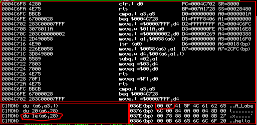

But as you can see in the following screenshot, that's not the case. If I use:
du 1e(a6,28) it's OK:
Any hints? Is Technical Guide wrong?

I'm not familiar with C1mon, but I couldn't reproduce this on neither Minerva nor SMSQ/E. When I take the pointer at $28(A6) (i.e. VVBAS) and add the offset from the parameter, this takes me to the correct location (the length word, not the first character of the string).
