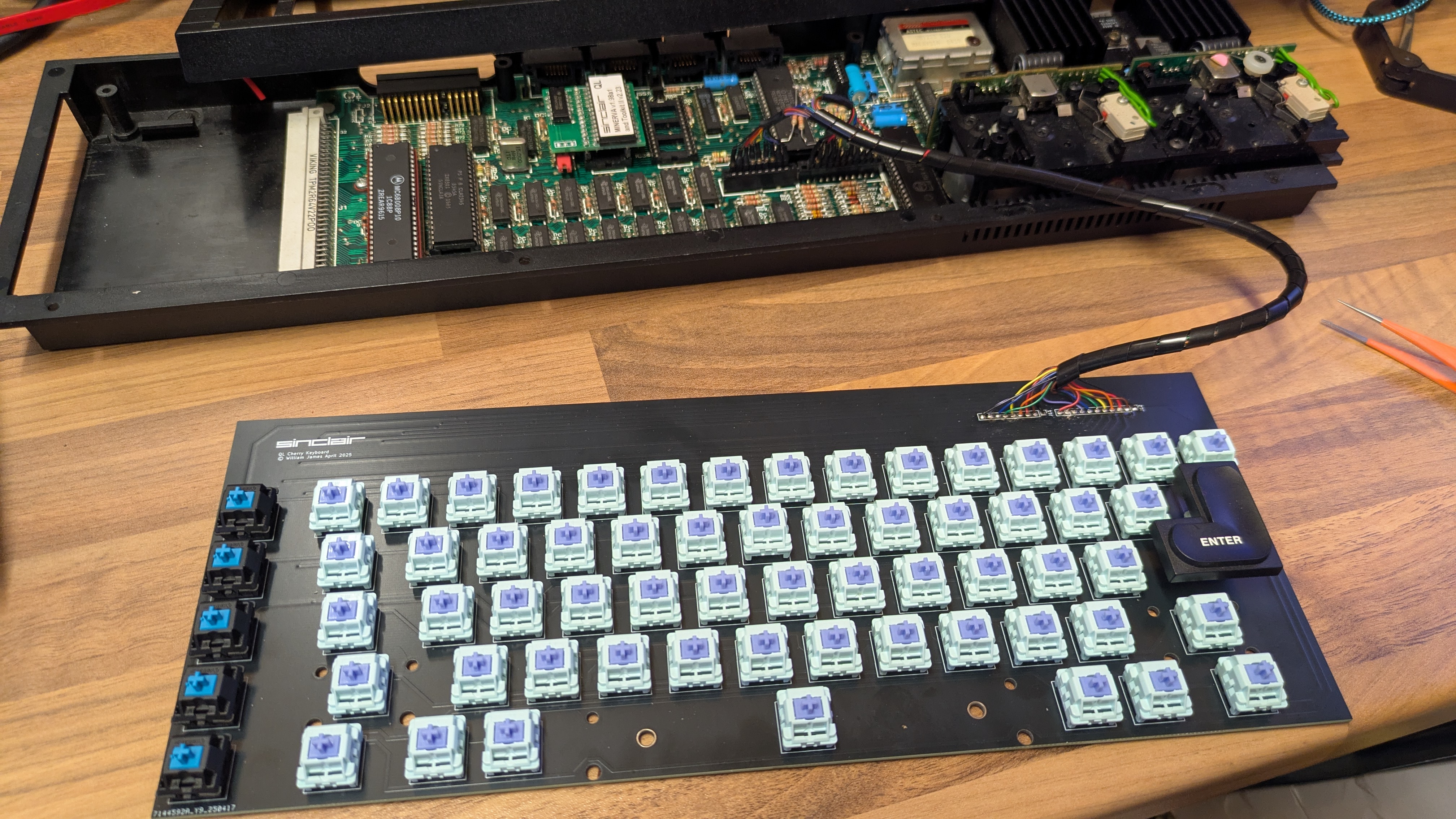

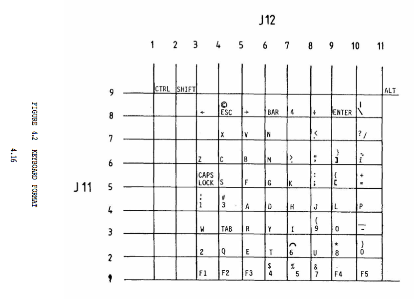

Does anyone know if the Figure 4.2 "Keyboard Format" diagram in the QL service manual is accurate? I made myself a keyboard based on it but I'm getting some weird results.
I double checked the wiring and it all seems correct according to the diagram. For example, keys 1,2 & 3 are reversed.
Will

I don't have a different thing.
Is it sure that is wiring correctly?
By the way... beautiful keyboard. I like your idea.
May I suggest some little changes for the connection?

Will James wrote: Wed Apr 30, 2025 9:13 pm Hi,
Will

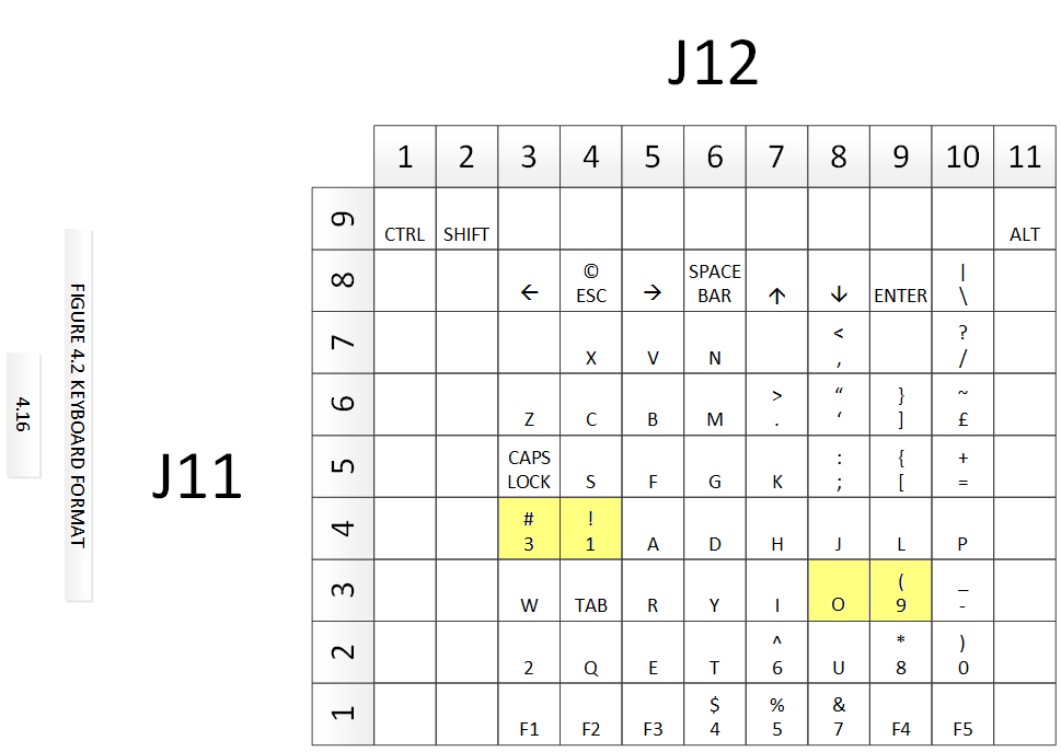

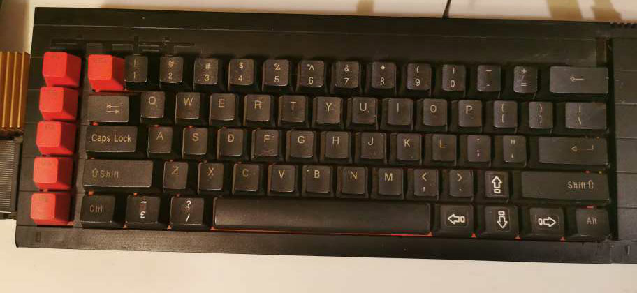

The original documentation is wrong. When I built my QL mechanical keyboard I used this diagram, which works
I used a bit different layout for my keyboard

Ha! Thanks Andrew - that would explain a few things...

Hi Popopo, thanks, yes the connection to the QL is a little bodged, I just wanted get it working so I could use it.
I will probably make a little PCB to plug into the 2 keyboard connectors J11 & 12 with an IDC cable linking it.
Looks like I will have to remake it since it was based on an inaccurate diagram from the service manual...
