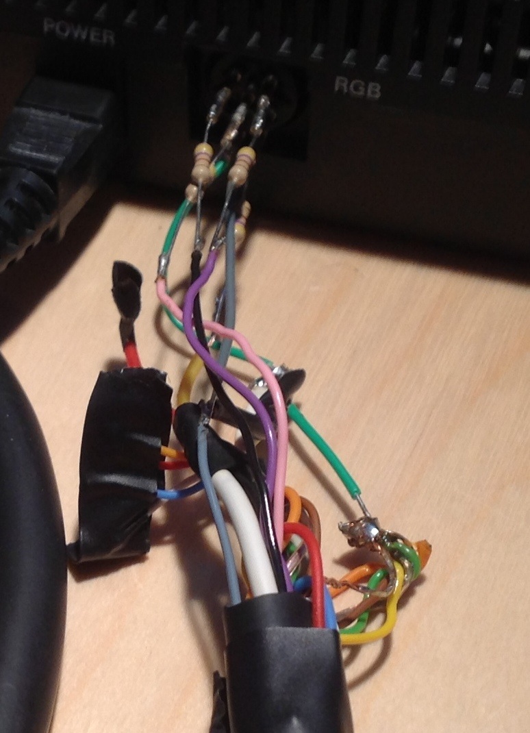

This is a nasty hack...
..but it works. I've got a rock solid picture now! I used 470R all round rather than the 330R /390R recommended by the wiring diagram I saw but it must be well within acceptable parameters.

..amazing what you can do with heat glue and an old DIN plug. The red connection is a little shaky but it works well.

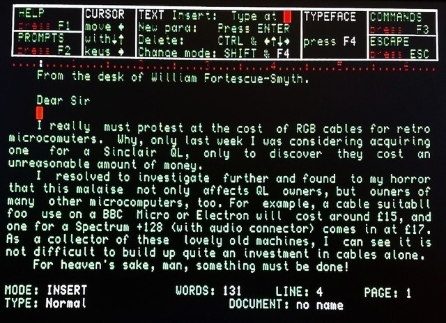

And here is the proof. Taken with an iPad so there is a small amount of blurring evident. In reality it is clearer and less washed out.
Posts: 3196
Re: QL to SCART
Looks good!
And certainly much better than using the TV modulator.
Is it TV or Monitor mode?

TV mode.
In Monitor mode I can't see the command line, although Quill looks the same. That's a point, I need to ask a question about these two modes... in another thread.

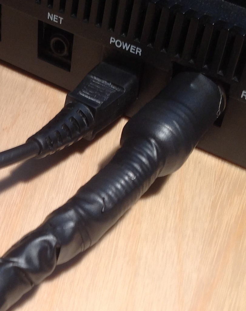

Well at least you didn't do what I did, a couple of years ago in my haste, the result can be seen below, albeit reproduced for aesthetic reasons :)
Of course this caused some amusement at the QUANTA AGM/workshop.
