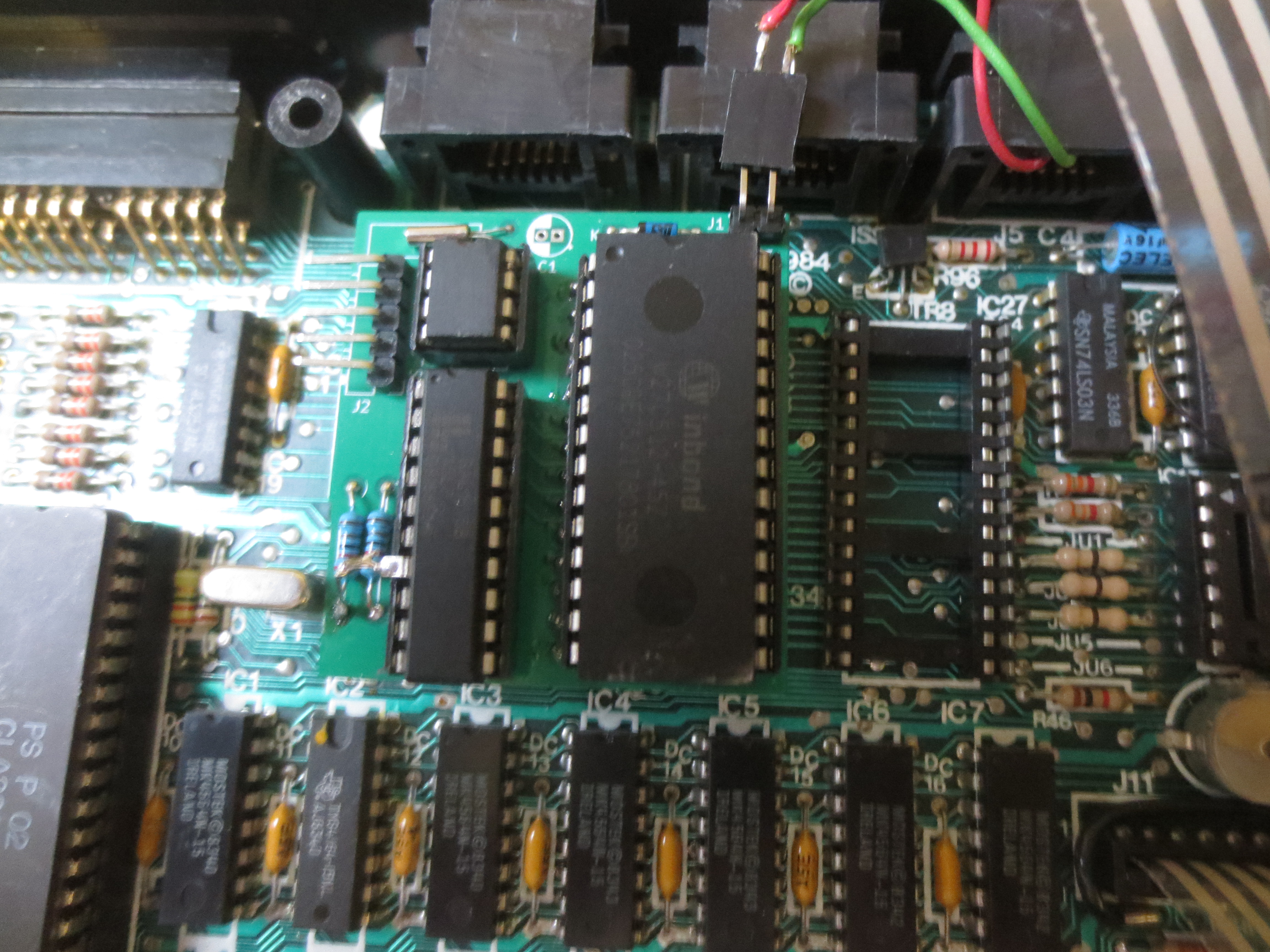

i tried installing the aalea board but could not even get minerva to boot ,
only the same "beep" as if there is NO rom installed .
so i must do either something wrong , or the board is not usable .
anyone ??
aalea
Posts: 146
Re: Has anyone ever got the Alvaro Alea Minerva MKII to work ??
Post by aalea »
Unfortunatelly the board was not usable, there a error in 1 pin of the GAL.
I already correct the PCB on github, and test it, and works, at least it hold the clock... I need to read the doc and check the autoboot features, and perhaps conect something to the I2C bus to check.
in the doc is mention a robot that will be funny to see connected to the QL.
techy
Posts: 384
Location: belgium
Re: SOLVED !! Has anyone ever got the Alvaro Alea Minerva MKII to work ??
Post by techy »
The MKII remake works as intended ,
Need to test it a bit more , all options need to be verified .
Looks promising !!
trimmer not installed yet

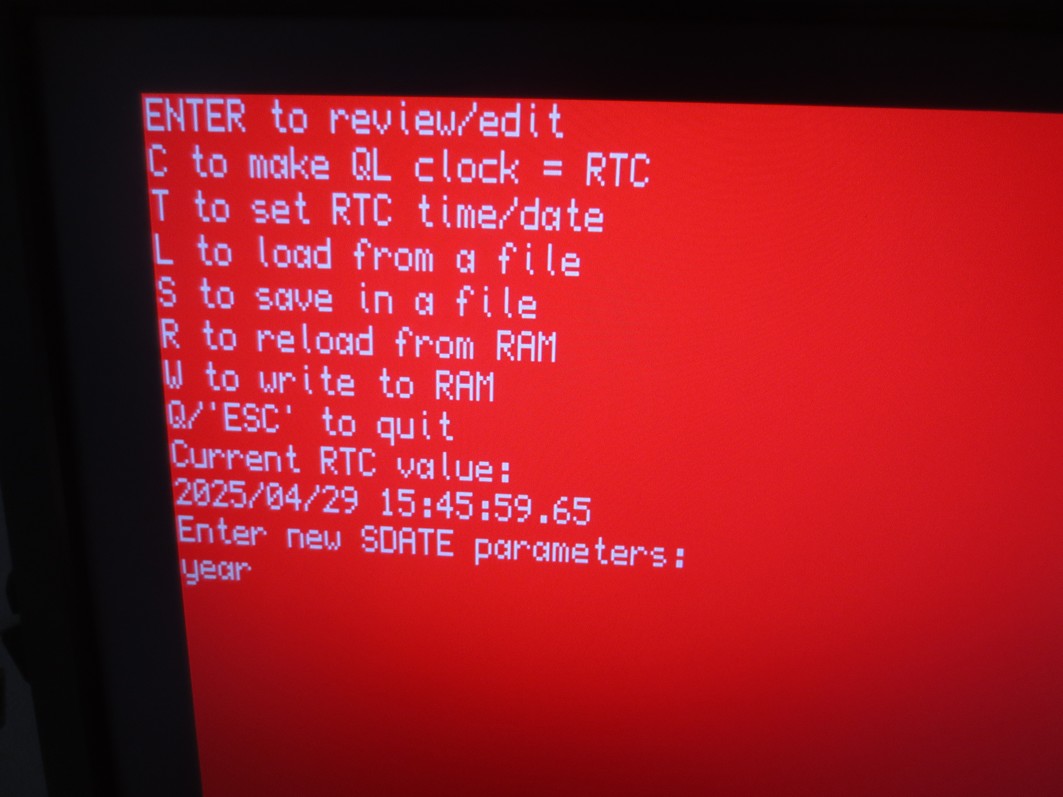

And now it has a switchable tkII too ,
pin 6 at vcc or vss to switch .
use miniconfig_bas to set the clock .
looks good

you also need to put i2c_io_bin in the same folder
and the result should look like this ;

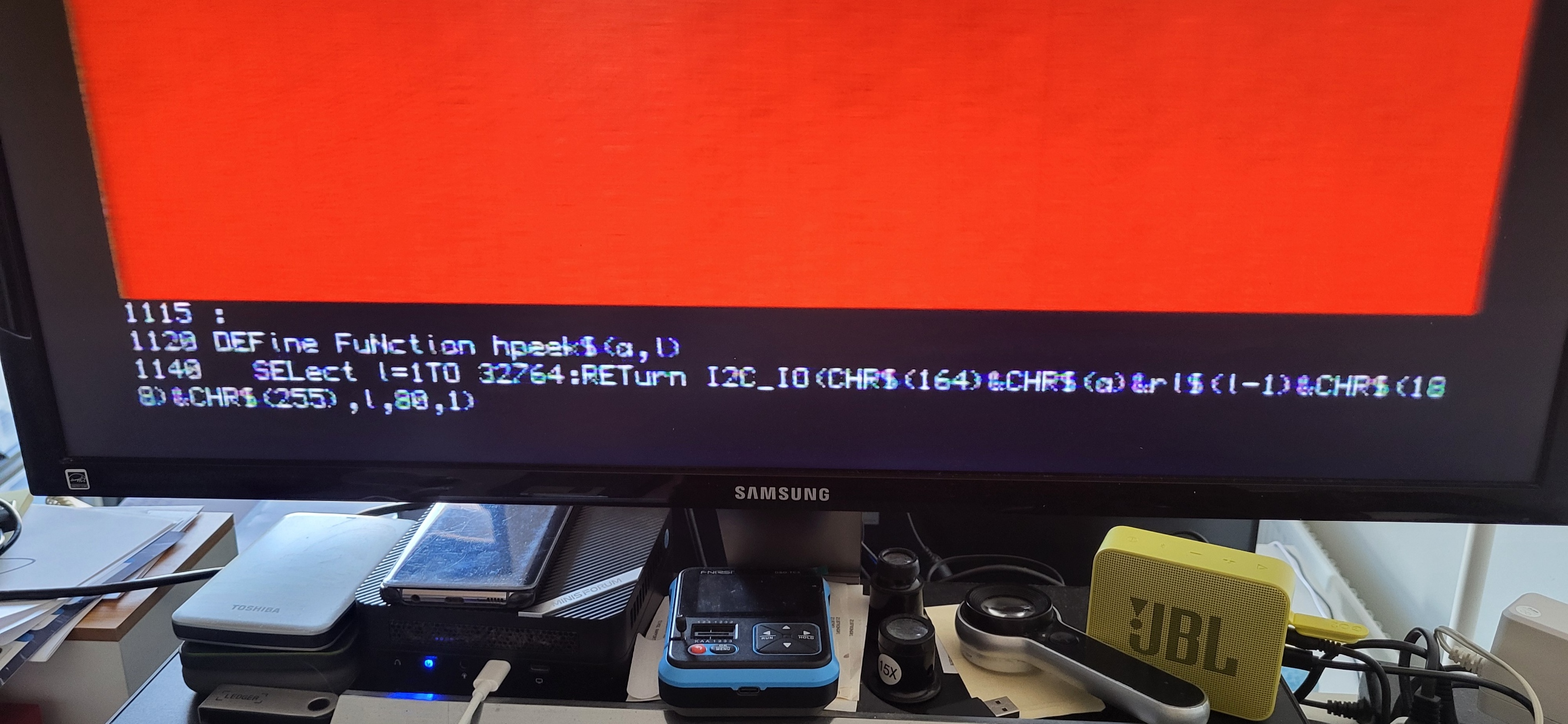

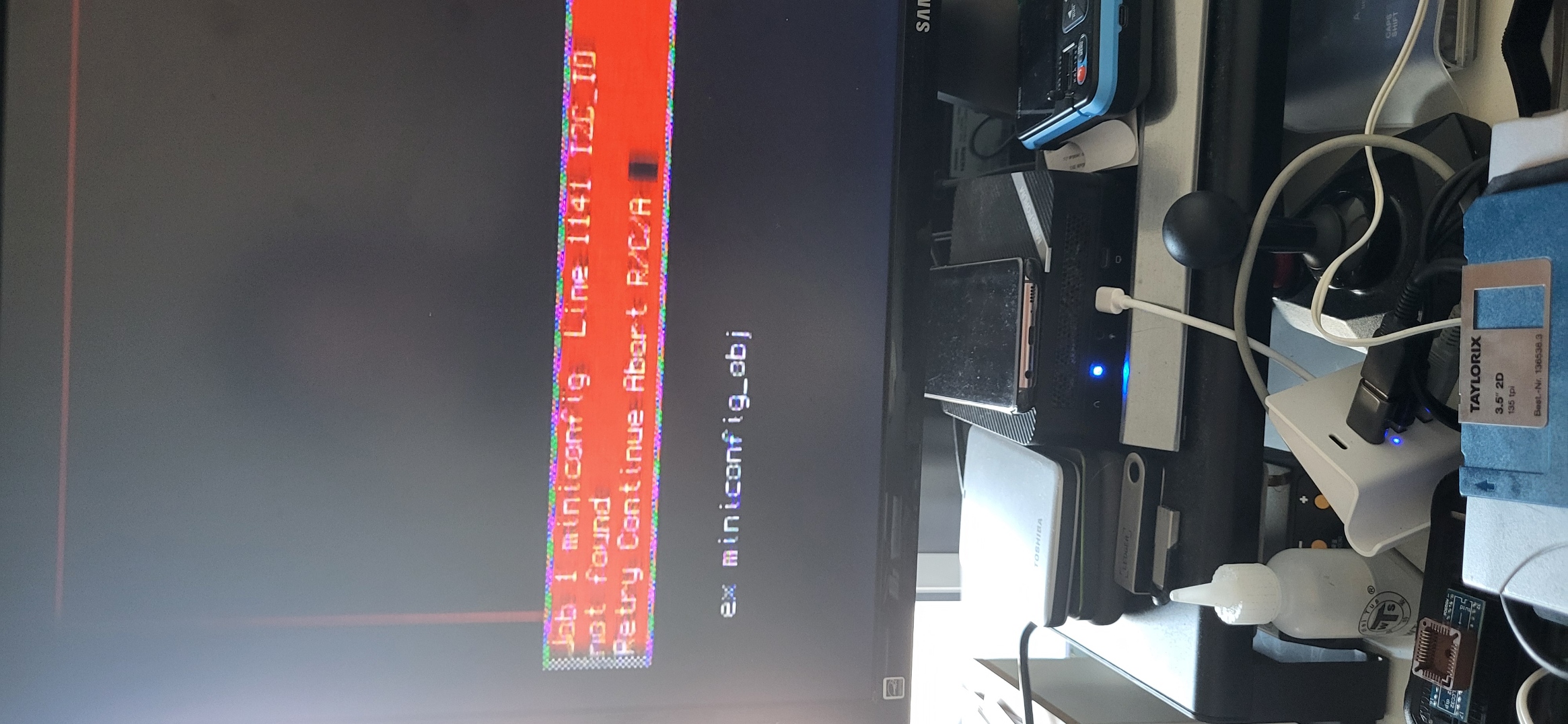

Arleybls
Posts: 14
Joined: Mon Jan 22, 2024 8:39 pm
Post by Arleybls »
techy wrote: Tue Apr 29, 2025 2:33 pm you also need to put i2c_io_bin in the same folder
Getting this..
https://ibb.co/nsx25RFf
Using miniconfig_bas from tk disk.
