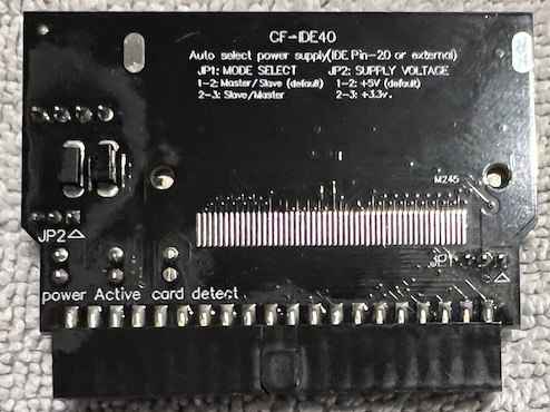

I have a CF card adapter (CF-IDE40) connected to a QUBIDE (not an original) but am having problems powering the CF card adapter from pin 20 of the IDE cable
If I connect a 5v supply to the CF adapter it works fine
If I don't connect the 5v supply the power led still comes on suggesting it's getting power from Pin 20, but the card isn't seen
The only jumpers are for 5v/3.3v CF power (set to 5v, no power light if set to 3.3v) and master/slave selection (set to master)
The CF adapter says power is auto detected
I was wondering if anyone has any thoughts on why it won't work when powered (it seems) from pin 20 please?

This is the CF adapter in question

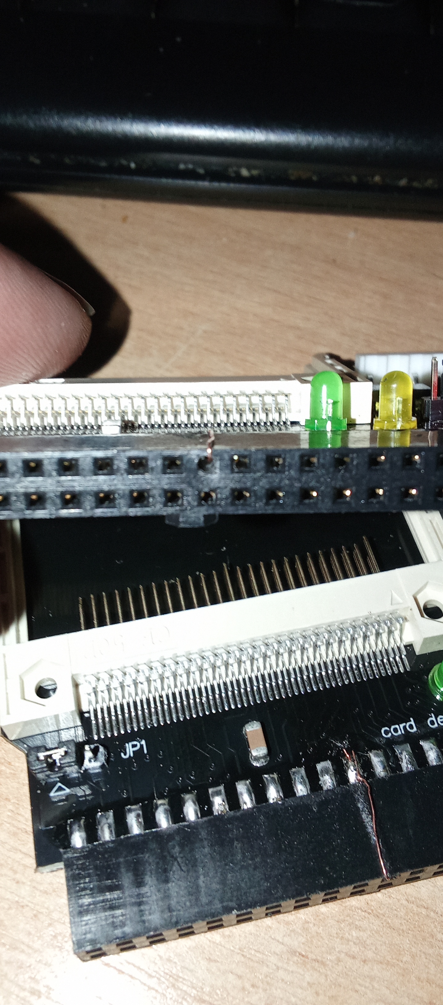

I’ve since found an image online showing an adapter plugged directly into the Qubide, rather than on an ide cable like mine, so, as mine can’t plug directly in due to 1 of the 40 holes being blocked, I’ve ordered what looks like an identical adapter to the one in the image, should arrive tomorrow so will see how I get on with that

I've hand-drilled the blocked hole out in the past to make them fit.

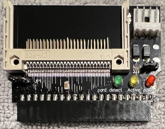

Well that was a waste of time, the CF that arrived was identical to the one I had
Can’t be bothered to send it back to Amazon given the price
I just cut the notch out so I could fit it directly to the Qubide and it doesn’t work connected directly either
Not risking buying another though so will have to use PSU (at least until I can find another source)
