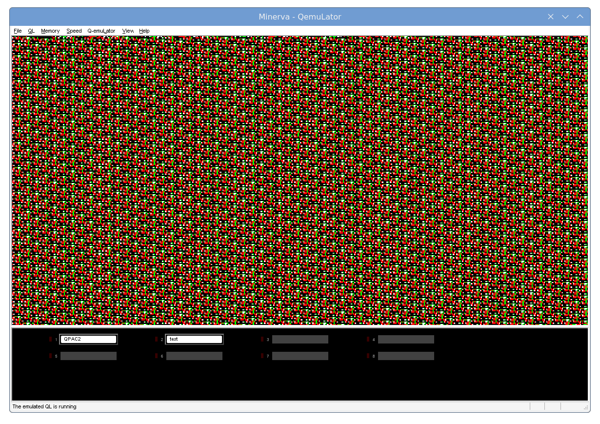

QDOS home thing

desin wrote: Sun Jan 19, 2025 1:23 pm QDOS home thing
Greetings from Switzerland
Markus
Yeah, the Qdos version seems buggy. Pity. I hope it can be fixed.
