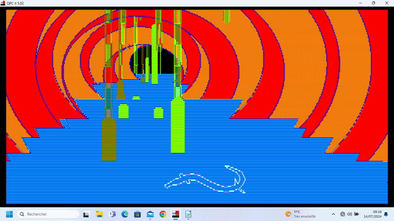

You can overlay transparent shapes by filling them around their Outsides, leaving the underlying background unchanged. This is like drawing your own 'borders', quite easy with rectangles, but fussier to achieve with circles, as you have to fill outside ARCs. (I used the latter technique to produce the Cave2_bas design), see below. Steve.
Yes, it all depends on your exact needs in the program.

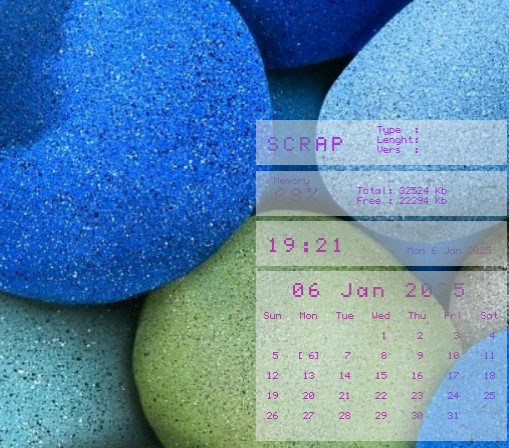

Re: Transparent windows
The kind of transparency I was thinking of was part of the Black Phoenix distribution as Follows:-
I think the answer to my question lies in the posts found above. I will try pjw's code later on.Re: Transparent windows

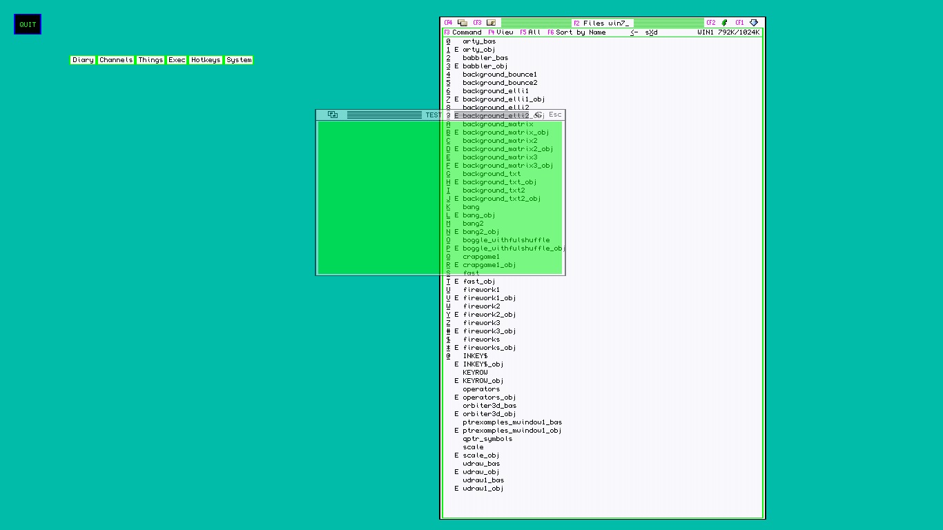

Or like this.
What I would like to do is to have the program permanently transparent.
I have tried pjw's code but it does not ,as yet, produce the effect I want.
I have cheated here because I have achieved the effect I want, by screen shooting the window whilst moving it.What I would like to do is to have the program permanently transparent.

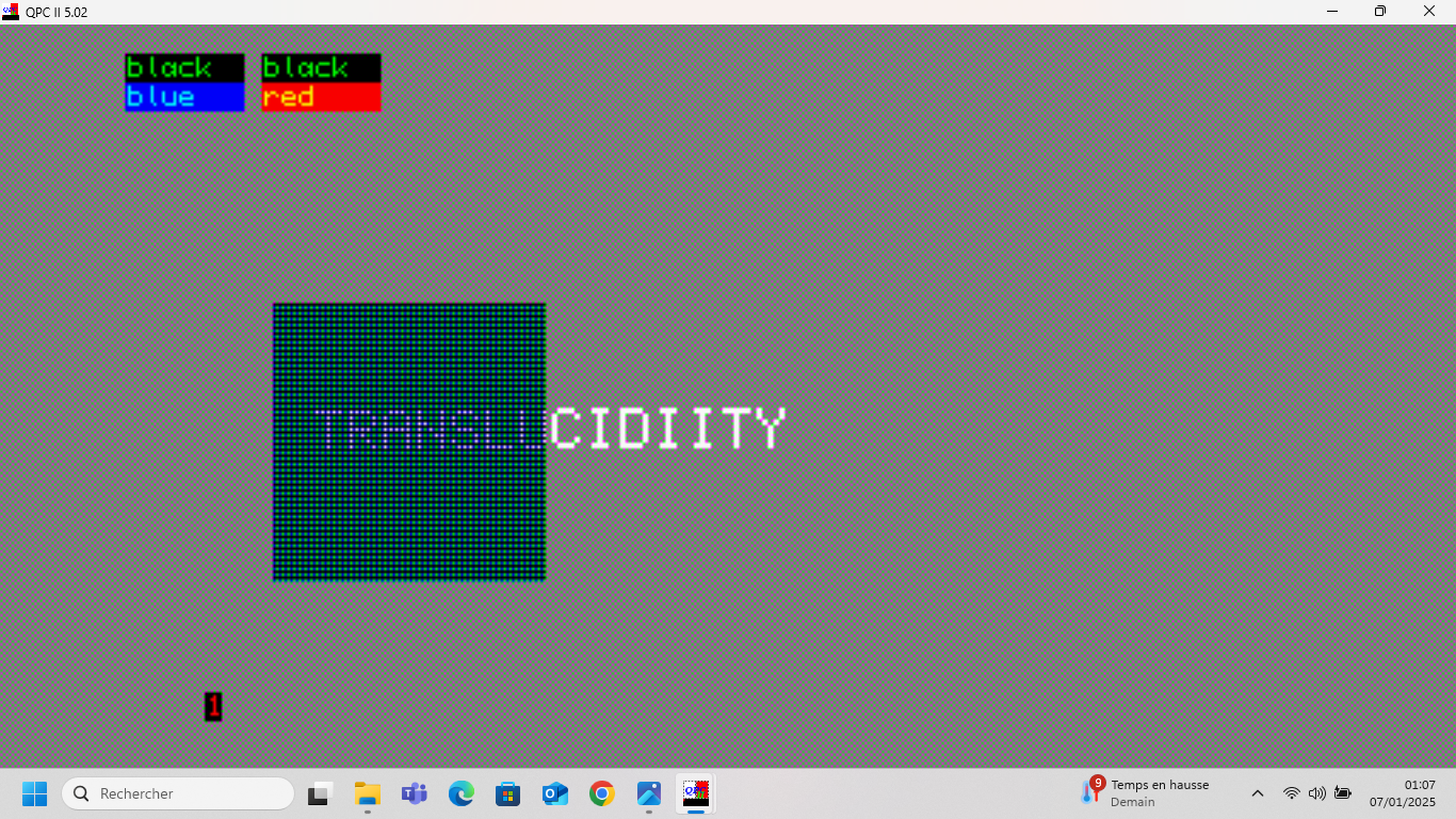

Hi Tinyfpga,
The examples you show are not so much transparent, as translucid. You also seem to have been using a very high definition screen ?
To achieve a translucid effect, one would need to develop new sorts of colour stipples, (using Over 1 ?).
Normally, stipples are combinations of colours, (including black), but for your needs, some colour 'bits' would have to be not shown. This can be done, but requires 'texture fills', such as that of TALENT, for both paper and ink..... and the output is slow, unless written ,say, in C.
I might have a try over the next few days, but only in SMSQ/E and SBasic. - Steve.
- Aurora
- Posts: 908
Hi again,
Here is the example of translucidity achieved in SBasic... by not using the red stipple colour. Steve.
(Using 512x256 screen in QPC2).
