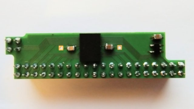

I just played with a little new project, a fast RAM extension for the Qzero:
It plugs onto the Qzero's 40-pin GPIO header and 4 pins of the video header.
There are certainly better ways to attach RAM to an FPGA, but I had no time for a Qzero redesign.

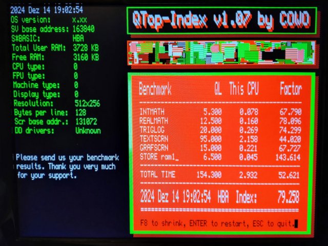

I don't have a Q40 ready to run Q-Top Index, but since it was frequently referenced in this forum, here is the Qzero+SRAM result:
If someone has a Q40 at hand, please try and post the result. I attach a QLWA container for convenience. LRESPR thorst_bin before executing the benchmark. And don't forgat to activate copyback cache.
