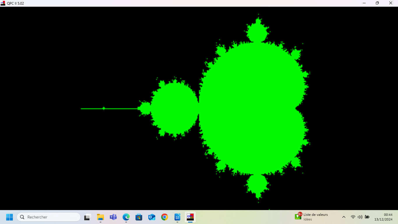

Hi Folks,
Fascinated at the thought that IA could write QL Code, I asked COPILOT for a Mandelbrot.
And this is the reply :
100 WINDOW #1, 512, 256 : PAPER #1,0 : INK #1, 3 : CLS #1 110 FOR y= -128 TO 127 120 FOR x= -256 TO 255 130 LET a= x / 128 140 LET b= y / 128 150 LET ca= a 160 LET cb= b 170 LET i= 0 180 DO WHILE i < 50 AND (a*a + b*b) <= 4 190 LET t= a*a - b*b + ca 200 LET b= 2*a*b + cb 210 LET a= t 220 LET i= i+1 230 LOOP 240 IF (a*a + b*b) <= 4 THEN PLOT x+256, y+128 250 NEXT x 260 NEXT
Not useable a such, but with a little transformation, this is the output on QPC2 : Steve.
