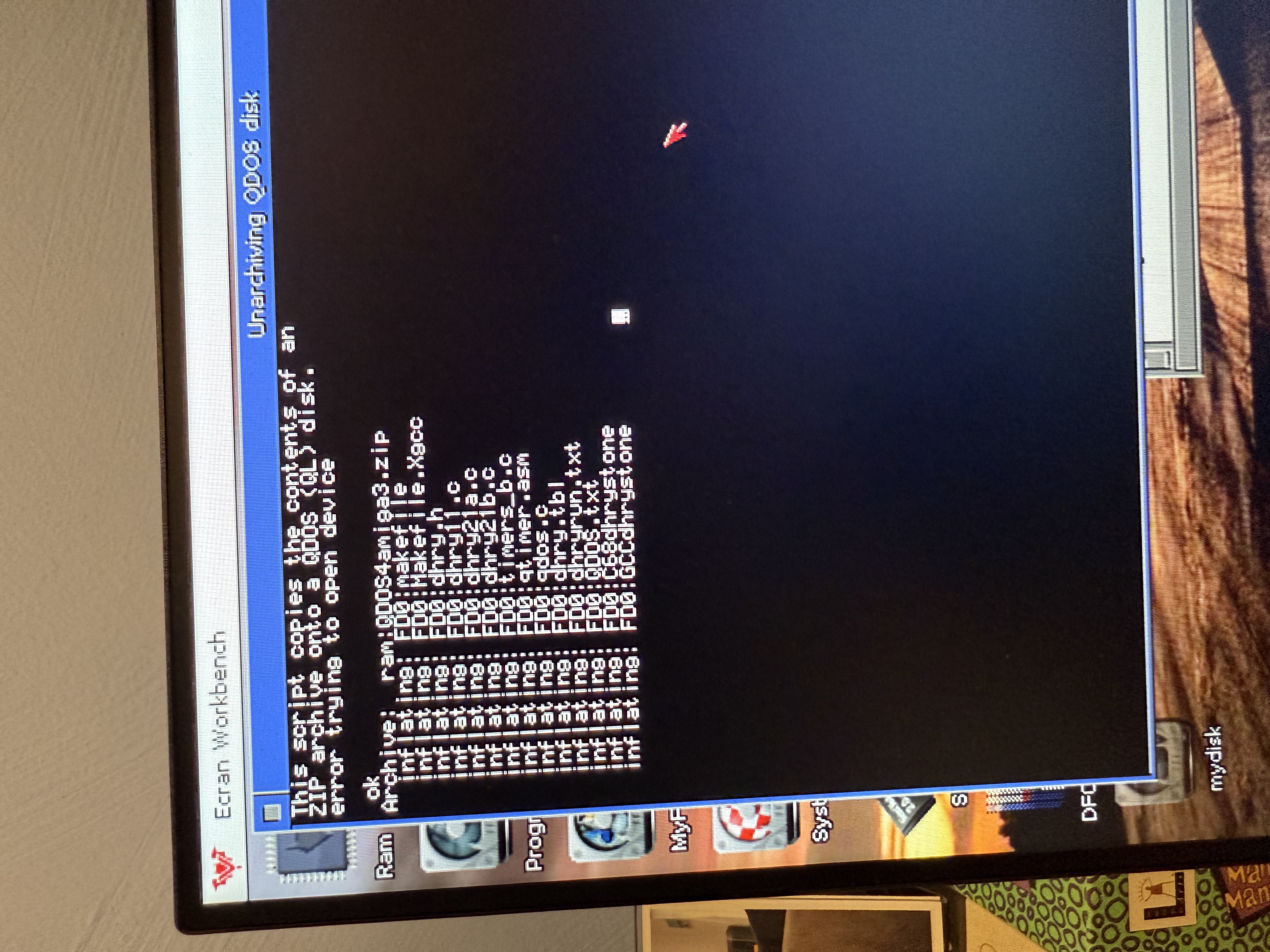

- use the transfert program in the QDOS4amiga package to write the content of the support disk on a floppy readable by the QL
- boot the floppy disk

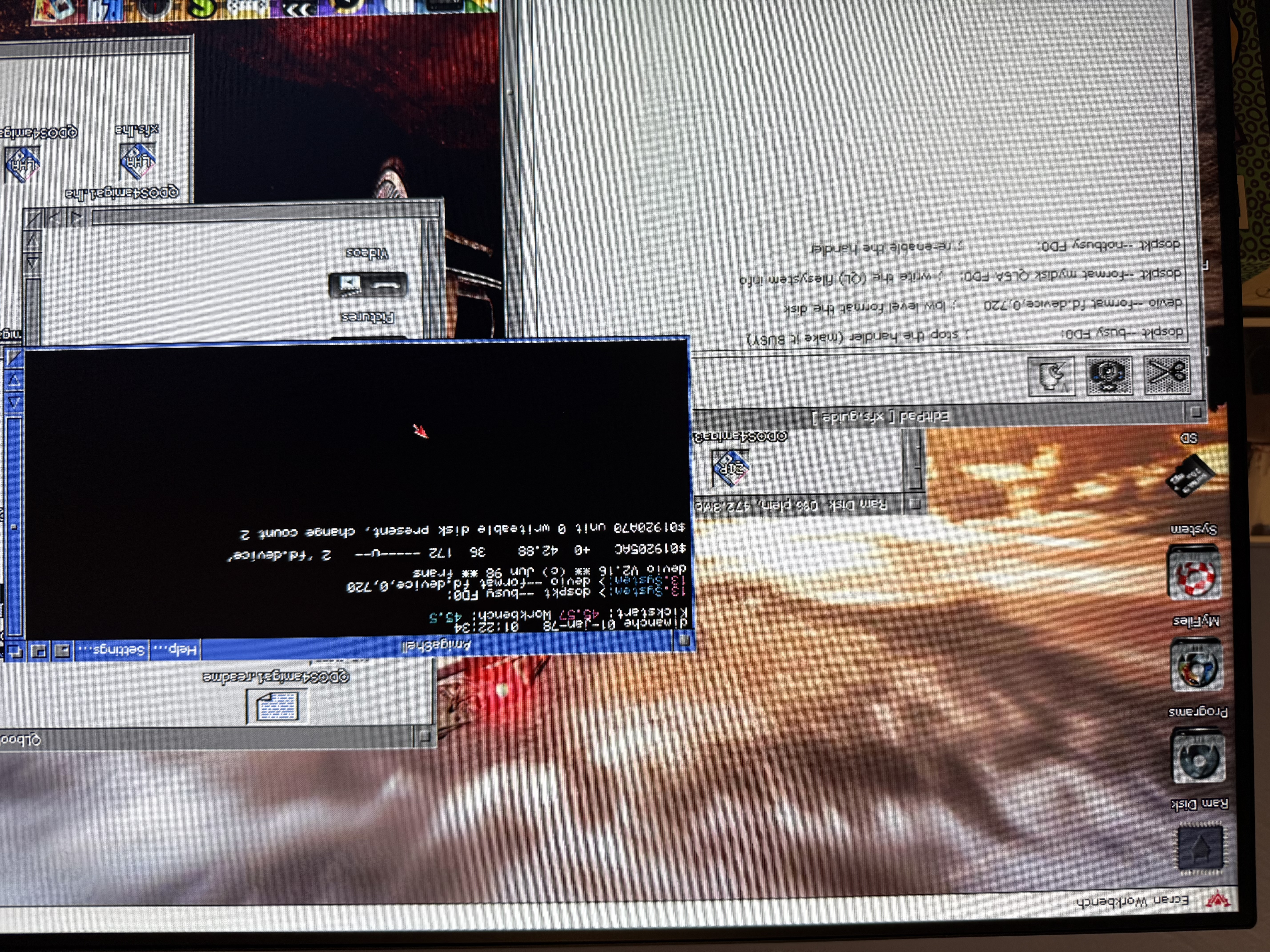

- create a second floppy disk on the Amiga side with some provided commands by xfs

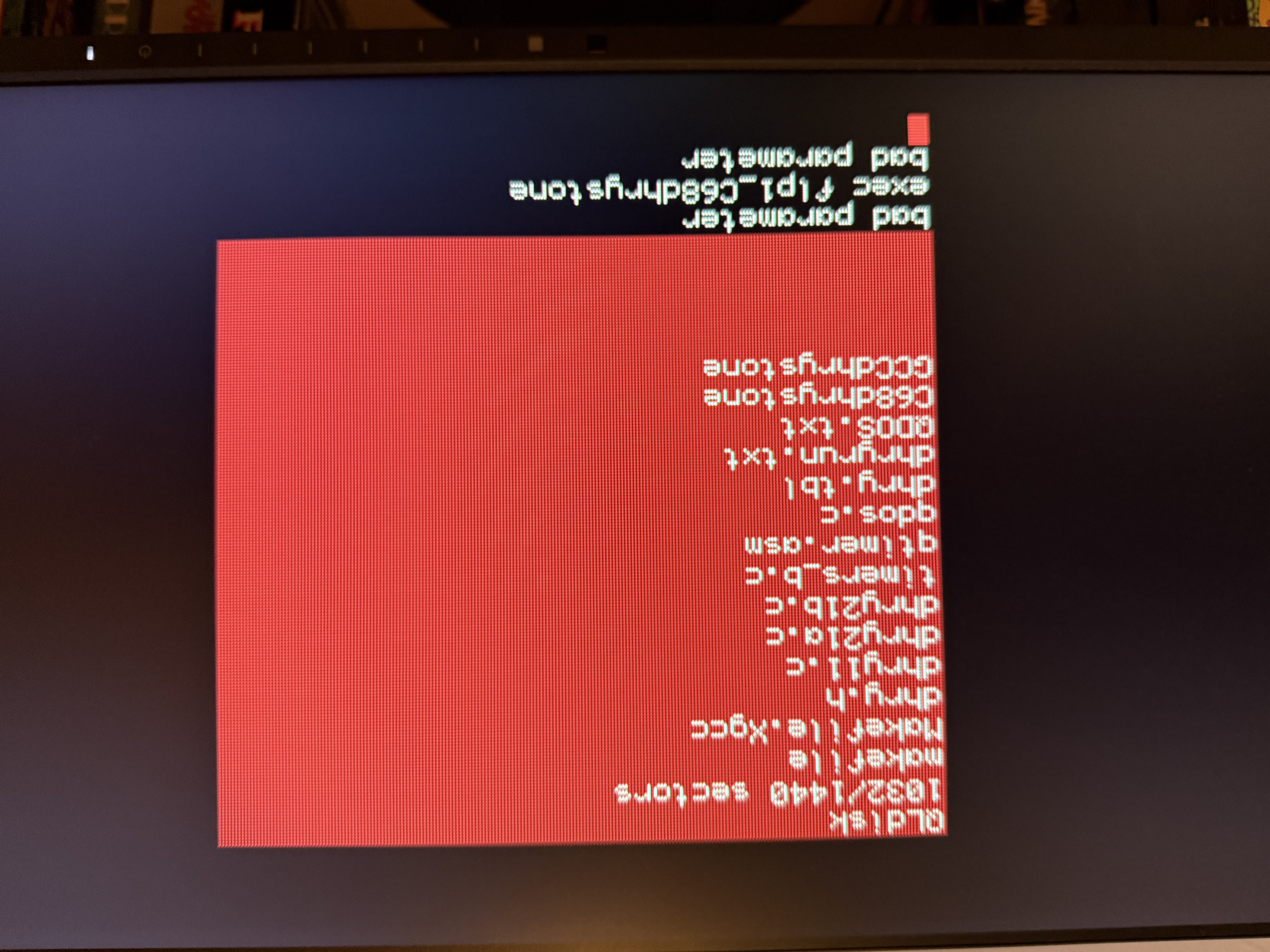

Now, I try to launch the C68dhrystone program from this disk. I tried lrun flp1_c68dhrystone, but this is not this.
then I tried EXEC flp1_c68dhrystone, it's a no too:
What is the right command to type to execute it?

The bad parameter could be because the unzip was not done on the QL side - non QL unzip will kill the all essential lead part of the executable file - and you get the bad parameter error

Thanks for attempting to test and for opening a specific topic. At first you need the QL-side unzip program itself to have the right executable header.
So this doesn't become a chicken-and-egg problem, here is a self-extracting binary that you can start without executing:
https://dilwyn.theqlforum.com/arch/unzip541xq.bin
You can LRESPR this file and follow the on-screen prompts.

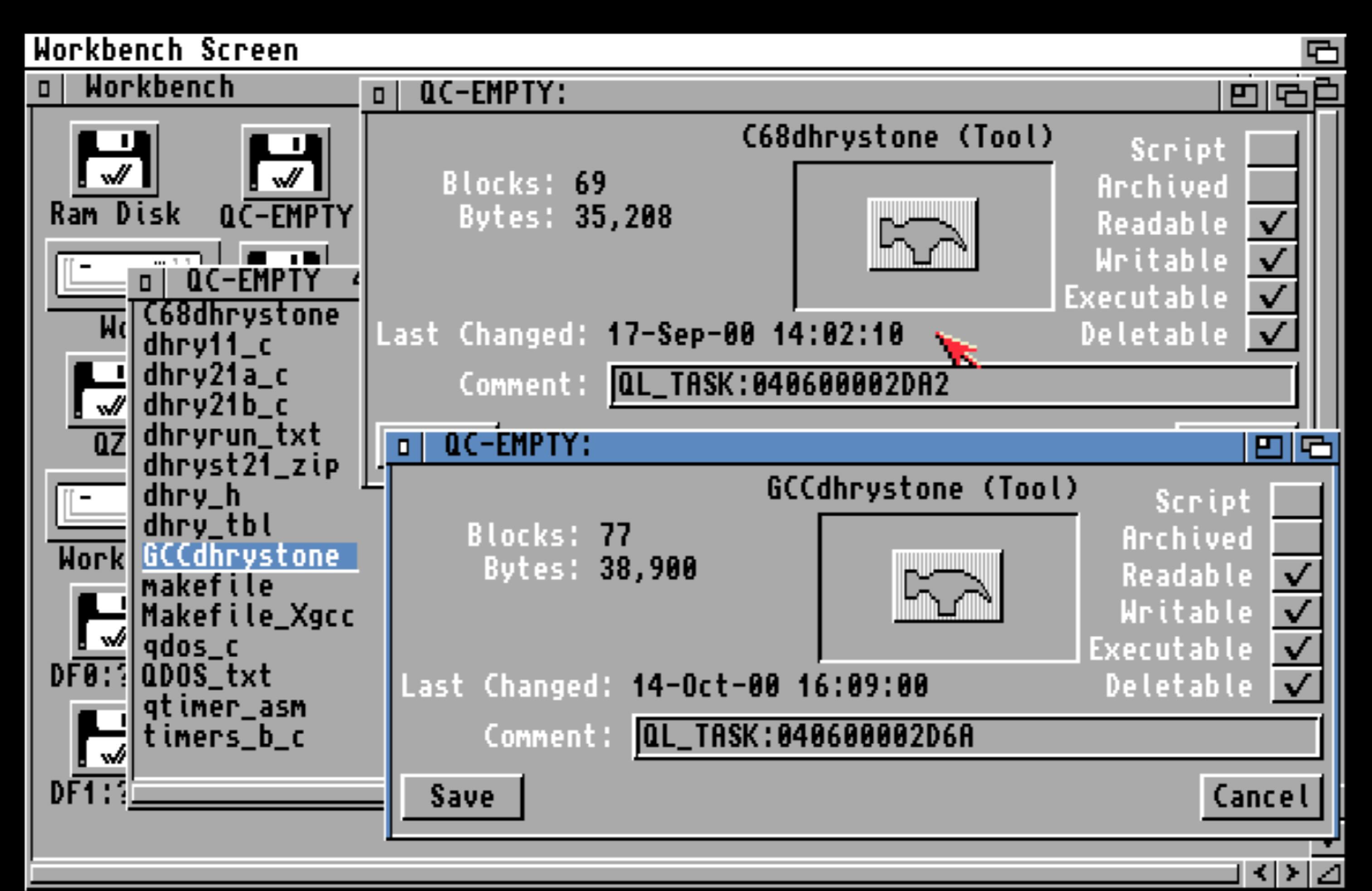

As you can see XFS presents QL executable info as a filenote beginning with "QL_TASK:"
The boot disk creator makes use of this to preserves QL executable info via file notes in the LHA archive.
It made sense to store filesystem extended attributes in a file note, as these can be easily preserved by archive programs from system to system.
Unfortunately standard QL zip archives don't represent QL executable info this way.
So you need to unzip a standard QL zip archive from within QDOS itself rather than on any other system.
