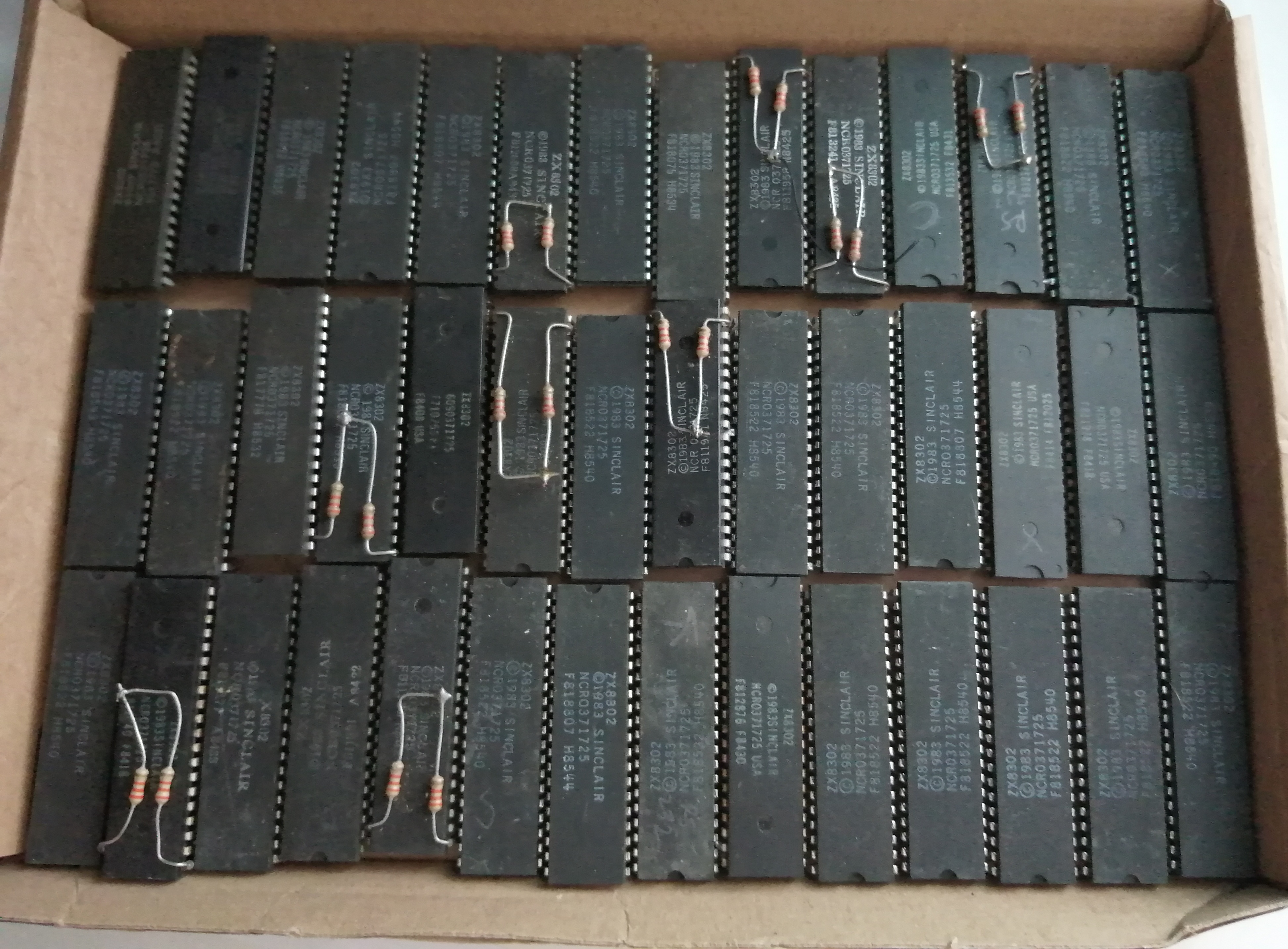

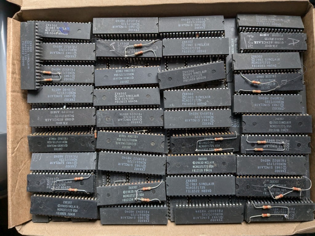

This is just the top layer of the ZX8302s - not as much variation in these as with the ZX8301s but there are two layers.
Many have the two resistor mod
Has anyone ever discussed what that mod does - I know it was in the service manual - but what does it actually do?
A bunch of ZX8302s
