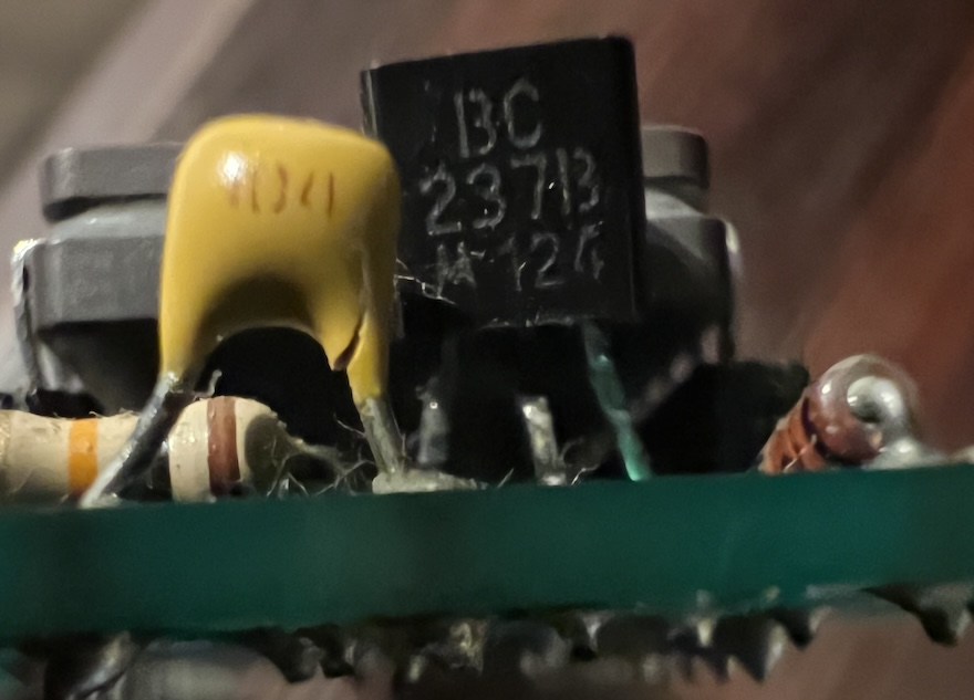

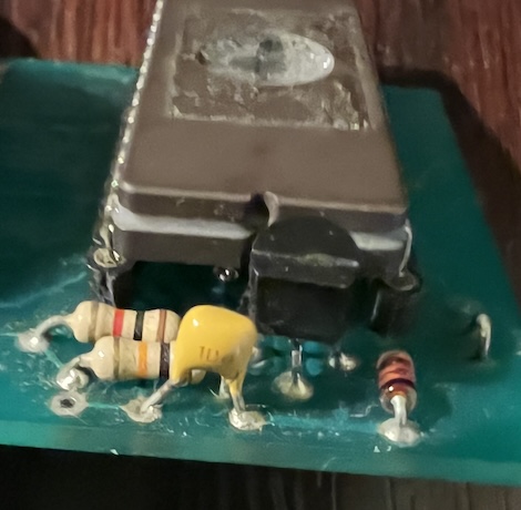

As I wasn't able to get any bare ROM Port boards to make my own, I've purchased a few for re-purposing
But one of them is a bit strange because, unlike all the others, it doesn't have (what I assume) is a logic chip, just an eprom
Does this board look safe to use in the QL please?

I spy a transistor on there. Probably switches the /OE on the ROM if a certain address line goes high or low.

stephen_usher wrote: Tue Jul 02, 2024 10:41 am I spy a transistor on there. Probably switches the /OE on the ROM if a certain address line goes high or low.
Yes, it has a transistor. Is there any particular implication in what you describe please?
I hadn't noticed the crack on the capacitor. Probably best to not use?

Looks like a decoupling cap so don't worry about it.
It'll be safe to use.
