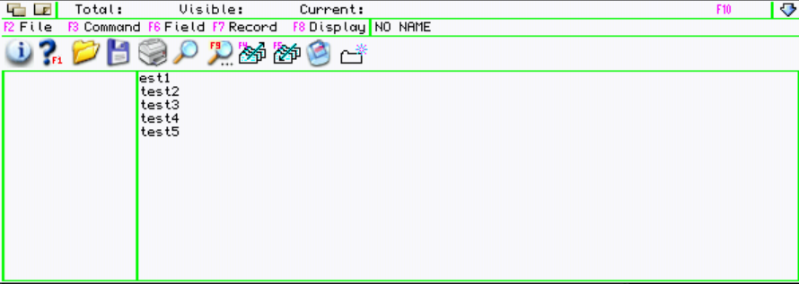

Hi.

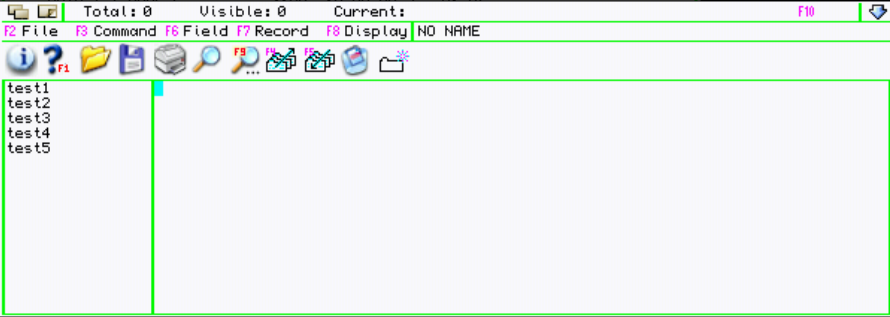

I'm not able to create a new DB file with DATADESIGN.
I'm able to load an existing file, but I'm not able to create a new one.
What is the correct procedure in order to create a new DB file?
Thanks in advace.
Regards
M.

Hello

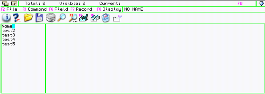

you to input some fieldnames first
press F5
they become real fields
you can edit them anytime
hope it helps

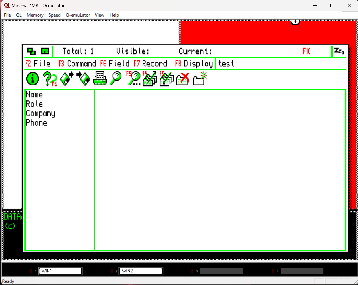

Thank you very much!
Now I'm able to create and use DB files ! :D

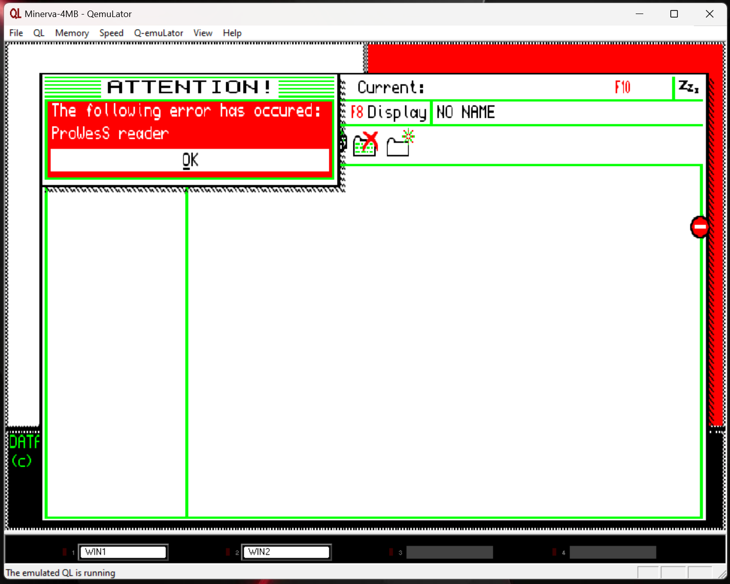

BTW, when I press HELP i receive the following error related to PROWESS ...
"ATTENTION: The following error has occurred: ProWesS reader".
Is it difficult to install the "reader" ?
(I'm using real QL GoldCard emulation with SMS/Q E 3.40, Lauchpad 2.14, Pointer Enviroment, ....).
Thanks in advance for your support.
M.

genetika wrote: Tue May 07, 2024 1:33 pm
As the latest Help for Datadesign is done in simple html you will need a full ProWesS install to use the Reader.
The PWS Boot file may need expanding. Then run the Config programs for ProWesS and ProForma.
Alternatively you could maybe use a PC browser to read it, copy the files to a DOS device first
It's probably also a lot faster to navigate the text.
