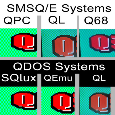

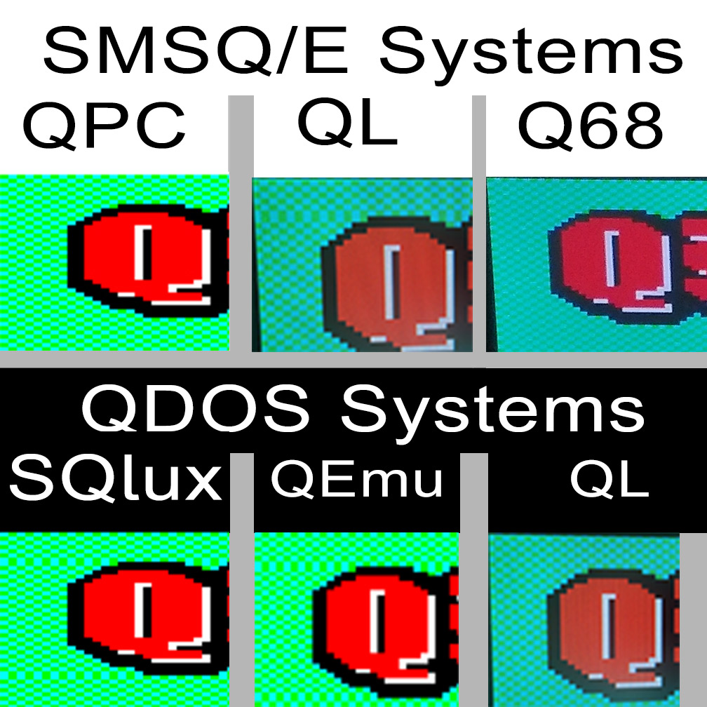

It seems that SMSQ/E is not defining the colour correctly.
The color is defined as colour, contrast, stipple - in this example (see attached image) the background colour is defined as PAPER 5,4,3
It seems that SMSQ/E is reversing the colour and contrast, so on SMSQ/E systems the paper is actually 4,5,3!!
Look at the top left pixel - on SMSQ/E is Green, on QDOS is cyan
This issue is visible when running QSTAR on the same real QL in QDOS and then in SMSQ/E
This makes loading perfectly aligned images on a stippled background impossible on both SMSQ/E and QDOS!

Yes, I see the swapped colour effect in all stipple patterns.
I played with all stipple patterns in QEmulator, QPC, QL +QDOS and QL+SMSQE - took pictures of the screen output and zoomed in Photoshop. In SMSQE all stipple colours are reversed compared to QDOS.

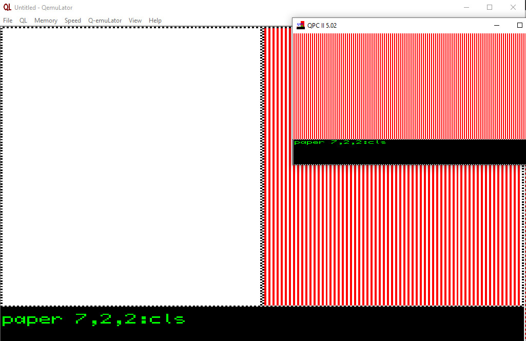

The issue is much easier to spot when using stipple=2 (vertical bars)
