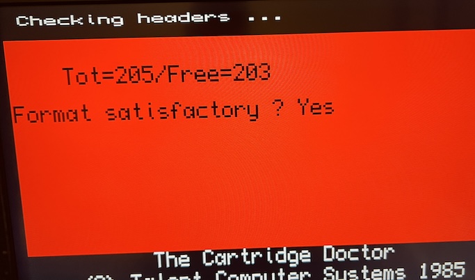

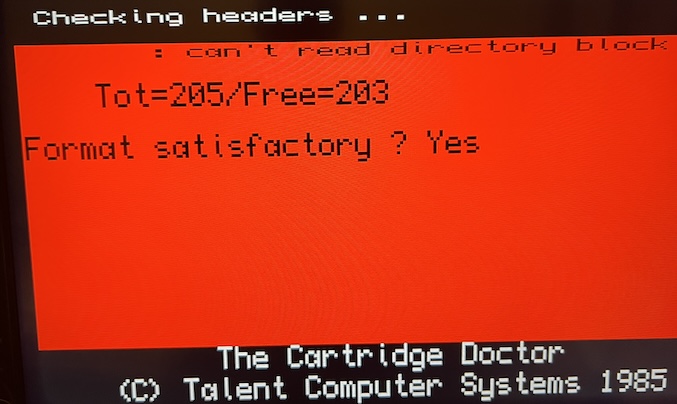

When I run it, it formats the destination ok but then never tries to access the source cart (whether it's source/destination = mdv1/mdv2 or mdv2/mdv1)
After the format it displays "Checking Headers" followed by "can't read directory block" though, as I say, it doesn't even attempt to read any MDV after the format (the source MDV's I've tried are all known good carts, as I'm just testing)
My QL has Trump 1, QIMSI & vMap/vDrive and I've tried it without Trump/QIMSI and it always fails the same way (maybe vMap is interfering?)

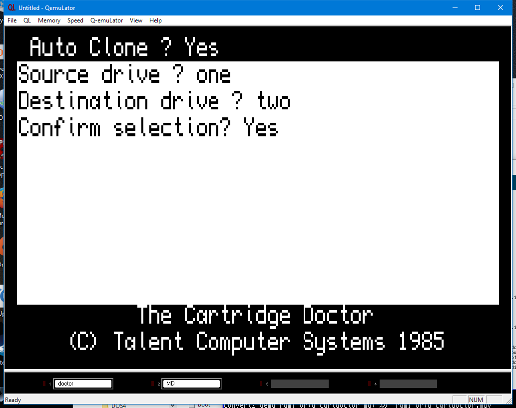

It's all a bit complicated, but hopefully this explains everything
Firstly, I've never used CD before, so am just trying to see what it can do so am just trying to do Auto Clone
I have 4 versions:
Original MDV - completely corrupt (cannot even DIR)
A protected (so same as original) MDV image - works in that I can get it to load
An unprotected Floppy IMG - works in that I can get it to load
An MDV backup - won't load but a good copy (it can't find an original as part of protection scheme)
The manual says if you run from a copy you need the original in MDV2, but it never tries to access MDV2 and just hangs

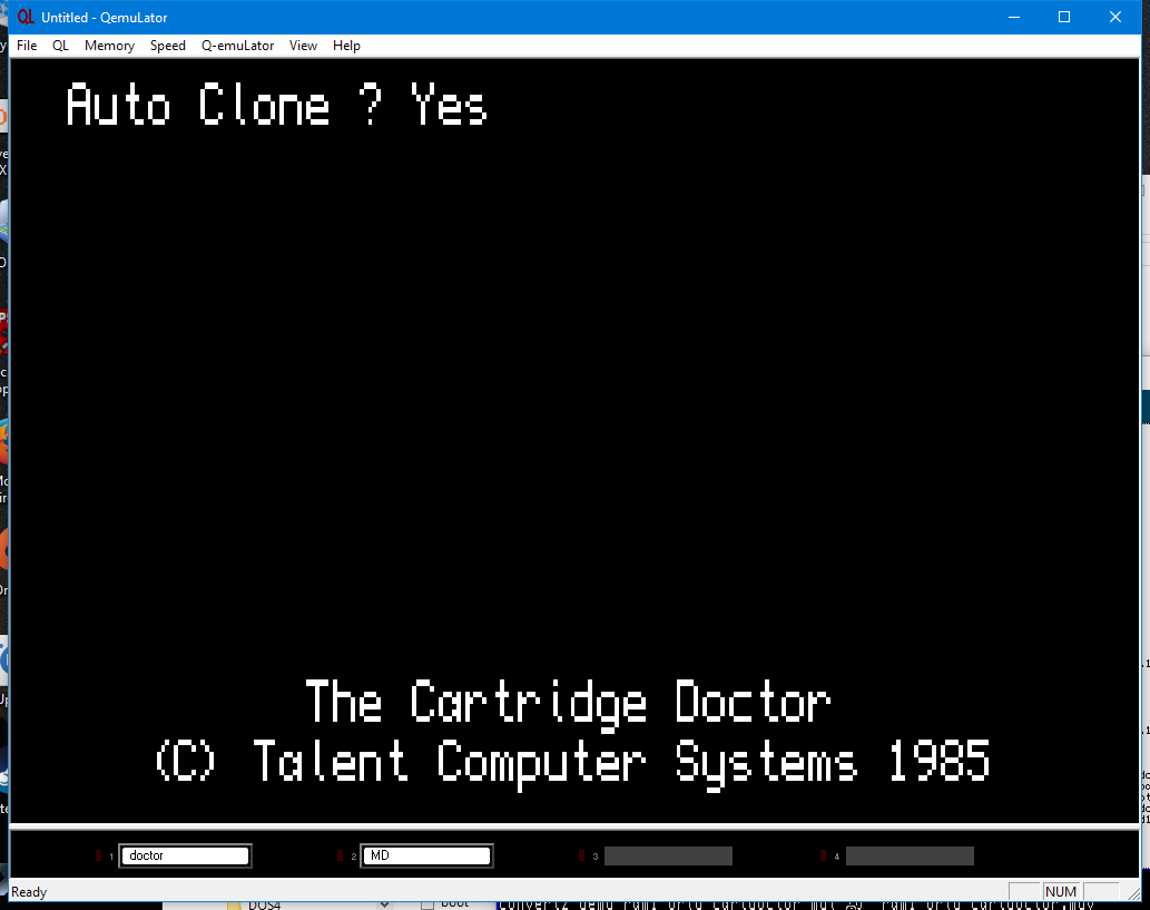

Using the Mdv image or the Floppy image I can load the program but as per my original post it never tries to access the source MDV (have tried all sorts of combinations but always get the errors in the images)
It WILL run properly in Q-emuLator ironically
Tony

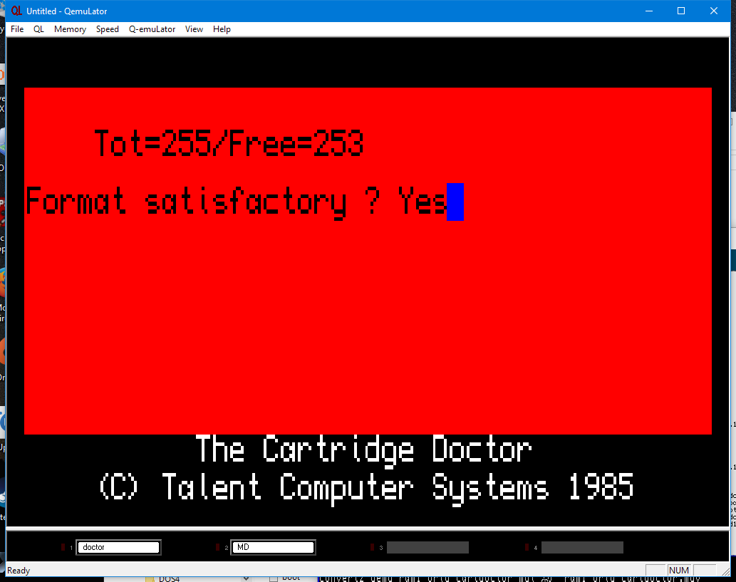

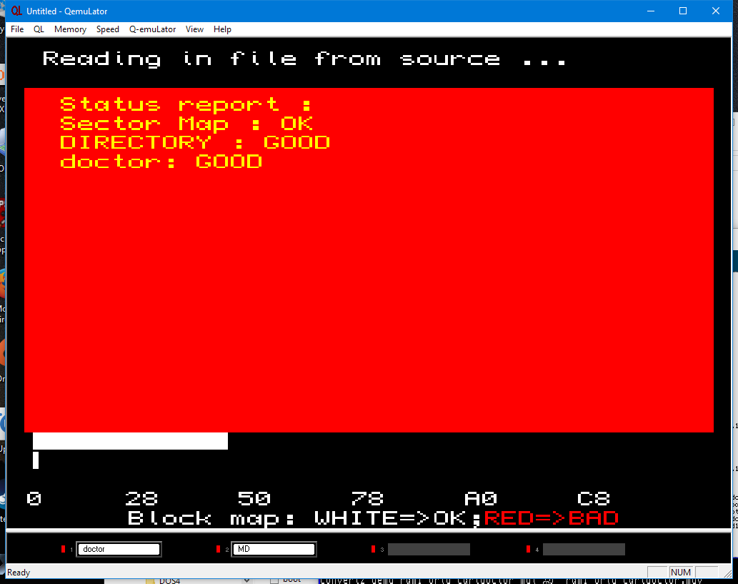

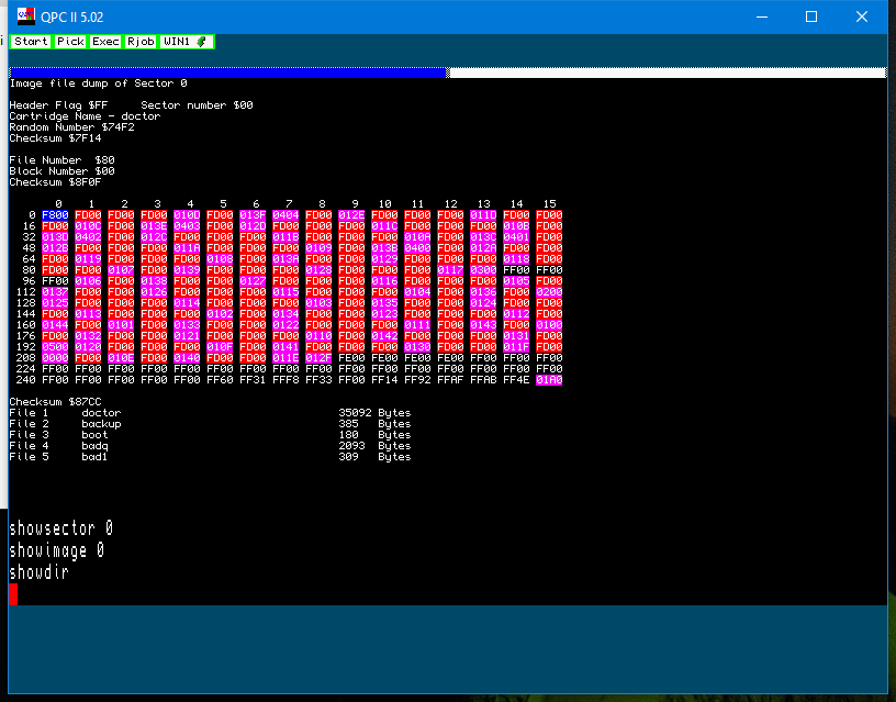

I've just been having look and a play in Qemulator. I must be misremembering the bit about the map.
Mine in Qemulator does not seem to bother about the master cartridge being there
Note that the 255 sectors is because I'm using an image file I created that has 255 sectors I noticed that all the drive lights are on. Could this be upsetting your vMap, thinking all the drives are running at the same time.
Which I think should not normally happen. This is a dump of the map and directory from my image file
