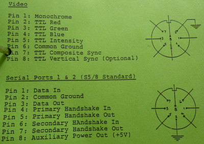

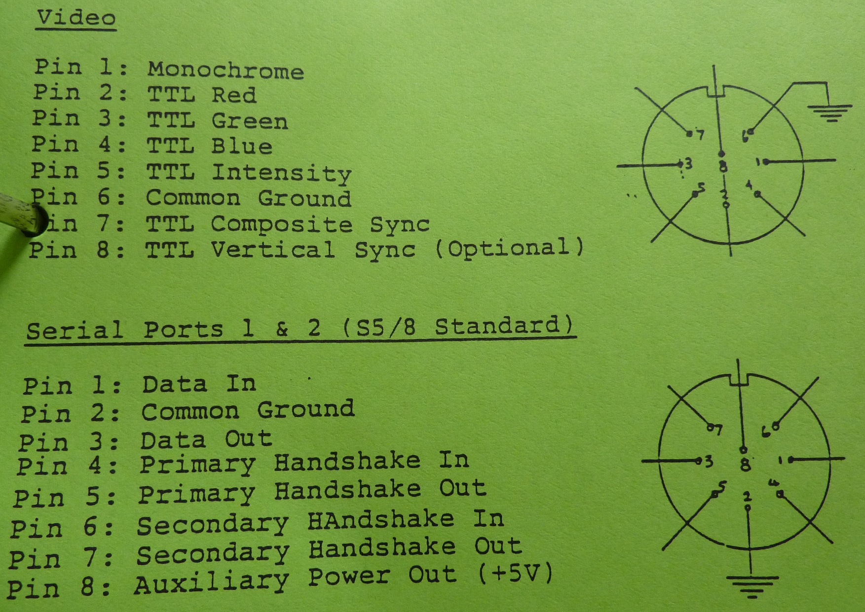

I'm on the "run", but had a quick look on my server and found this:martyn_hill wrote: Sun Apr 14, 2024 11:17 pm Just bumping this request for any info we might have about the Monitor pinout for the Thor XVI?

- Posts: 1128
Re: Thor XVI - Request for documentation...
Oh, brilliant!
Thank you, saves me messing about tracing each signal
If you happened to have any other technical or user documentation in the -16 and would be willing/able to share at some stage, I'd be very grateful!
