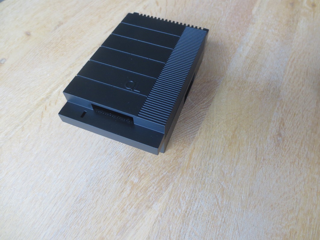

Does the design of the external microdrive enclosed not clash with the new case design?

Re: what is the difference between a ql microdrive and the spectrum version ?
Post by techy »
Hi Derek ,
the external mdv is for the classic ql , not the ql+
Posts: 4756
techy wrote: Wed Mar 06, 2024 10:57 am Hi Derek ,
Can you think about a QL+ version, might be a nice enhancement for Microdrive, vDrive, Oqtadrive.

unfortunately the ql+ with wafer-drive has not made it to production , nice idea tough.
looking for prototypes is FUN !!
A big thumbs UP for the people who make the 3d designs so more people can enjoy the ideas of sir clive.

Ok, so you want to attach a ZX MDV unit within the nice QL style external drive casing (I think that was originally designed for the vDrive.)
Makes sense.
The other point that becomes relevant is that the orientation of the MDV expansion bus is reversed between the QL and Interface-1, meaning that you would need to arrange for a longish MDV cable to feed out from the RHS of the QL, under/past the external drive and back in from the RHS of the external drive.
I've done something like this before (so that you can have the MDV slot actually facing you), but can't recall if you also need to swap top/bottom connections of the plug as well - I'll take another look and confirm later.
