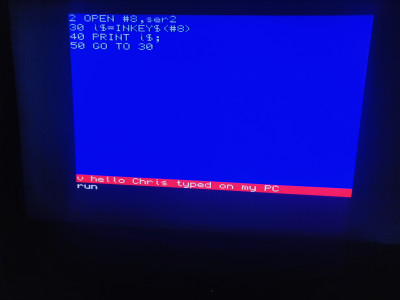

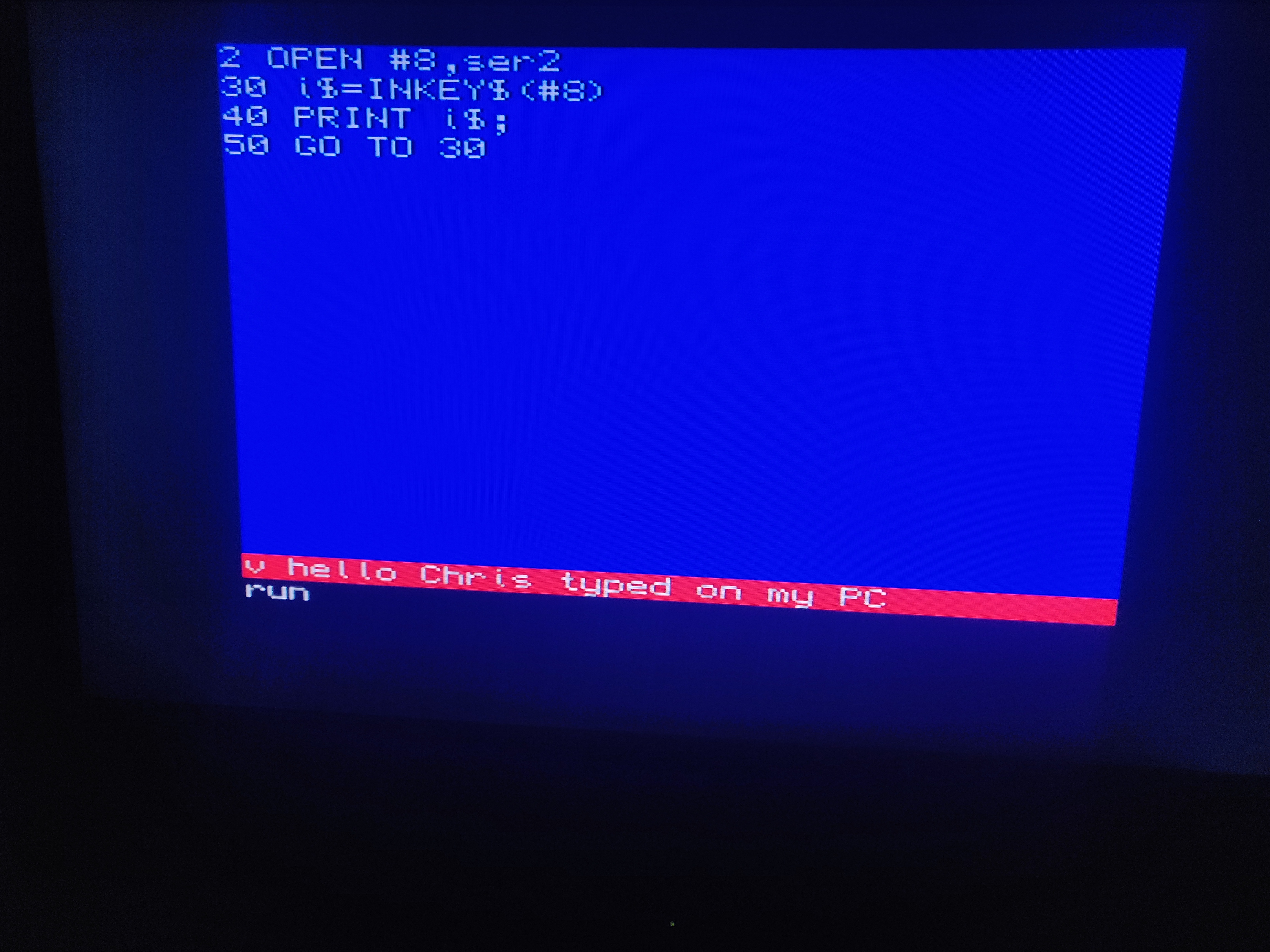

I made a serial cable - actually, I made this before I had a QL to use with the zx spectrum, but never even tested the cable. Happily the QL and spectrum seem to have the same requirements... Anyway, it worked!
Well, for this basic test. I'm wondering about using serial to send software to the QL. I do this with the z88, which works really well.
Wondering if the best thing to do is use QPC2 to unzip files and send them to the real QL?
Anyway, just pleased I got it working and didn't blow up my QL :D

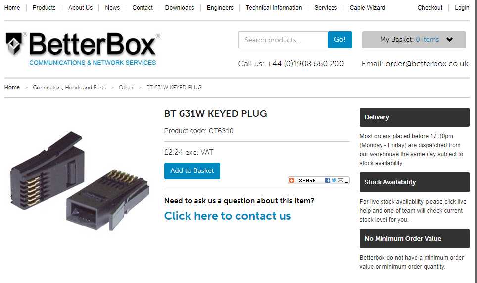

Where did you get the BT plugs?
I need some to develop some external devices for QL

The UK-style serial and joystick connectors (Type 630W for joysticks, 631W for serial ports – these are the keyed connectors which look a little bit like British Telecom phone connectors) try Betterbox.co.uk at https://www.betterbox.co.uk/products/bt ... t6310.html and https://www.betterbox.co.uk/products/bt-630w.html
BT631W plugs from betterbox

dilwyn wrote: Wed Feb 21, 2024 3:46 pm The UK-style serial and joystick connectors (Type 630W for joysticks, 631W for serial ports – these are the keyed connectors which look a little bit like British Telecom phone connectors) try Betterbox.co.uk at https://www.betterbox.co.uk/products/bt ... t6310.html and https://www.betterbox.co.uk/products/bt-630w.html
Nice, a need a couple to develop an interface for the QL Serial port.
Thank you

Popopo wrote: Wed Feb 21, 2024 12:46 pm Where did you get the BT plugs?
eBay has them, listed for QL

But be careful to get the 631W variant. The commonly available 631A (UK telephone) types have a different polarisation.
The Sinclair QL joystick ports accept a 630W plug
The Sinclair QL serial ports accept a 631W plug
The ZX Spectrum serial port accepts a 631W plug
The ZX spectrum keypad/aux port accepts a 631W plug
Some info on the different
https://zxnet.co.uk/spectrum/btconnectors/
and an article on my blog:
https://dilwyn2.wordpress.com/2020/09/0 ... ick-plugs/
