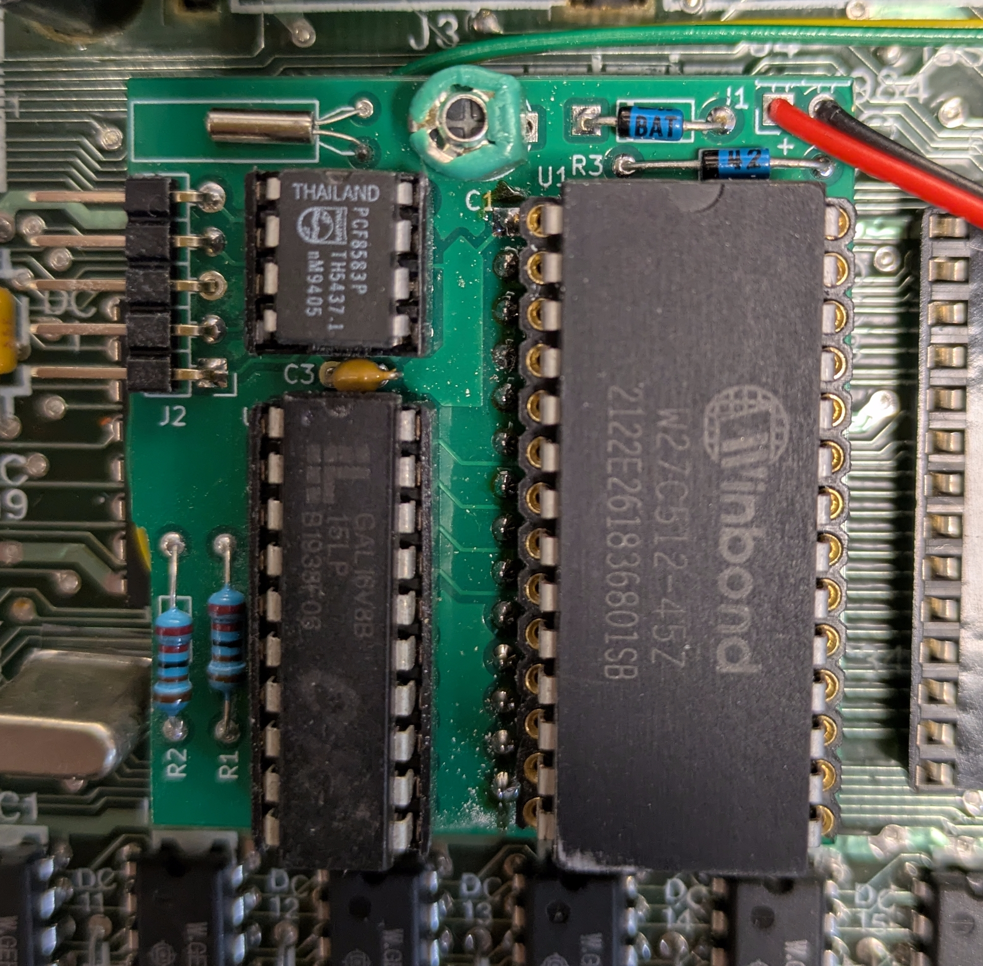

I asked a question on the QL Facebook group, if a remakeof the Minerva MK2 is worth doing.
I need to draw up the schematic and do a PCB layout, copy the PAL chips.
Would anyone like this ehancement to the QL available.

Is this to include the I2C components (clock and I2C output) ? If so could I suggest an I2C buffer chip be added ?

Just an idea at present, I have Stuart McKnight (Qview) if this is okay.
I have 2 interfaces thst need repairs, so I thought about making a coup,e for my other QLs.
I suppose anything is possible, wny do we need a I2C buffer?

The main reason would be to isolate the I2C SCL and SDA pins if these are taken out to the outside world - giving protection against mishaps.

Pr0f wrote: Tue Jan 23, 2024 10:24 pm The main reason would be to isolate the I2C SCL and SDA pins if these are taken out to the outside world - giving protection against mishaps.
Hi Prof,
There is not much space on the original PCB, but if I use SMD components, that should give enough space for the buffer chip.

The goal of the remake is to initially make a new Minerva MKII for other QLs I have, to have Minerva ROM, Crash proof RTC, I2C interface.
Since I like to do outsource projects, noting some be hidden or closed.
