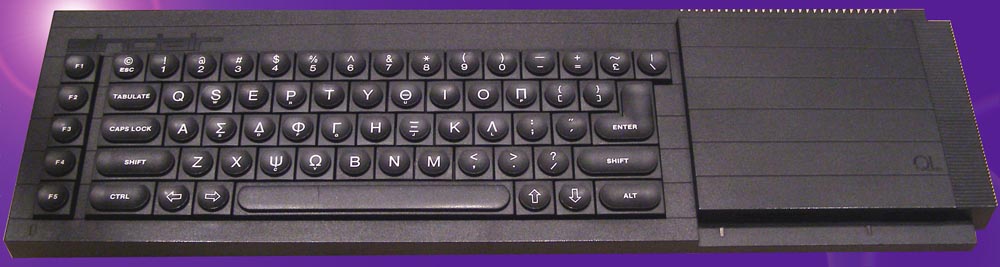

Re: Minerva Keyboard Drivers
Hi to all!
Below is a Greek QL keyboard layoyt! On the keys, the tiny little letters(it's hard to recognise them) below the greek characters, are the english characters.
I will give a try to make a greek translation table!
