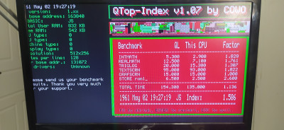

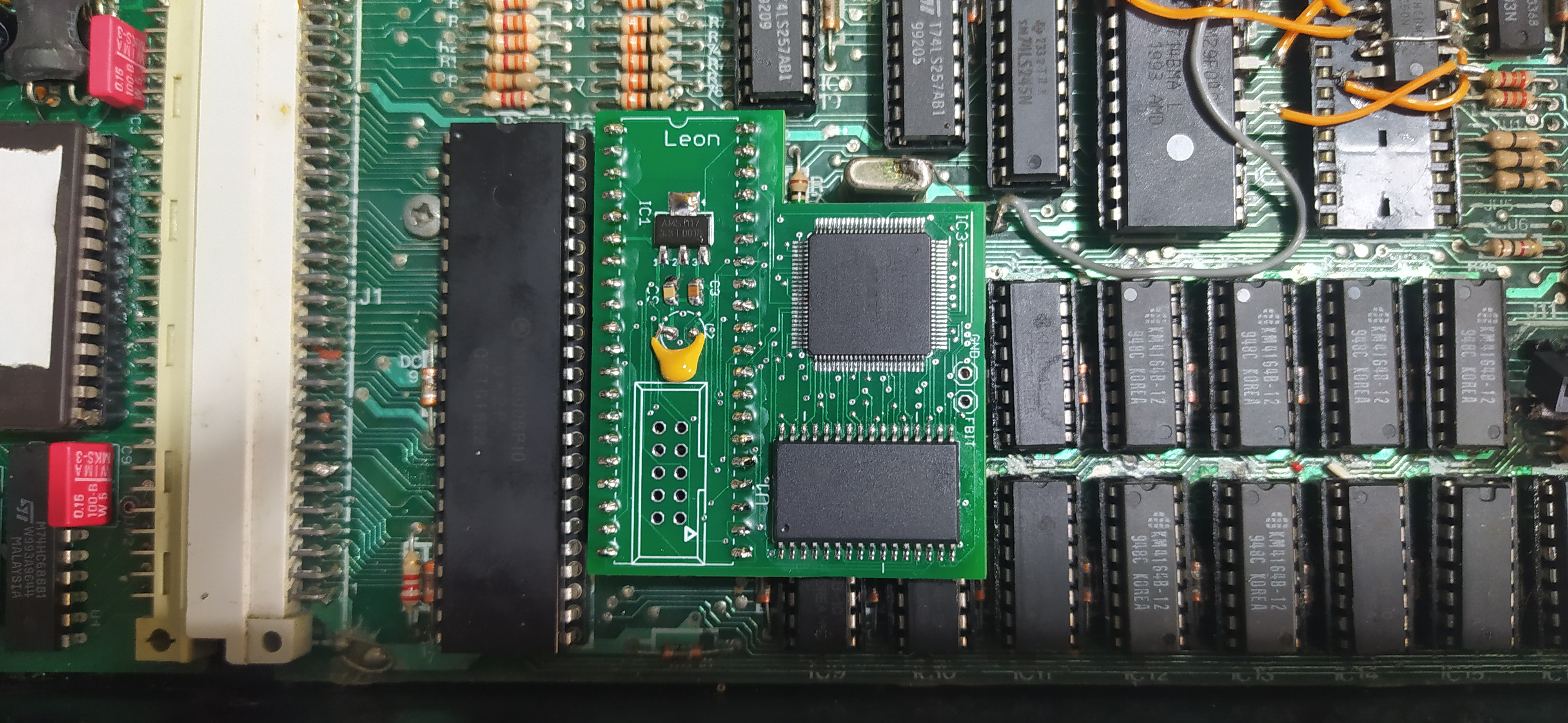

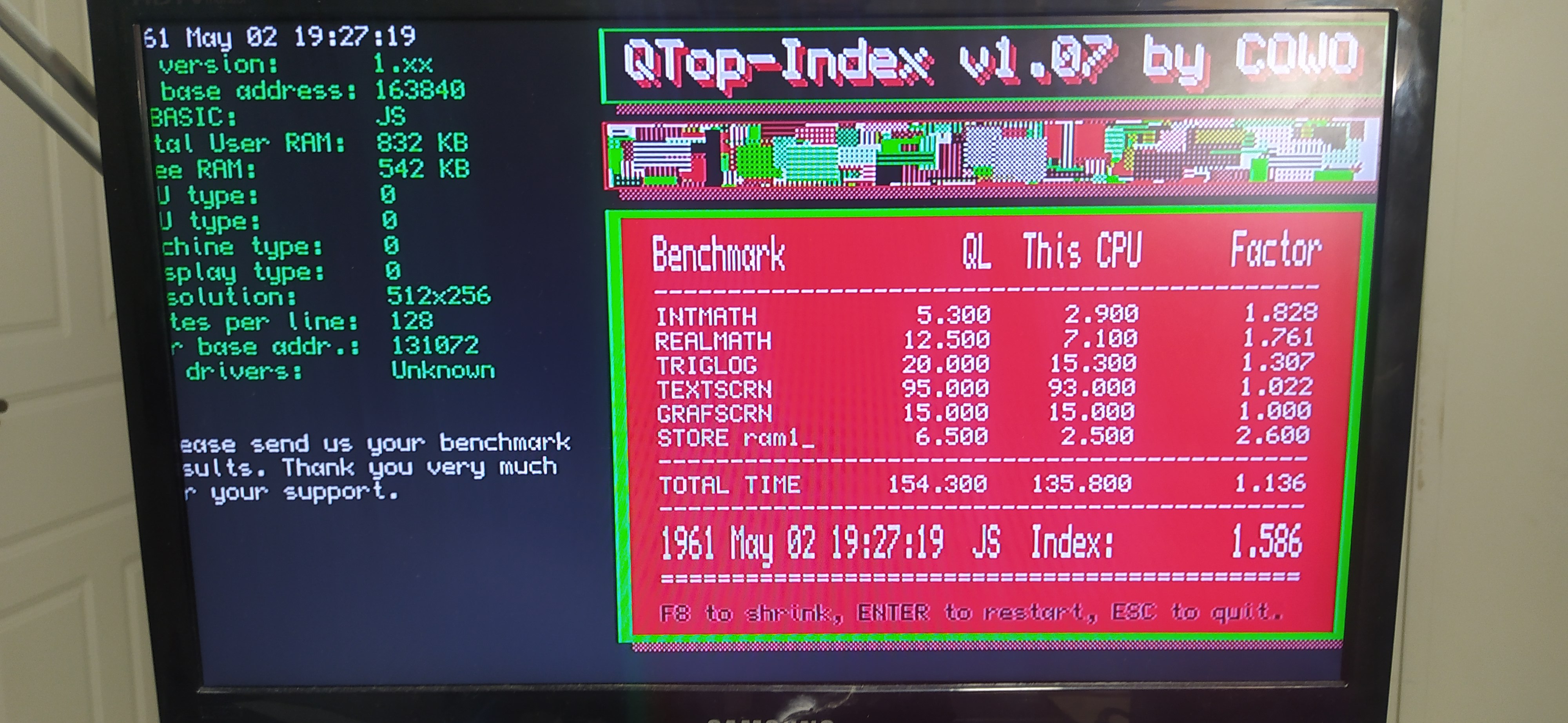

I built the first new compact pcb ula basic replacement and it seems ok but I'll test it more.
This is how it measures with my qubide clone ram (https://hackaday.io/project/183490-qubi ... ade-for-ql )
I think the original with the qubide ram measures about 1.3 so at 1.586 it's just a little faster but not fast enough to cause problems with games so I'll leave the optimizations on.

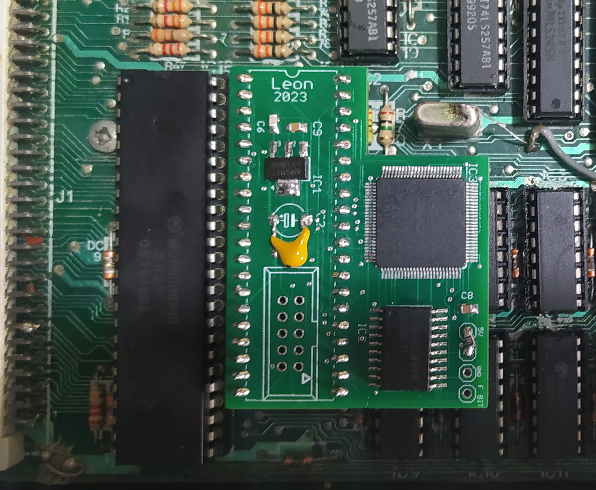

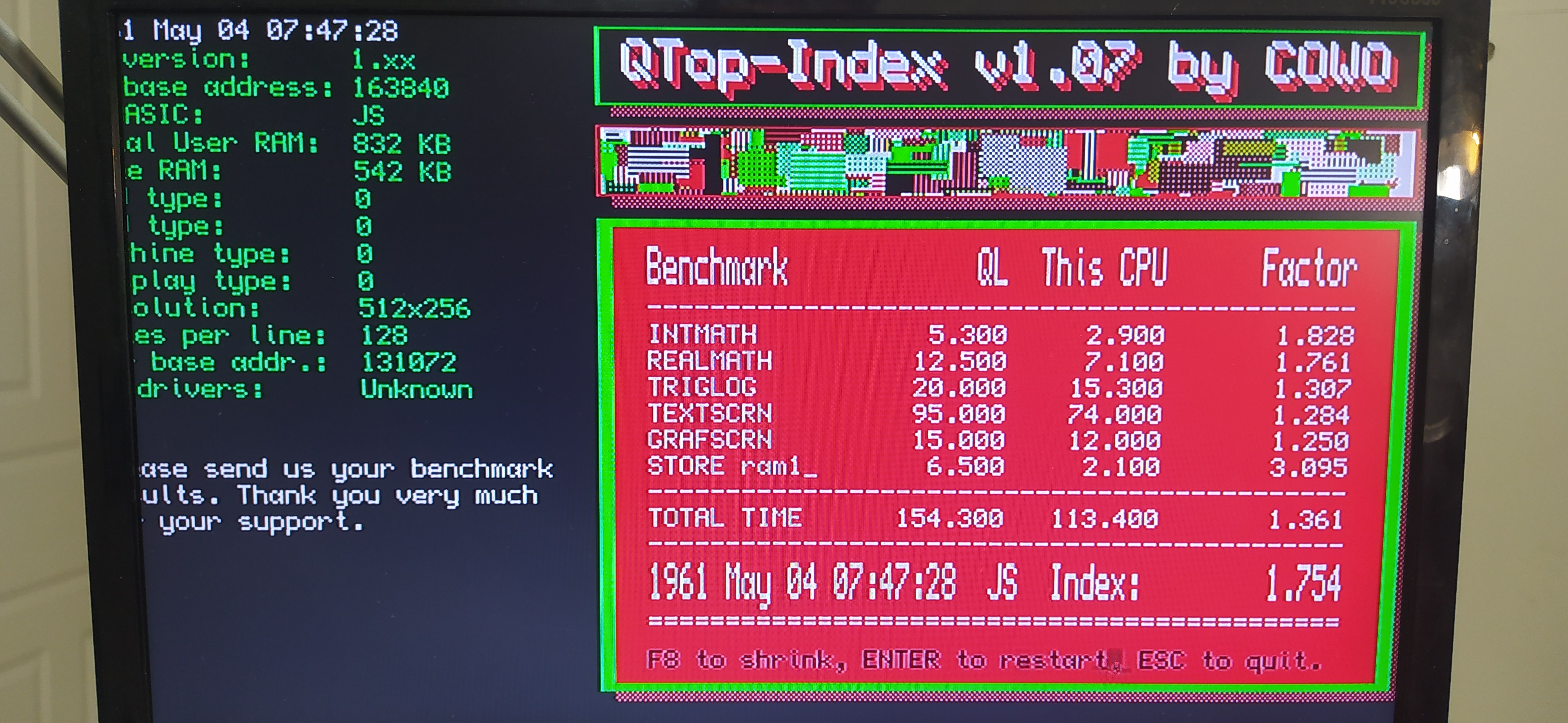

This is the second compact ULA board that has 128K static ram that replaces the on board dynamic ram.
Because it replaces the ram it has a faster low memory access, this also means faster graphics. It measures 1.754

It is possible but needs some simple extra circuit. This is the basic ula replacement pcb.
I'll also try to make a profile for the rgb2hdmi adapter I have used for other retro machines.
