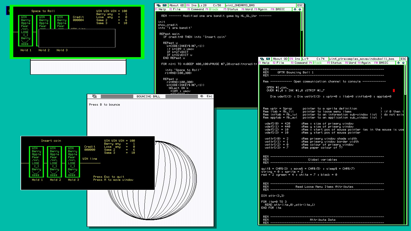

Like you I have been spending a bit of time learning to program in SBASIC. My original interest was in SMS2.
SMS2 has a high resolution QPTR SBASIC programming environment built into it, (see forum post SMSQ/2 on Atari page 8)
and I still use this form of programming in SMS2 and SMSQ/E. I have experimented with QPTR and have started to
understand it a bit.
I like your one arm bandit program but it does not run correctly in my QPTR system and, in a high resolution environment, it needs
to be moveable. By single stepping through your bandit code I found the problem was that PAUSE needs to be associated
with a channel otherwise it opens a default channel that overwrites the display. (see below). I added a WMOV instruction on line 13
and elsewhere to make your program moveable and assigned #7 to all the PAUSE instructions. The problem and its solution can be seen
in the picture below.
As to QPTR programming I have attached a zip file with some QPTR code that creates a moveable, but not resizable, window.
The code is a work in progress and it does not use line numbers GOTOs, PEEKS or POKEs. It compiles without error with Qliberator and runs
perfectly on QPC2 and Q68. I have not tried to interpret the code because I don't use the interpreter.
I have just noticed that instead of the word console I have typed consule by mistake but as it is a REM it's not very important.
My code and your modified code is in a zipped SMS container file as follows.
WIN5.zip
(484.62 KiB) Downloaded 112 times
