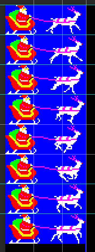

Thank you for the reply. I'm specifically curious about how the sprites in this Christmas card were created:
The BASIC code loads _spr files for both Santa's sleigh and the present and uses a Turbo Toolkit call of MOVE_MEMORY to move the sprite. Both are using more than 4 colors. How were these created?
100 MODE 4: PAPER 0:INK 4: CLS
110 INPUT 'Device: '; d$
120 IF d$='' THEN
130   dev$='win1_dev_santa_'
140  ELSE
150   dev$=d$
160 END IF

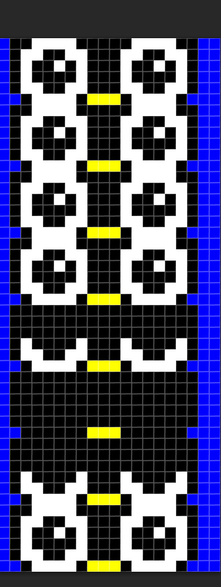

Posts: 1047
Re: Sprites on QL
bwinkel67 wrote: Sat Dec 09, 2023 8:22 am
I simply used Photoshop to create the sprite sheet, saved is as a RAW file that uses QL mode 8 pallette, then converted it in QL screen format.
There is a sprite sheet for the owl's blink and one for Santa. The gift box is just an image (only one frame).
Keep in mind that my sprites are NOT the same sprites as used by PE environment.
