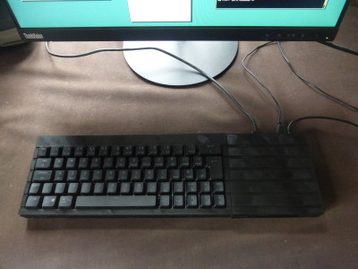

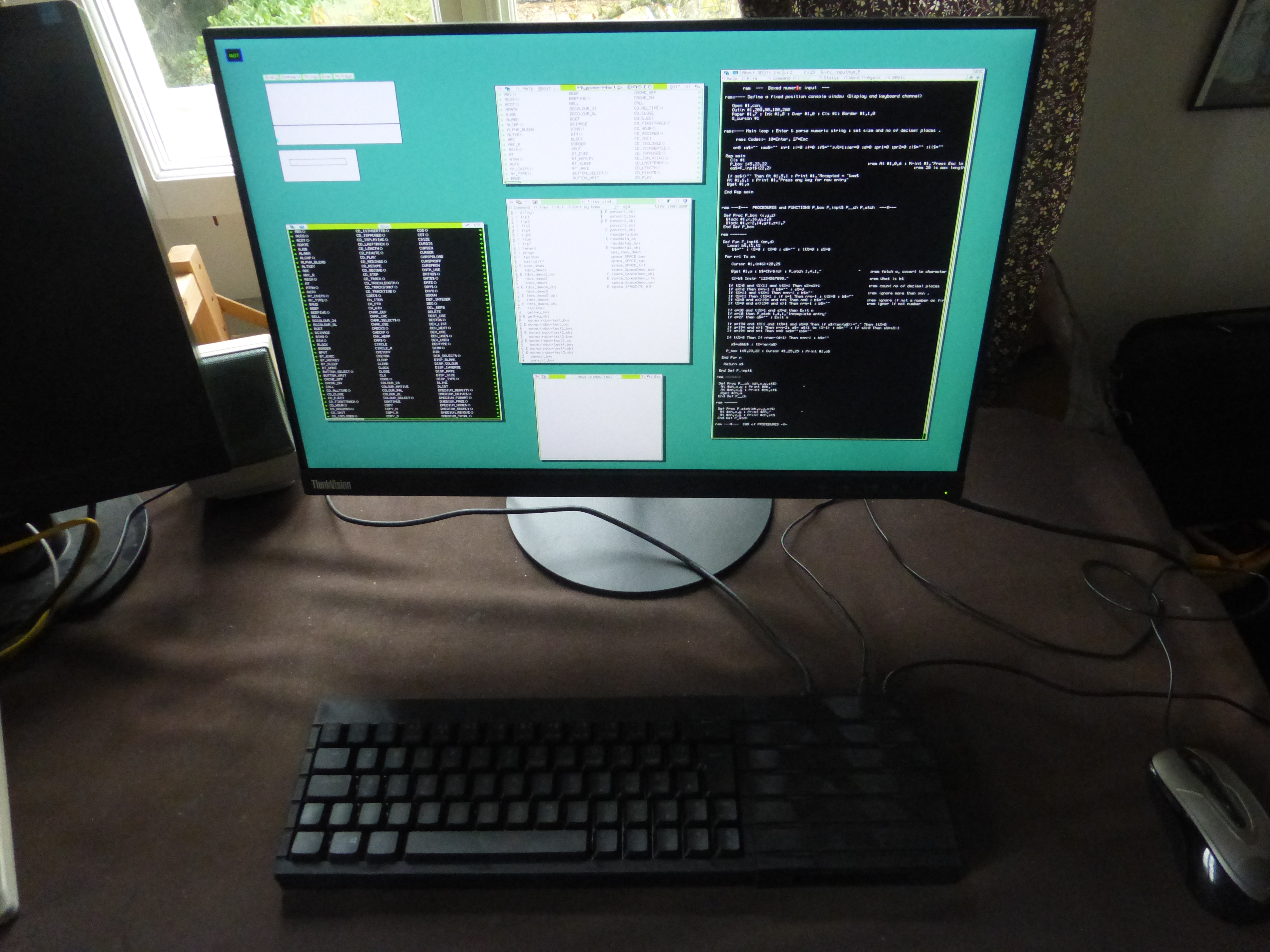

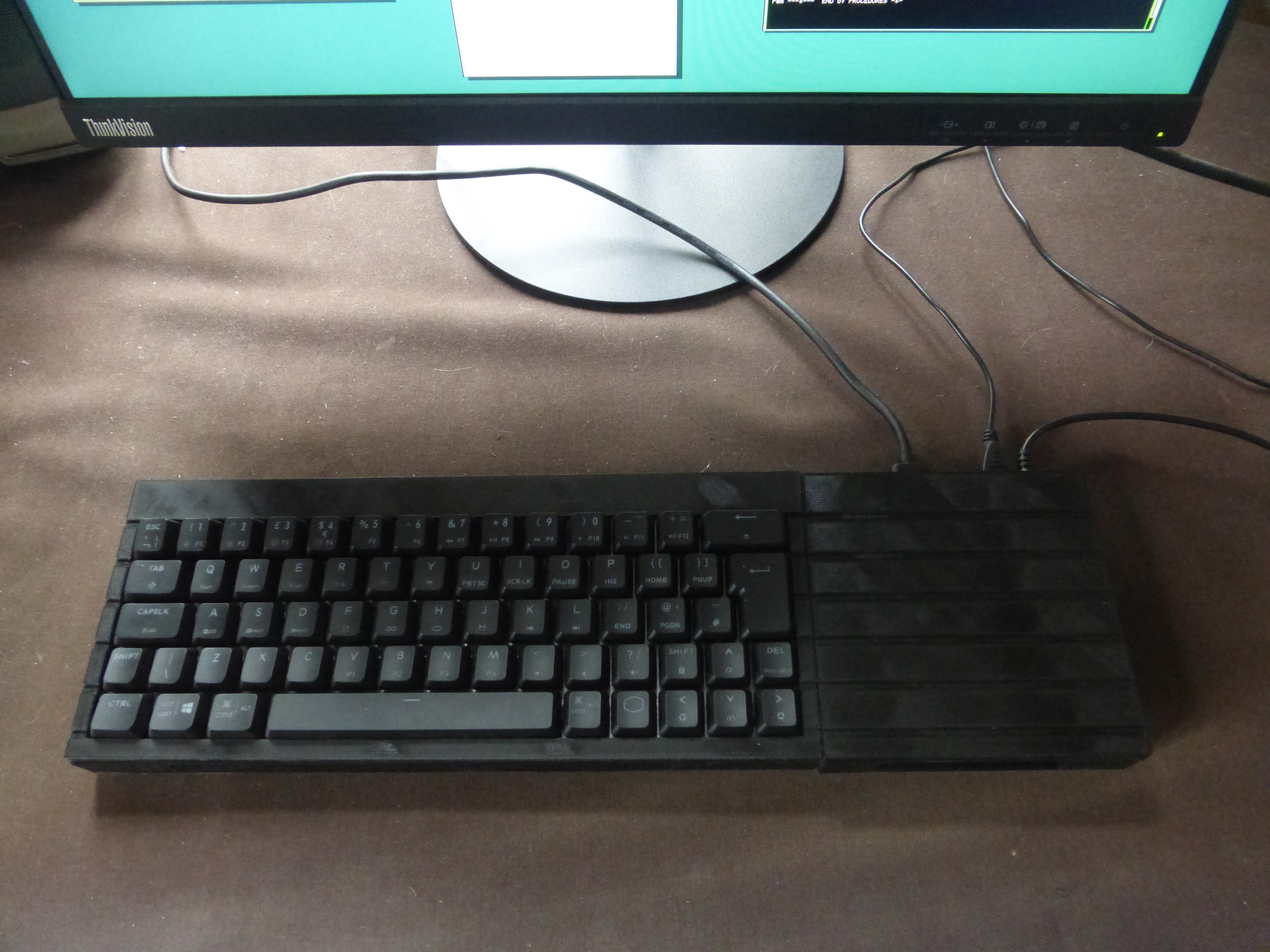

I was an SMS2 enthusiast but knowing that its roots lie in the demise of the QL, and as a homage to the Sinclair design, I decided to amuse myself by printing a Quasi QL.. The QQL consists of a micro pc and wired USB keyboard running SMSQE at a display resolution of 1920*1200.
The user interface is taken from my SMS2 startup file and its associated applications.
Most SMS2 applications run in SMSQE, but QL applications that bypass QDOS, and BASIC programs written to be interpreted, do not run in SMS2 and are thus not used in my QQL setup.
The goal was to make a machine that had the look of a QL but cost less than buying a real one.QQL cost me less than 200 CHF (£182) to make.

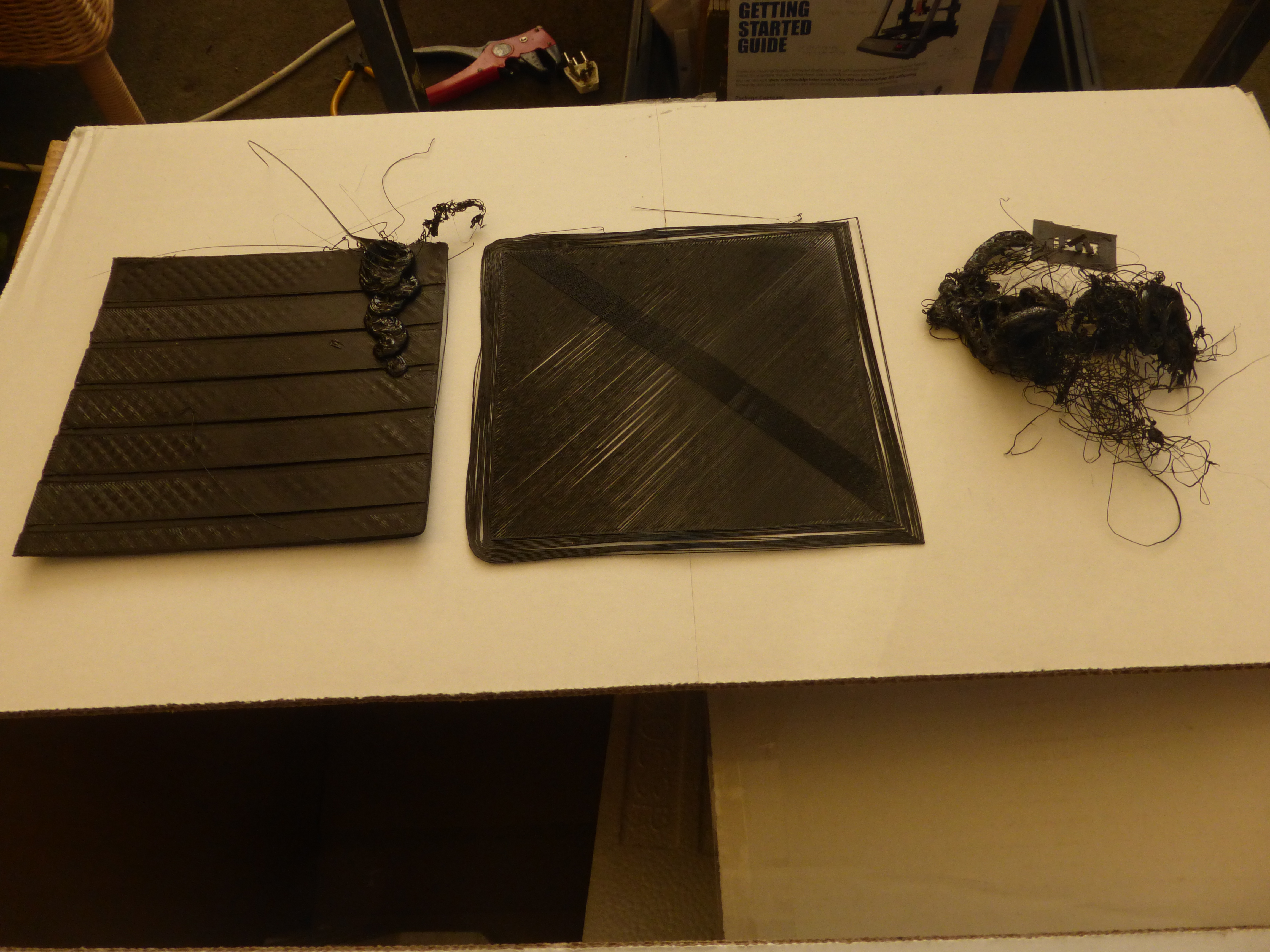

3D printing is not without its problems, even for someone experienced with 3 axis machine tools. The results of the success and failures can be seen in the pictures.

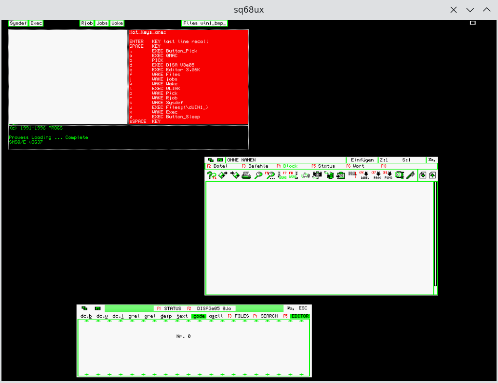

Hmmm... sq68ux screenshot without highcolour?desin wrote: Thu Nov 09, 2023 7:47 pm ask Xora about a update for sq68ux or about running SMSQE on sQLux

Marcus; your screenshot is impressive. I had no idea that sq68ux could display at high resolutions. I am not sure how I ask Xora about an update or how to run SMSQE on sQLux. I assume that stuff concerning this is not on Dilwyn's website. Greetings, by the way, from Genf.

sQ68ux, is a wonderful piece of software, but due to the limited software development has problem,s with higher resolutions.
I cloned the sQ68ux Git repository and compiled the source code easily, since I have my Linux Mint 21.2 computer setup to compile sQLux,
There is also qlay3 in the sQ68ux repository, which work well.
The Q68 is a 40Mhz 68000 QL, which out performs a 68020 Supergold card.
The Q68 display I like are:
DISP_MODE 0 : 256x256 Mode 8
DISP_MODE 1 : 512x256 Mode 4
DISP_MODE 2 : 512x384 Mode 33
DISP_MODE 4 : 1024x768 Mode 4
Personally, I think the Q68 High Colour display modes were a mistake, as the effort to display 1024x768 16bit colour is too much, I use 1024x768 Mode 4, which is good enough for most QL programming and older QL software.
