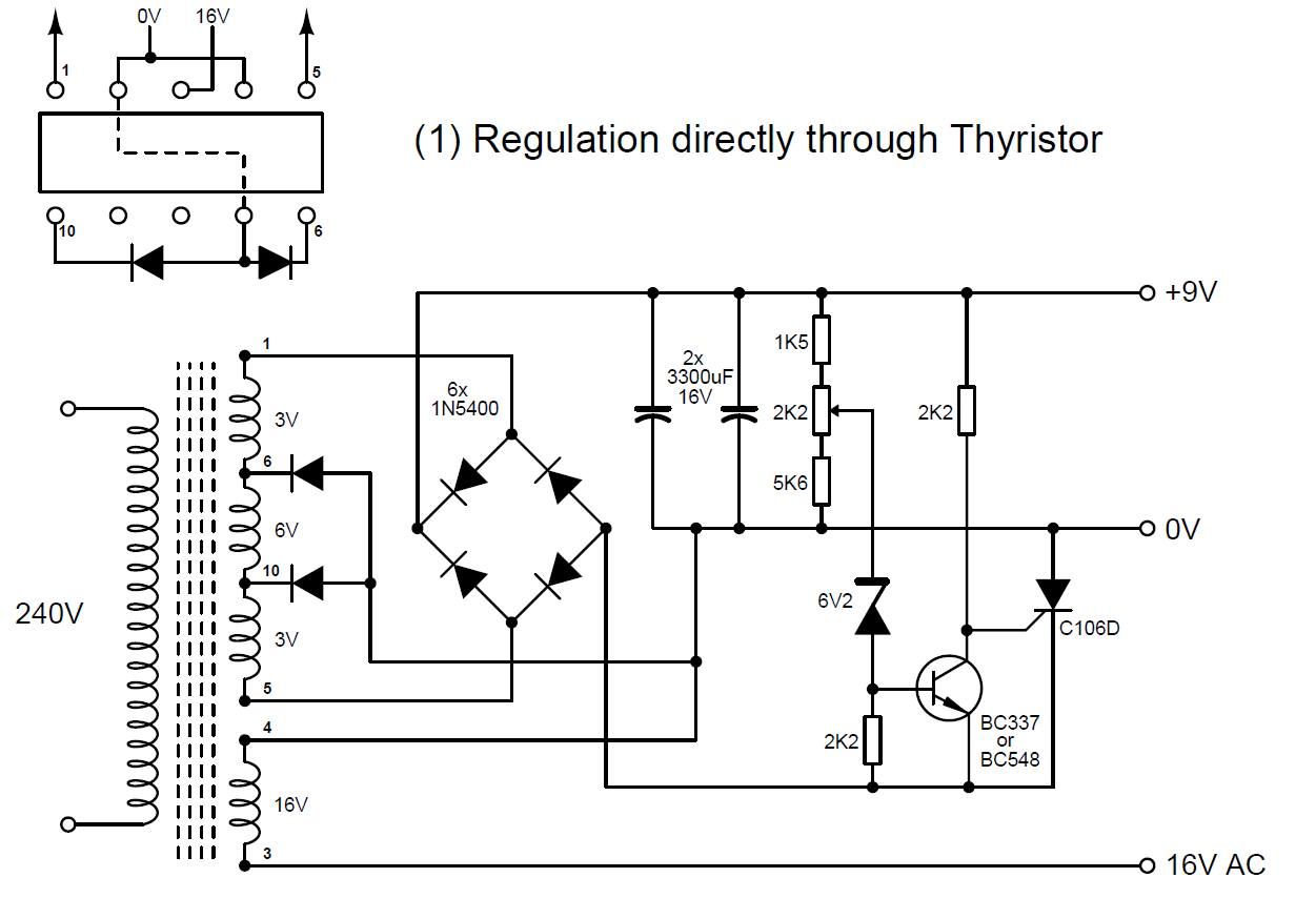

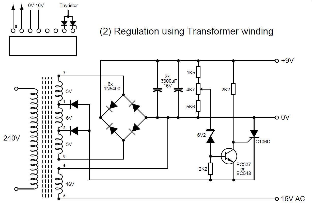

I don't remember the source, most likely from the forum but here are the schematics.
/Chris
