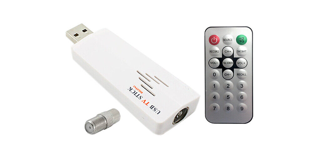

So I recently bought this (only $23):
eBay link here:
https://www.ebay.com/itm/254051981718
Which is an odd TV USB stick. I say odd because it doesn't do digital TV, only analog. Additionally odd, it seems to have been produced in the last few years, as it has Windows 11 drivers. I have no idea what market there is for these...I'm thinking maybe for cable boxes? But the cool thing is, this stick can grab an analog RF signal from both UK computers and US computers (it can actually grab any RF analog signal used around the world).
It's actually quite handy for anyone not technical that, say, wants to explore a Spectrum but lives in the US. They buy this stick, and plug their Spectrum into the antenna connector (either Belling-Lee or SubMinture A) and quickly can get a pretty nice picture.
In any case, I tried it on all my gadgets and got a beautiful RF signal on channel 36 for my Amiga 600. I realize, not needed since the Amiga has both composite and RGB, but still cool to be able to get that. Next time I get a Spectrum and need to debug it to see if it works, I can just use that stick before opening it up to do the composite mod...so a handy tool.
I also tried it for my US-based ones (1 QL and 2 TS1000). The odd thing was that the US version had a crappy signal. They have a very good signal on US TV's, but when using the stick, each one had a repeating flicker that pulsed. I tried to add shielding to the USB stick and it didn't help. I thought maybe it was my WiFi, but that wasn't it either. Initially I thought the USB stick just could not handle an NTSC signal well, but then I plugged in an old cable box that gave out an NTSC RF signal, and that was perfect.

Doe's the Amiga 600 use the same kind of modulator as the Sinclair's. I was wondering if it's some kind of beat between the oscillators in the modulator and the tuner in the USB stick.
I don't think the modulators used by Sinclair were particularly good quality. So maybe you need a filter of some kind in the aerial lead.
Or maybe the RF signal level out of the modulators is too high, and is overloading the USB stick, So you need an attenuator in the line.
Re: Sinclair RF signal
I don't believe it's made by Aztec, like the Sinclair one's are. The Amiga's seem bigger (almost twice the size).Martin_Head wrote: Sun Sep 24, 2023 8:55 am Doe's the Amiga 600 use the same kind of modulator as the Sinclair's. I was wondering if it's some kind of beat between the oscillators in the modulator and the tuner in the USB stick.
I can try that. I was also thinking of just broadcasting the signal (I've played with antenna boosters as transmitters) to see if that gets rid of it. The other option it to try a really long cable.Martin_Head wrote: Sun Sep 24, 2023 8:55 am I don't think the modulators used by Sinclair were particularly good quality. So maybe you need a filter of some kind in the aerial lead.
That's probably true. The Amiga 600's signal seems to be weaker, needing a really good cable to avoid interference on a normal TV. I will see if I can fine an attenuator to see if it fixes it. Not that I need to, but just curious what's causing it.Martin_Head wrote: Sun Sep 24, 2023 8:55 am Or maybe the RF signal level out of the modulators is too high, and is overloading the USB stick, So you need an attenuator in the line.

So I tried an attenuator (7db) with no effect. Wondering if it needs to be more like 30db, though those aren't normal. I then added 10 ferrite toroid cores on the cable to the TV stick with no effect. Finally, I tried a 25 foot coaxial cable with the computer two rooms down on a different power circuit, again with no effect.
I played with transmitting the signal by using an antenna booster on the TS1000 side with it hooked an antenna, and then added an antenna to the TV stick, with still no effect. I still need to try and change the power adapter to the TS1000 (using the original one that came with it). I also may try 9 volts via battery to see if that would make a difference.
I'll probably eventually try and use my Spectrum's RF signal to see if it is all Sinclair computers, since then it may just be the Aztec modulators somehow putting out noise that a very sensitive receiver picks up but most TV's are able to filter out.

I had a quick look at your video, and I was wondering if it's something to do with the timings of the video signals.
The QL overscans the picture, and the ZX81 has the white border, Which may be confusing the USB stick if it's looking for a black level on the front or back porch area. But the ZX81 is white at that point. Although the idea dos'nt quite fit for the QL's start up page.
