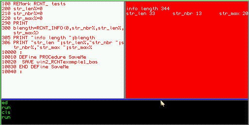

I've been looking at the problem I have in the Q68 with the RCNT_GALL command again.
First RCNT_INFO (example1_bas)

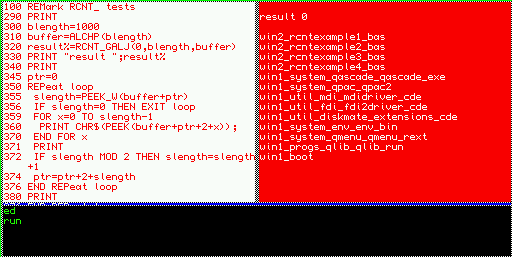

Now RCNT_GALJ (example3_bas)

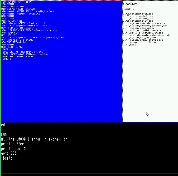

Now RCNT_GALL (example4_bas)
Note that when RUN, if failed on line 10030 which has nothing wrong with it. It's actually the RCNT_GALL line that has problems.
When I GO TO'ed 330. RCNT_GALL has correctly filled the buffer. So it looks like RCNT_GALL has problems when returning to BASIC.
Note also that RCNT_INFO reports 13 file names, but RCNT_GALL returns 14 file names. The extra file name being the qascade_rc file.
Maybe I have got the wrong end of the stick, but I thought that RCNT_INFO with a job ID of 0, gave the general list. So does job 0 have a separate list from the general list? If so how do you select the general list with RCNT_INFO.
When I tried to RUN the program again, SBASIC crashed.

Admittedly, RCNT is probably not the most used Thing in SMSQ/E. I had to first activate it on my system using menuconfig. (Tested on QPC2)
I can confirm that RCNT_GALL behaves the same on my system. It doesn't seem to be a buffer overflow, because even if you point the program into the middle of a ridiculously large buffer, it will still behave the same)
RCNT_GARR does practically the same thing and works properly, however.
