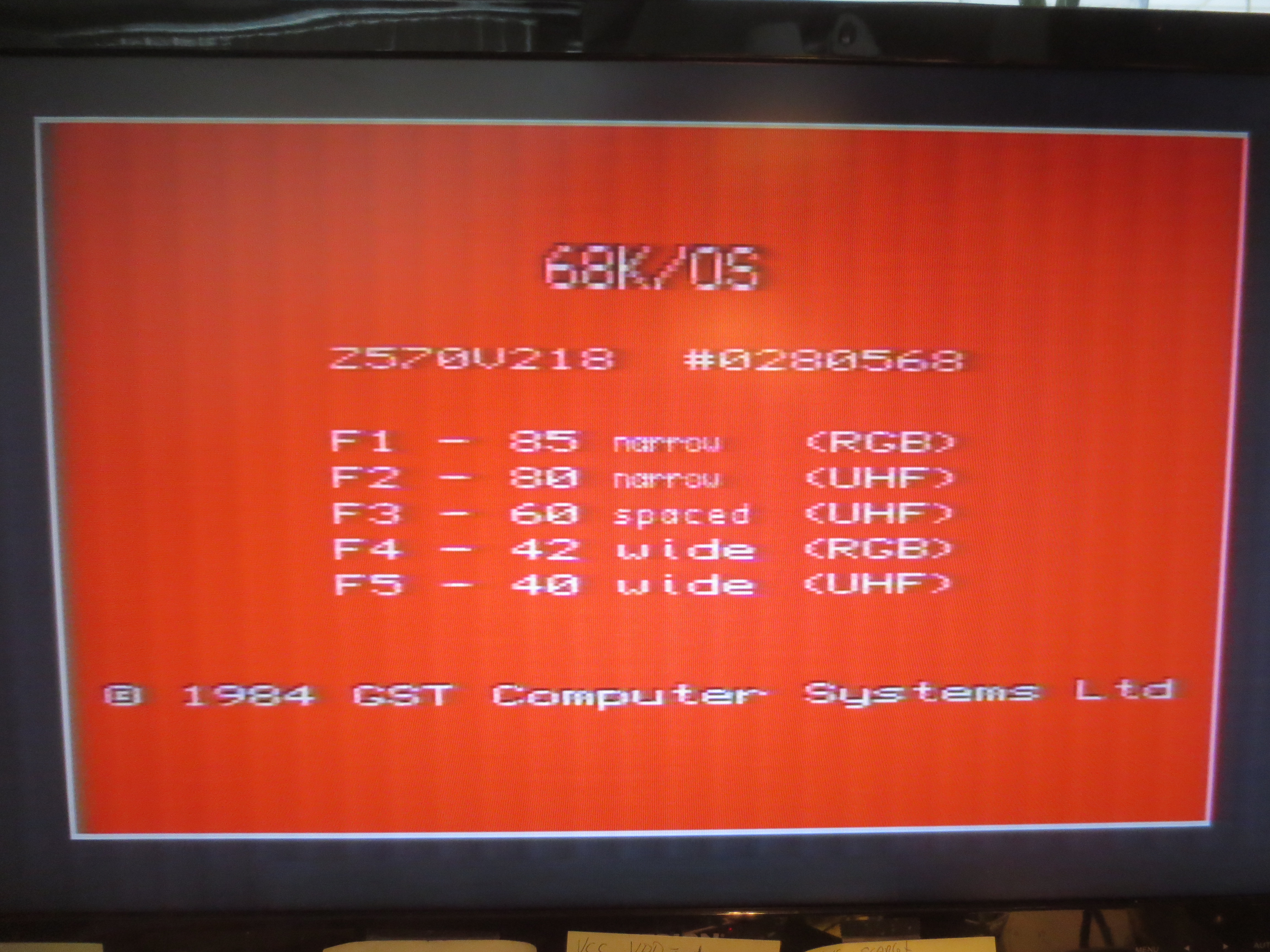

the rom does work , now to learn how to use it ;-)
is the asm also available as rom ?
are there any other roms available ?

techy
Posts: 385
Location: belgium
Re: is there a way to get 68k/os working on a real ql ?
Post by techy »
the rom does work , no to learn how to use it ;-)
