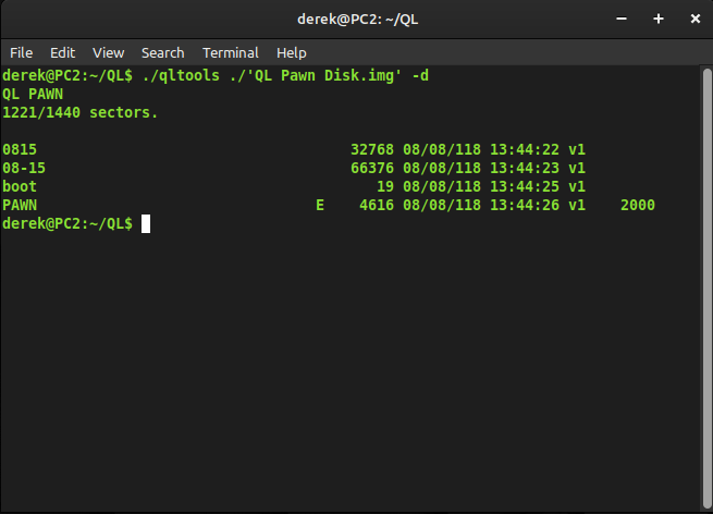

Posts: 4861
Re: qltools 2.15.5 problem on Linux
I have a Linuix Mint 21.1 x64 Linux OS.
I downloaded qltools to a directory in my home directory, made it executable and run it successfully on the QL Pawn Disk.img file, see attached screen shot:
Maybe you do not have permission to run programmes in that location, try moving it to your home directory.
