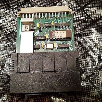

hi forum , got this old cst qdisk interface which is not respondign to anything ( no start-up logo on the main ql screen )
i have tested the eprom in the rom socket of the ql -> works fine
Now to get to the task of getting the interface card to give me a response ......
i socketed all ic's but no luck .
is there any one out there with the schematic to this card ?

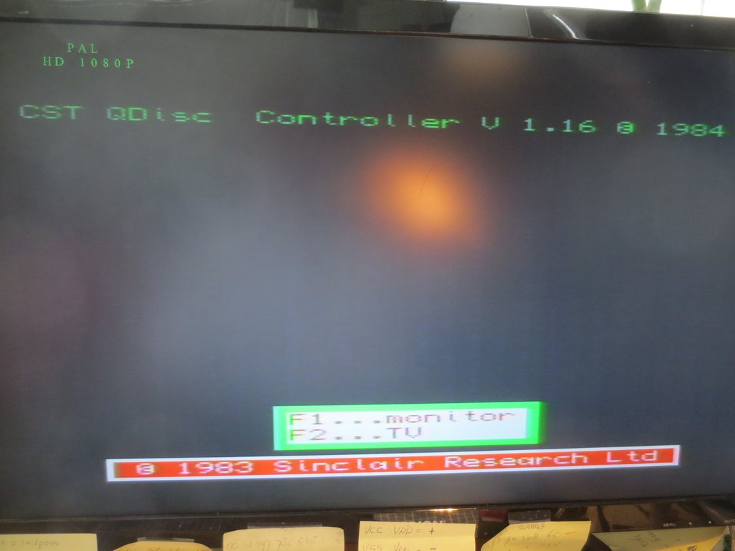

=> this is NOT the screen i get when i insert the floppy interface !!

So i can read the installed eprom on the eprom-port of the ql ,
but NO action when installed on the qdisk interface.
5 volt is there .
all ttl chips have been verified .
looking for a good picture of all chips installed , as maybe the previous owner put on a wrong chip ......
or maybe the transistor ( without marking on mine ) ??
any help ??

If the ROM on the CST QDISK interface has been replaced, it maybe not usable on the CST QDISK, as CST used a jumbled ROM scheme to programme their Firmware ROMs.
So if the current EPROM is a standard ROM code then this is the problem.
This has been discussed in this thread:viewtopic.php?t=3422

Thank you all !!
interface is working like it should !!
with 1.18 rom .
