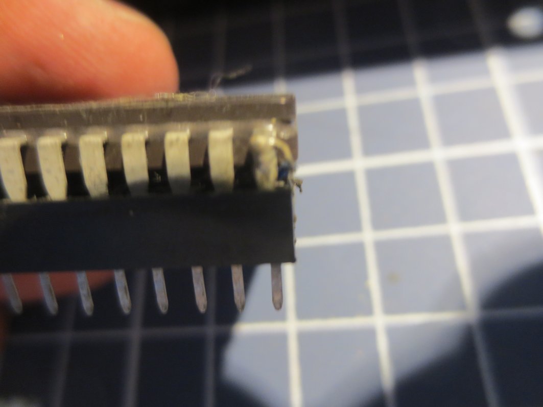

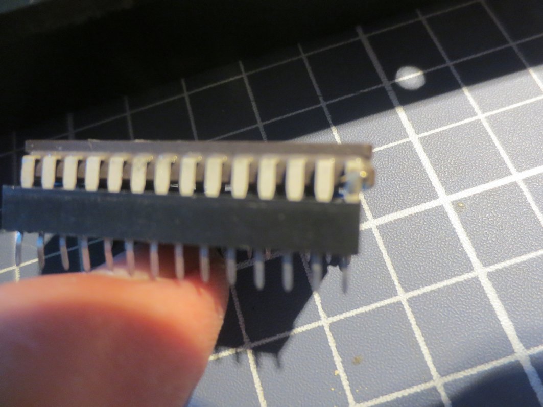

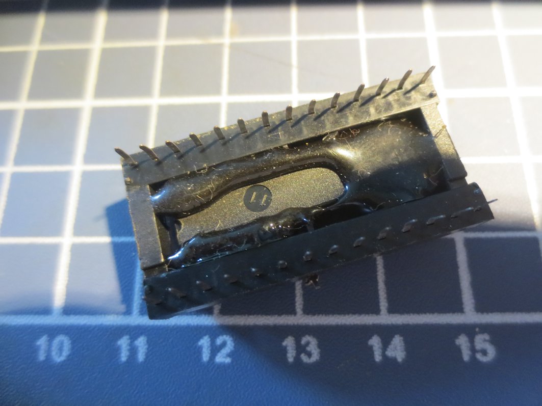

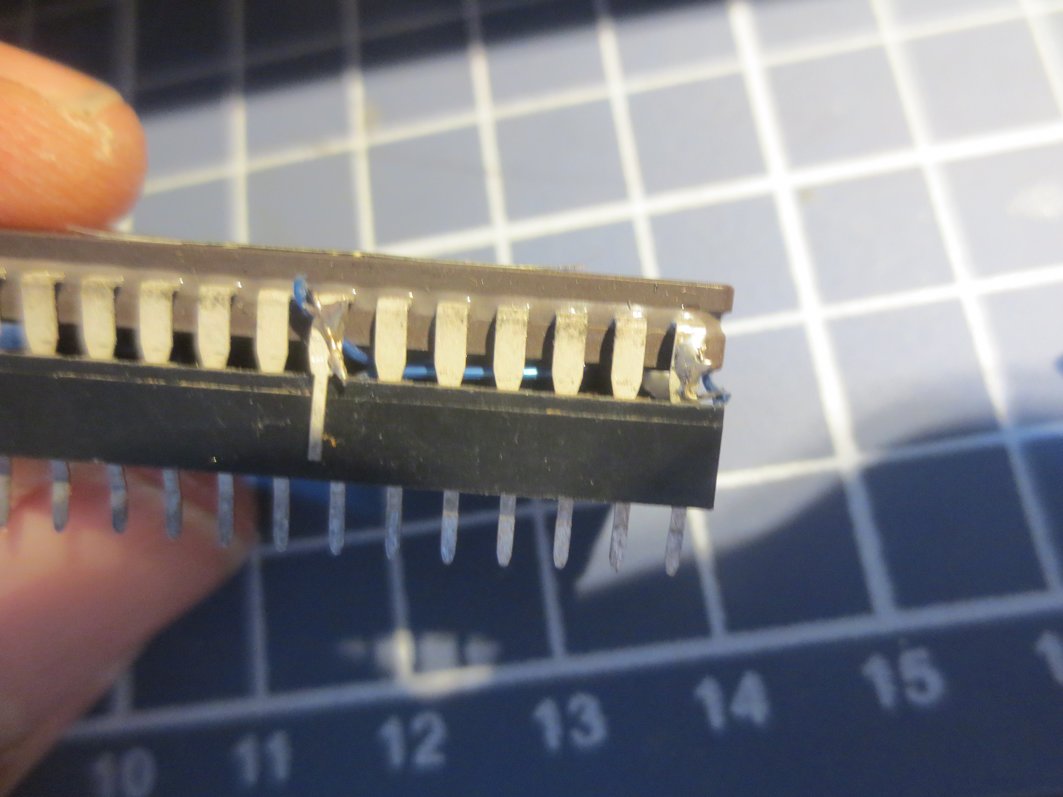

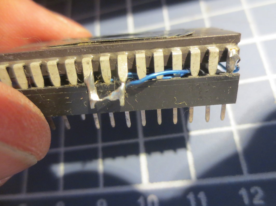

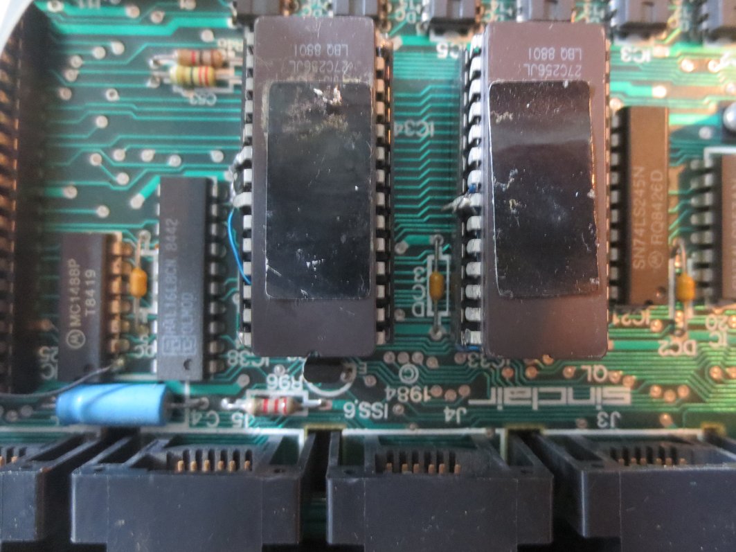

found this inside my french ql ,
it has embedded lightning .
i would like to know what conversion system has been used to get 2 x 27c256 in place of the original roms .
AND i would like to know how to burn such adapted eproms .
in the sockets are ttl chips embedded which are connected to several pins of the eproms .
Posts: 1400
Re: someone recognizes this eprom conversion ?
That's a home made adapter with a 27C512 EPROM ( I think) and the chip buried underneath is probably a 74LS00 (or equivalent). It's a bit fiddly, but not that hard to make something like that. You can also change the jumpers on most boards to accept an EPROM and some even have a socket for the required 74LS00 logic chip.
Post by techy »
Thanks for your answer !!
it is 2 x 27c256 eproms .
Is this modification described somewere ??

techy
Posts: 385
Location: belgium
Post by techy »
ah , sorry , they are next to each other so occupy both original rom positions .
there are no wires outside the socket connected to the board .
