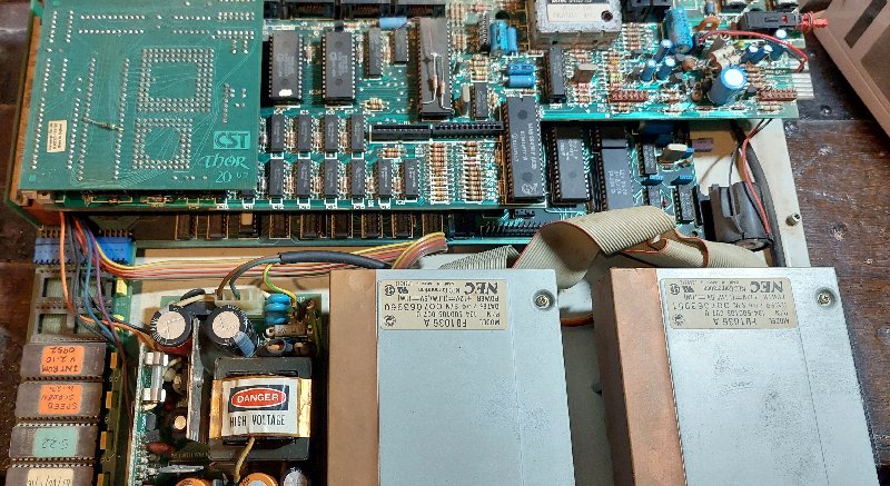

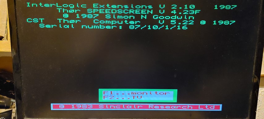

Hello,
New member here, can't really class myself as a QL collector, but owned a Thor for 30+ years, used it in the early 90's then stored it away in a cupboard. I powered it up maybe 20 years ago and it had issues with the keyboard so I stored it again and forgot about it. I would periodically look on line for THOR information, and the only info beyond BIO stuff all lead to this forum.
So finally this month I had a sudden urge to unpack the Thor and take another look, spurred on by the mentions of Varta battery leakage, I confess my THOR still has the original battery, which had not leaked after 35 years... or if it had no damage was caused (have now removed and waiting for new one to install on separate daughter board). This may be due to it being stored in dry areas not subject to wide temperature changes, and storing the THOR on its side with the battery at the bottom (deliberately as I realised the battery may have been an issue all those years ago).
I did some technical reading on the THOR looking to work out the issue with my THOR, the symptoms were it would reach the post screen and then nothing, keyboard was dead, or sometimes allow you to press F1/F2 and then type 3-10 characters on the keyboard before locking up again. My keyboard has one faulty key, the switch is broken, so I thought the issue would be the keyboard, perhaps the ZX8302 communications controller or even the serial keyboard interface Motorola MC 6850. Sadly I'm not setup for testing other than perhaps swapping out chips (not healthy on a old PC I know as voltage levels etc may not be stable). But then reading the THOR technical notes from Dilwyn's superb resource, it mentions that disk read/write operations share the I/O with the keyboard and will interrupt and even completely stop keyboard input. This got me thinking and disconnecting my two floppy drives, got the keyboard working...... just sharing this advice for fellow THOR owners that its sometimes an easy solution rather than the chips.
I checked the drives and found one to be faulty, it seemed to think it had a disk inserted even when it didn't, so was over riding the keyboard input. The drives are NEC's FD1036A, with the copper shielding etc I bet they don't make them like that anymore. Thankfully the other drive works other than when doing a disk ejection it gets stuck.

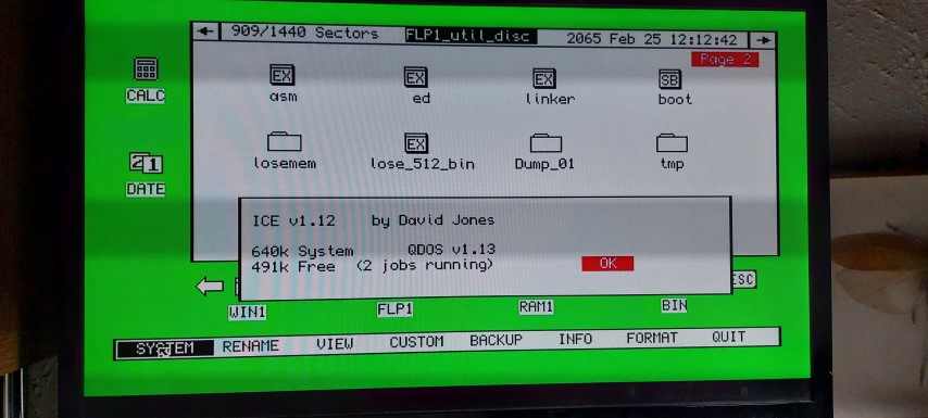

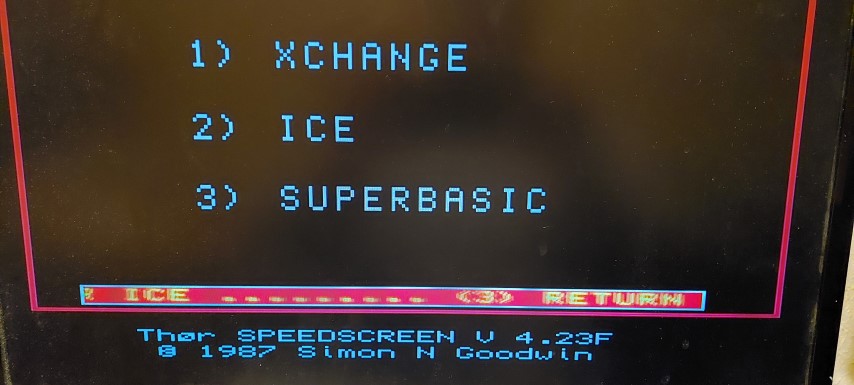

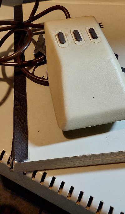

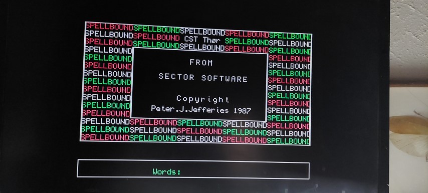

I still have the original 3 button mouse (made in England, I doubt we still make mice), and booting up ICE, it still works and was a walk down retro memory lane.

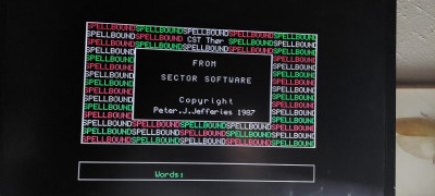

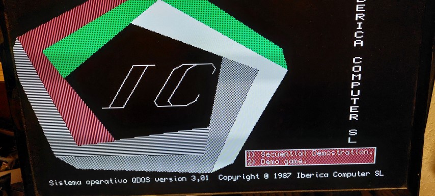

I booted a few programs, some failed and a few ran (or partially ran), so I guess its a case of salvage what I can and hopefully see if images exist on the NET. The fact any disks worked after 30+ years was a surprise.

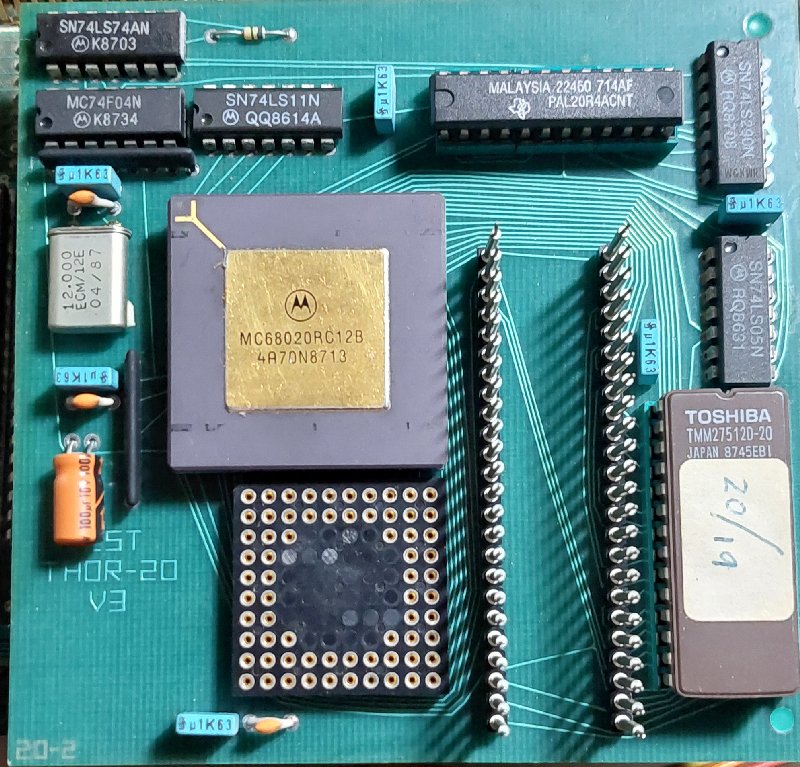

As a side note, I have an external micro drive unit (has the voltage regulator removed to work on a THOR), that back in the day I recall using with the THOR, I had to remove the THOR 20 board, replace it with 68008 processor (68020 was too fast to allow the micro drive to function correctly), change the system roms from 5.22 to 4.22, alter a few jumper settings (I recall at least one for the floppy drives that needed removing). So yes you could use a micro drive on a THOR 8. But I'll not be trying that now with 35 year old roms etc.
