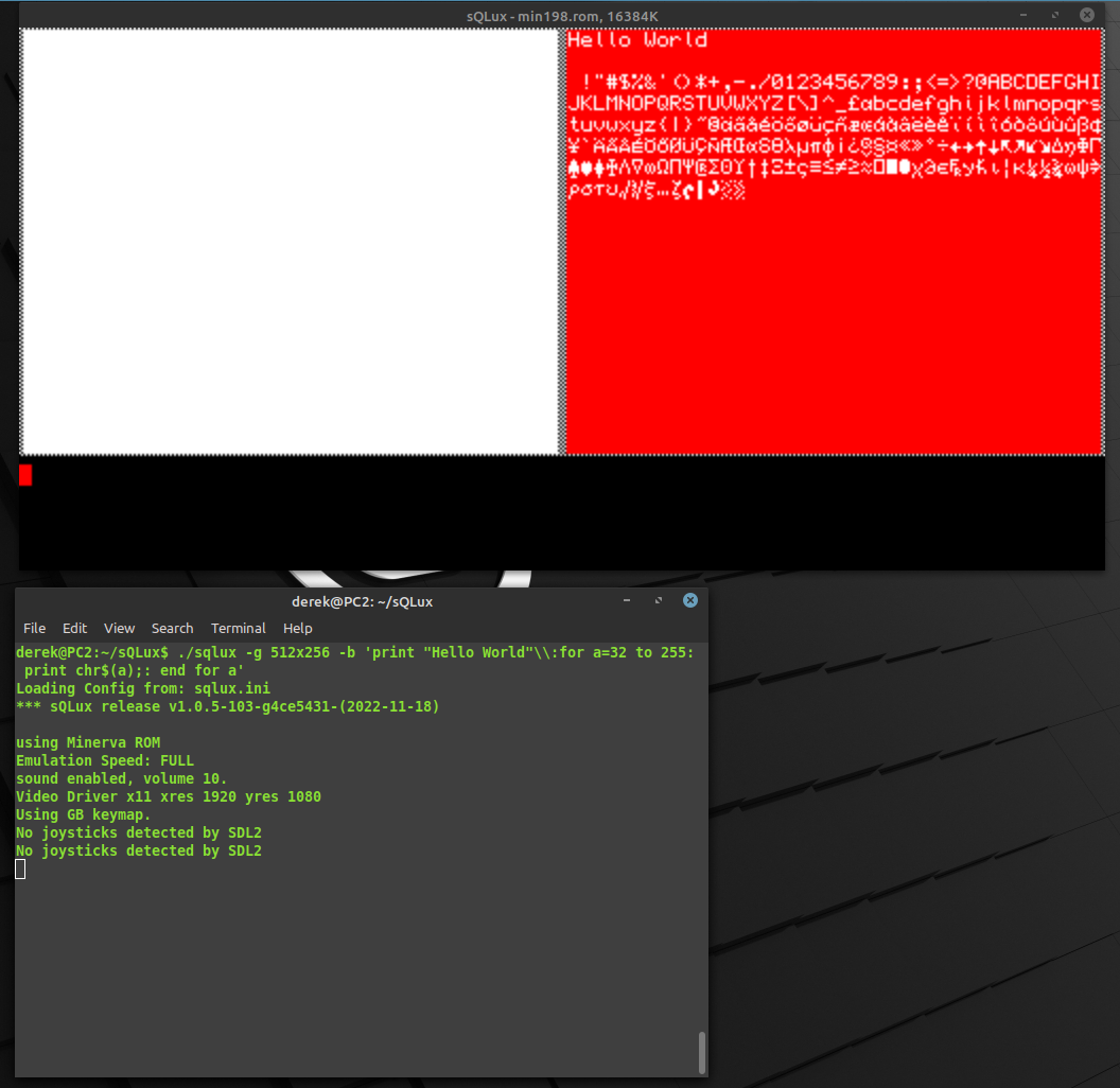

I will updated my sQLux git and compile, using the new compile options and did this test:
sQLux running from command line
Using the command line to define the SuperBasic command and size of Window, also using defaults in the sqlux.ini file:
sqlux -g 512x256 -b 'print "Hello World"\\:for a=32 to 255: print chr$(a);: end for a'
I was going to write a script/macro to use an IDE to write the Superbasic file and run the file in sQLux, maybe VS Code or just VIM maybe an idea.
