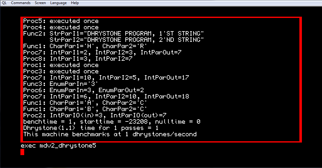

For fun I've been trying to compile the Dhrystone code under Digital C SE. A possible goal, besides just wanting to play with my old compiler on the QL, is to maybe write a SysInfo-like application for the QL (i.e. nice interface that gave some info on the model you had and then ran Dhrystone to tell you how fast it is). We will see if I end up doing that.
I finally got it to run though it still have some issues. For whatever reason it seems to balk above 16 bits, i.e. when my LOOPS variable is 33000 (it's normally hard-coded at 50000 for 16 bit machines but I made it input for debugging) it runs into an infinite loop, suggesting something is wrapping around at the 16 bit boundary. Not sure why since the loop variable (i) is a long (i.e. 32 bits).
When I run it for 32000 loops it seems to work but the results are abysmal, running at half the speed of the pre-compiled executable (Bench.zip from Dilwyn's site, which comes with source and an executable). When I run it on QLAY at whatever speed I have it set to, it gives around 1300 Drhystones compared to 2800 from the pre-compiled version, so there is something still not right.
Looking at the source, there are some oddities in there. Has anyone ever looked at the Dhrystone code? Below is my revised version. I kept the original and either commented out stuff I couldn't use or changed it in place. For instance, Digital C SE doesn't offer typedef so I used #define where that worked, and also made changes appropriately. It doesn't allow 2D arrays directly but you can use a nested struct to easily solve that, etc...

But one of the oddities is in the nested for loop after the "Start Timer" comment. I don't see how the if statement:
	for (CharIndex = 'A'; CharIndex <= Char2Glob; ++CharIndex)
		if (EnumLoc == Func1(CharIndex, 'C'))
			{ Proc6(Ident1, &EnumLoc); printf("2"); }   /* I added the printf */
...will ever be true. EnumLoc is always set to Ident2 a few statements before this code and CharIndex will only ever be 'A' or 'B' since Char2Glob is only ever set to 'B' in one place. Func1 returns Ident1 if its two parameters are different and since CharIndex is never 'C' that is always the case. So EnumLoc always set to Ident2 and Func1 always returning Ident1 means Proc6 there is never called (it's why I put a printf in there to check).
Does the Dhrystone code supposed to have non-called code in there? Is this a test of how well a compiler optimizes stuff like that out? I know that Dhrystone was designed to test the speed of a computer within the context of a particular C compiler it used to create the test.
Here is another doozy:
Proc4()
  REG boolean BoolLoc;
  BoolLoc = Char1Glob == 'A';
  BoolLoc |= BoolGlob;
  Char2Glob = 'B';
So BoolLoc is local and it is computed to be either true or false, depending on what Char1Glob is. But, then nothing is ever done with it?!? Btw, this is the only place that Char2Glob, used in the questionable code above, is set.
Posts: 1606
Re: Dhrystone compiled on BBQL with Digital C SE
So indeed, that code is not supposed to execute. I found this more updated source on ghithub and it's been modified through the years to add more redundant code to prevent parts of generated code from being pruned out...plus heavily commented to talk about what's going on.
https://github.com/Keith-S-Thompson/dhr ... ces/dhry-c
I guess the point is that the code is supposed to represent the running of a somewhat normal program where some things execute and some don't. Presumably they didn't want to add random variations to it, so that all branches would get executed, to get as precise a comparison as possible.
Now I just need to fix my bug (the 3 for loops running on LOOPS variable) and figure out why the dang thing runs so slow...
Posts: 1606
Well, after a ton of debugging, I finally got it to work. It was actually working for a while but I needed to debug it to make sure it was running correctly. The previous github link foretold what each procedure/function should do and which parts should not execute. I stuck a printf into each section that shouldn't run (printing BAD) and output what each value for parameters should be:
Part of the problem was how slowly it was running. The German benchmark program (Bench.zip from Dilwyn's site) ran at 208 Dhrystone on QLAY configured to be about real-time BBQL (less than 10% faster). The German version was compiled under Lattice C (I'm assuming that means it was cross compiled - EDIT: it's the Metacomco version that requires a ROM to work). My Digital C SE ran at 79 Dhrystones, so very slow.
I discovered that my dataspace was too small (8000) and the sweet spot was 18,000. The German version has a dataspace of 11,374 (so Lattice C must compute the actual dataspace size -- I've tried different values and even at 17,950 it slows down a bit, so 18,000 seems to be just right). Interestingly, the German version executable is 17.5K while Digital C SE's was about 10K so, with dataspace, both were about equal in size. I'm not sure why dataspace has to be so large (I guess I don't fully understand what dataspace is for). The biggest structure in the code is a 2D array of 5200 bytes and then just a bunch of singular variables and no recursion. Nothing that would amount to another 5K (or 12K for Digital C SE). My ZXSimultor works just fine in 8K database, though it mostly lives in the heap.
So with larger dataspace my version sped up form 79 Dhrystones to 89 Dhrystones. I then discovered a small piece of code for structure assignment that's put into place if the language does't allow for one structure to be simply assigned to another (i.e. some languages allow s1 = s2 and it copies all fields fully). Here is the code:
memcpy(d, s, l)
register char *d;
register char *s;
register int l;
  while (l--) *d++ = *s++;
I replaced that with a specific structure assignment code:
structassign(d, s)
struct Record* d;
struct Record* s;
  d->PtrComp = s->PtrComp;
  d->Discr = s->Discr;
  d->EnumComp = s->EnumComp;
  d->IntComp = s->IntComp;
  strcpy(d->StringComp,s->StringComp);
I figured that was fair since the Dhrysone_c code did have an option to use the fastest way for the language to do those type of assignments. Well, this improved the runtime to 175 Dhrystones (i.e basically doubled the speed). Still not close, but definitely getting better. I did run the German version on my actual QL and it ran at 190 Dhrystones and I'm going to guess my Digital C SE version is going to come in at close to 160 Dhrystones (if the ratio holds out). So Digital C SE isn't as efficient as it could be.
Not sure where the issue is but some things can't be improved upon...i.e. I know array indexing can be a bit sloppy in Digital C SE but that needs to stay put for the Dhrystone measure to be an accurate representation (I can't replace it with direct pointer manipulation, which I know is faster and I've done in ZXSimulator).
It's been fun learning about what Dhrystone does...feel a bit more fluent about it now. Version 2.1 has some changes that don't impact the runtime but it's interesting to read/understand why it was done. I will follow up with a zip file of the Digital C compiled version, once I get it to where I want it.

   exit(0);
/* Package 1  */
int IntGlob;
boolean BoolGlob;
char Char1Glob;
char Char2Glob;
Array1Dim Array1Glob[51];
struct Array2Dim Array2Glob[51];
struct Record* PtrGlb;
struct Record* PtrGlbNext;
Proc0()
   OneToFifty IntLoc1;
   REG OneToFifty IntLoc2;
   OneToFifty IntLoc3;
   REG char CharLoc;
   REG char CharIndex;
   Enumeration EnumLoc;
   String30 String1Loc[31];
   String30 String2Loc[31];
   /* extern char *malloc(); */
   /* register unsigned */ long i;
#ifdef TIME
   /* long time(); */
   long starttime;
   long benchtime;
   long nulltime;
   starttime = date(); /* time((long *) 0); */
   for (i = 0; i < LOOPS; ++i);
   nulltime = /* time((long *) 0) */ date() - starttime;   /* Computes o'head of
loop */
#endif
#ifdef TIMES
   time_t starttime;
   time_t benchtime;
   time_t nulltime;
   struct tms tms;
   times(&tms);
   starttime = tms.tms_utime;
   times(&tms);
   nulltime = tms.tms_utime - starttime;   /* Computes overhead of looping */
#endif
   PtrGlbNext = malloc(RecordSize);
   PtrGlb = malloc(RecordSize);
   PtrGlb->PtrComp = PtrGlbNext;
   PtrGlb->Discr = Ident1;
   PtrGlb->EnumComp = Ident3;
   PtrGlb->IntComp = 40;
   strcpy(PtrGlb->StringComp, "DHRYSTONE PROGRAM, SOME STRING");
#ifndef   GOOF
   strcpy(String1Loc, "DHRYSTONE PROGRAM, 1'ST STRING");   /* GOOF */
#endif
   Array2Glob[8].col[7] = 10;   /* Was missing in published program */
-- Start Timer --
#ifdef TIME
#endif
#ifdef TIMES
   times(&tms);
#endif
   for (i = 0; i < LOOPS; ++i) {
      Proc5();
      Proc4();
      IntLoc1 = 2;
      IntLoc2 = 3;
      strcpy(String2Loc, "DHRYSTONE PROGRAM, 2'ND STRING");
      EnumLoc = Ident2;
      BoolGlob = !Func2(String1Loc, String2Loc);
      while (IntLoc1 < IntLoc2) {
         IntLoc3 = 5 * IntLoc1 - IntLoc2;
         Proc7(IntLoc1, IntLoc2, &IntLoc3);
         ++IntLoc1;
      Proc8(Array1Glob, Array2Glob, IntLoc1, IntLoc3);
      Proc1(PtrGlb);
      IntLoc3 = IntLoc2 * IntLoc1;
      IntLoc2 = IntLoc3 / IntLoc1;
      IntLoc2 = 7 * (IntLoc3 - IntLoc2) - IntLoc1;
      Proc2(&IntLoc1);
-- Stop Timer --
#ifdef TIME
   benchtime = /* time((long *) 0) */ date() - starttime - nulltime;
   printf("benchtime = %ld, starttime = %ld, nulltime = %ld\n",
          benchtime, starttime, nulltime);
   printf("Dhrystone(%s) time for %ld passes = %ld\n",
          Version,
          LOOPS, benchtime);
   printf("This machine benchmarks at %ld dhrystones/second\n",
          LOOPS / benchtime);
#endif
#ifdef TIMES
   times(&tms);
   benchtime = tms.tms_utime - starttime - nulltime;
          Version,
          (long) LOOPS, benchtime / HZ);
          ((long) LOOPS) * HZ / benchtime);
#endif
Proc1(PtrParIn)
REG struct Record* PtrParIn;
   /* #define NextRecord   (*(PtrParIn->PtrComp)) */
   struct Record* PtrTmp;
   structassign(PtrParIn->PtrComp, PtrGlb);
   PtrParIn->IntComp = 5;
   PtrTmp = PtrParIn->PtrComp;
   PtrTmp->IntComp = PtrParIn->IntComp;
   PtrTmp->PtrComp = PtrParIn->PtrComp;
   Proc3(&PtrTmp->PtrComp);
   if (PtrTmp->Discr == Ident1) {
      PtrTmp->IntComp = 6;
      Proc6(PtrParIn->EnumComp, &PtrTmp->EnumComp);
      PtrTmp->PtrComp = PtrGlb->PtrComp;
      Proc7(PtrTmp->IntComp, 10, &PtrTmp->IntComp);
   } else
      structassign(PtrParIn, PtrParIn->PtrComp);
   /* #undef   NextRecord */
Proc2(IntParIO)
OneToFifty *IntParIO;
   REG OneToFifty IntLoc;
   REG Enumeration EnumLoc;
   IntLoc = *IntParIO + 10;
   for (;;) {
      if (Char1Glob == 'A') {
         --IntLoc;
         *IntParIO = IntLoc - IntGlob;
         EnumLoc = Ident1;
      if (EnumLoc == Ident1) BREAK;
Proc3(PtrParOut)
long *PtrParOut;
   if (PtrGlb != NULL)
      *PtrParOut = PtrGlb->PtrComp;
   else
      IntGlob = 100;
   Proc7(10, IntGlob, &PtrGlb->IntComp);
Proc4()
   Char2Glob = 'B';
Proc5()
   Char1Glob = 'A';
   BoolGlob = FALSE;
extern boolean Func3();
Proc6(EnumParIn, EnumParOut)
REG Enumeration EnumParIn;
REG Enumeration *EnumParOut;
   *EnumParOut = EnumParIn;
   if (!Func3(EnumParIn)) *EnumParOut = Ident4;
   switch (EnumParIn) {
      case Ident1: *EnumParOut = Ident1; BREAK;
      case Ident2:
         if (IntGlob > 100)
         else
         BREAK;
      case Ident3: *EnumParOut = Ident2; BREAK;
      case Ident4:
         BREAK;
      case Ident5: *EnumParOut = Ident3;
Proc7(IntParI1, IntParI2, IntParOut)
OneToFifty IntParI1;
OneToFifty IntParI2;
OneToFifty *IntParOut;
   IntLoc = IntParI1 + 2;
   *IntParOut = IntParI2 + IntLoc;
Proc8(Array1Par, Array2Par, IntParI1, IntParI2)
Array1Dim *Array1Par;
struct Array2Dim *Array2Par;
   REG OneToFifty IntIndex;
   IntLoc = IntParI1 + 5;
   /* Array1Par[IntLoc] = IntParI2;              */
   /* Array1Par[IntLoc + 1] = Array1Par[IntLoc]; */
   Array1Par[IntLoc + 1] = Array1Par[IntLoc] = IntParI2; /* helps optimize */
   Array1Par[IntLoc + 30] = IntLoc;
   for (IntIndex = IntLoc; IntIndex < IntLoc; ++IntIndex)
      Array2Par[IntLoc].col[IntIndex] = IntLoc;
   ++(Array2Par[IntLoc].col[IntLoc - 1]);
   Array2Par[IntLoc + 20].col[IntLoc] = Array1Par[IntLoc];
   IntGlob = 5;
Enumeration Func1(CharPar1, CharPar2)
CapitalLetter CharPar1;
CapitalLetter CharPar2;
   REG CapitalLetter CharLoc1;
   REG CapitalLetter CharLoc2;
   CharLoc1 = CharPar1;
   CharLoc2 = CharLoc1;
   if (CharLoc2 != CharPar2)
      return(Ident1);
   else
      return(Ident2);
boolean Func2(StrParI1, StrParI2)
String30 *StrParI1;
String30 *StrParI2;
   REG OneToThirty IntLoc;
   REG CapitalLetter CharLoc;
   IntLoc = 1;
   while (IntLoc <= 1)
      if (Func1(StrParI1[IntLoc], StrParI2[IntLoc + 1]) == Ident1) {
         CharLoc = 'A';
         ++IntLoc;
   if (CharLoc >= 'W') if (CharLoc <= 'Z') IntLoc = 7;
   if (CharLoc == 'X')
      return(TRUE);
   else {
      if (strcmp(StrParI1, StrParI2) > 0) {
         IntLoc += 7;
         return(TRUE);
      } else
         return(FALSE);
boolean Func3(EnumParIn)
   EnumLoc = EnumParIn;
   if (EnumLoc == Ident3) return(TRUE);
   return(FALSE);
#ifdef NOSTRUCTASSIGN
memcpy(d, s, l)
register char *d;
register char *s;
register int l;
#else
structassign(d, s)
struct Record* d;
struct Record* s;
#endif
