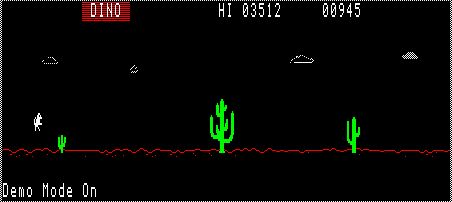

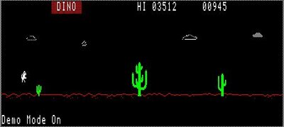

Dino is a QL version of the classic browser game where you control a little dinosaur running through the desert. Jump over the cactuses - they are fatal if you crash into them.
A horizontally scrolling simple platform game. Written in SuperBASIC, with notes on modifying the program yourself. Can be compiled with Turbo or QLiberator if you wish. Too slow to run on a standard QL, but should run on anything from Gold Card upward as long as it has Toolkit 2, on QDOS or SMSQ/E systems. See the instructions in dino_doc for how to configure the running speed for your system.
Try the Demo Mode where you can see what you're up against first!
Download from my site at http://www.dilwyn.me.uk/games/dino.zip

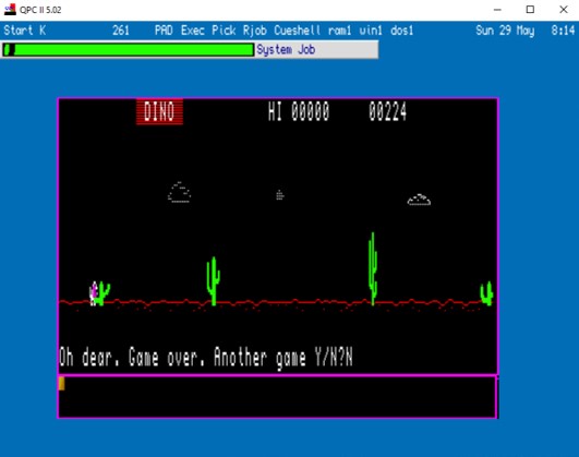

For QPC2/SMSQmulator users with large screens the following tweaks make it, perhaps, more comfortable:
Then just EXEC, or whatever, Dino_bas
Thanks, Dilwyn (Sorry, Dilwyn)
225 open#0; 'con': outln#0; 452,202,(scr_xlim - 452) / 2, 40
230 rem WINDOW #0,452,202,30,15 :
235 BORDER #0,1,255
240 open#1; 'con': rem WINDOW #1,452,202,30,15 :
245 BORDER #1,1,255
and
3045 quit

A few tweaks to run in windows #1: rather than #0: with my QPCII emulator
and very engaging to play!
