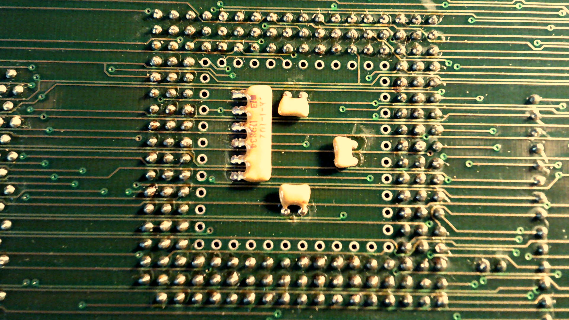

How does the CPU socket on your board look with regard to adding the extra pins? You don't need all inner pins, only VCCs and GNDs plus D4, K15, P15, Q8, Q11, Q12, Q15. The rest is unconnected.

Peter wrote:How does the CPU socket on your board look with regard to adding the extra pins? You don't need all inner pins, only VCCs and GNDs plus D4, K15, P15, Q8, Q11, Q12, Q15. The rest is unconnected.
BTW is it imperative that you obtain the right CPU extraction tool, or it OK to just be careful ?
Q40 circa 1999
Q40 circa 1999
It is sufficient to just be careful. Regarding the CPU socket, I was more interested in the top side, to see in which way the additional pins could best be added.
