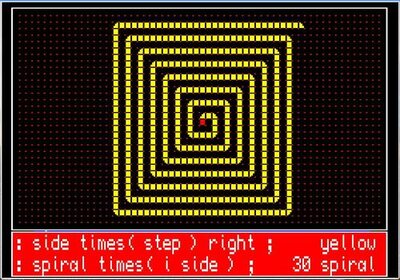

with first a word called SIDE to plot a strait line of <n> STEP and a RIGHT 90° turn :
: SIDE TIMES( STEP ) RIGHT ; expecting a number <n> of steps
and then a word using SIDE in another loop together with its index I :
: SPIRAL 30 TIMES( I SIDE ) ; for a fixed number of <30> sides
or :
: SPIRAL TIMES( I SIDE ) ; expecting the number <n> of sides to plot
This of course did not work, because entering the loop of SPIRAL, the first value of I was 0 and thus, the loop of SIDE got to do STEP zero times and did it actually 65535 times !
However, ComputerOne FORTH (and Folly on it) had a way to solve this issue : instead of DO , it has also a word ?DO that checks this "runtime condition" and does nothing when both bounds of a loop are equal.
whereas DO is coded using a looping primitive called (DO), ?DO uses a primitive called (?DO).
Wich I adopted for coding TIMES(
Let's compare :
: DO ?COMP COMPILE (DO) 0 , 3 ; IMMEDIATE
: ?DO ?COMP COMPILE (?DO) 0 , 3 ; IMMEDIATE
: TIMES( ?COMP COMPILE 0 COMPILE (?DO) HERE 0 , 3 ; IMMEDIATE
: LOOP ?COMP 3 ?PAIRS COMPILE (LOOP) 2+ BACK HERE SWAP ! ; IMMEDIATE
: ) ?COMP 3 ?PAIRS COMPILE (LOOP) DUP 2+ BACK HERE SWAP ! ; IMMEDIATE
To be continued when I discover how to do Folly with Supper FORTH ! Wich by the way has no ?DO word to inspire me.
