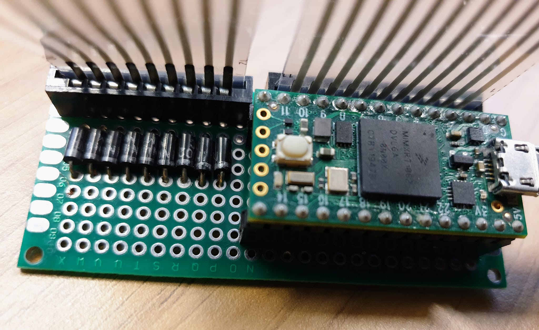

I did some initial prototyping on a breadboard, but as the result was going to be too thick to fit inside the case, I moved on to prototype board. Here's is what I ended up with:
It's about as simple as it could be, with one set of output pins connected to the keyboard pins through diodes, and the inputs connected directly to the columns.
The software scans each keyboard row in turn and keeps an internal map of which keys are pressed, as well as up to six concurrently pressed keys (though in practice, pressing more than two keys at once doesn't really work on the QL keyboard).
