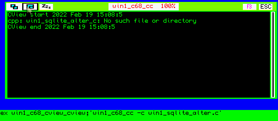

I seem to of forgotten how to compile a C programme with a .c extension.
I tried to compile the "alter.c" module from SQLite with, which gave this error:
C68 Compile in Cview
I like to use CVIEW to compile C modules, which up to now has had a "_c " extension and work OK.
My simple solution was to rename the .c to _c but then the compiler can not find the .h file
I seem to have a brain freeze on this, I have read the C68 manual many times bit can not see the solution.

Derek_Stewart wrote:My simple solution was to rename the .c to _c but then the compiler can not find the .h file
This is probably a stupid suggestion but do all the files have to be _ so .h >>_h?

Solution for industrious guys:
Rename all files from *.c and *.h to *_c and *_h
Lazy guys pack everything on a dos drive on QPC and let its file name translation do the job.

tofro wrote:Solution for industrious guys:
And really lazy guys use xtc68 to cross compile :-D
But yes, c68 was the reason I added automatic . -> _ translation to sQLux!

Thanks for the advice, my solution wad to rename all the files with .c or .c to _c or _h
It is strange that C68 header files can be defined as _h or .h in the C programme file. But a header file in the C source code file has to be _h
Maybe using XTC68 is a better option.

I am sure there is a something that can be supplied to the C68 CC programme to switch off the automatic extension translation.
But in the interim, my solution was to unzip the C source code with infoUNZIP and junk the stored directories, with the -j option, so that only the files are stored with the .c or .h extension changed to a _c or _h extension and C68 converts to the header file calls to QDOS as necessary.
I could use all the automatic file translation that all emulators use now, but the unzip process works as well, even on BBQLs ...
Maybe this is what I used to do.
