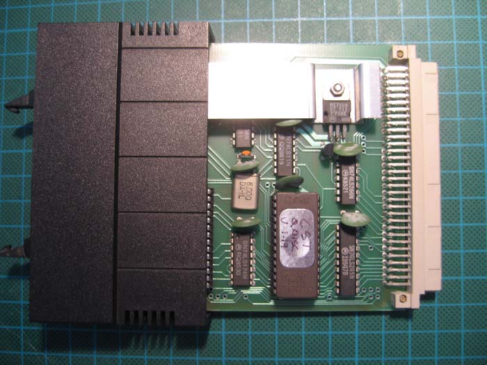

Hi forum ,
help needed ..............i am rebuilding my old kit , and i am stuck with a weird problem ( and my old drawings are all binned about 20 years ago ) .
i got a original ql , qimi ( without mouse ) , minerva 1.98 , 512k module , and , ....................
i recently bought a cst qdisc interface and wanted to hook it up to 2 3,5" drives ( to be flp1 and flp2 ).
i connected them the way that goes in " pc-world " 1 straight , and the second with a twist in the cable .
All boots up correctly , but i cannot access them in a correct way.
symptoms besides " format failed " , are that both drives have their led's on ( when flp2 is accessed ) , i can only give a format command to flp2 , flp1 is not responding ( so no light too ) .
something must be wrong there ........................
Can anyone shine a bright light on this problem :-)
techy

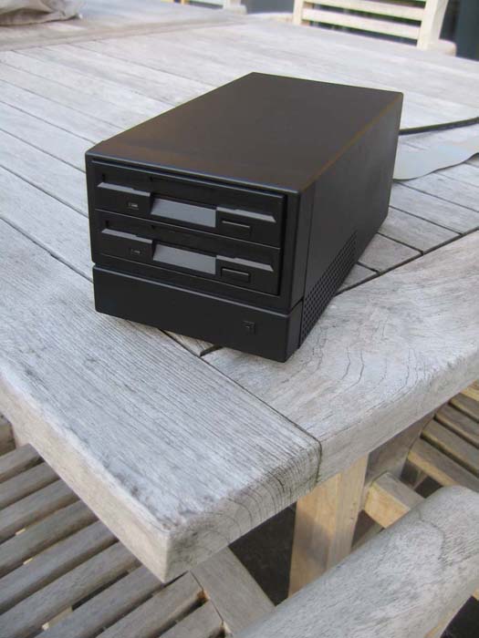

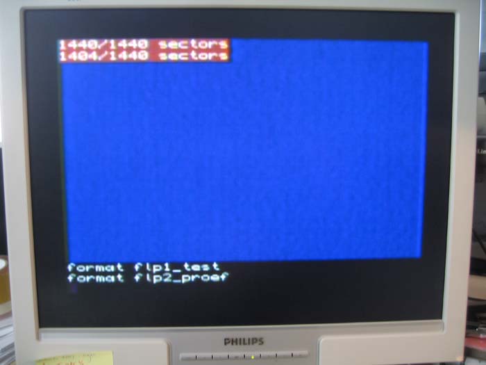

Thanks for all your replys ,
It is working as it did in '85 ;-)
The only problem i see is that one of the mitsumi D359 drives is acting up a bit .
I am constantly missing sectors when formatting on that dirve .
Case has been finished and it looks rather smart ( IMHO ) .

RWAP
RWAP Master
Posts: 2893
Re: SOLVED !! 3.5 " floppy connection to qdisc interface
Post by RWAP »
Looks really nice - what did you do for a case?
techy
Posts: 384
Location: belgium
Post by techy »

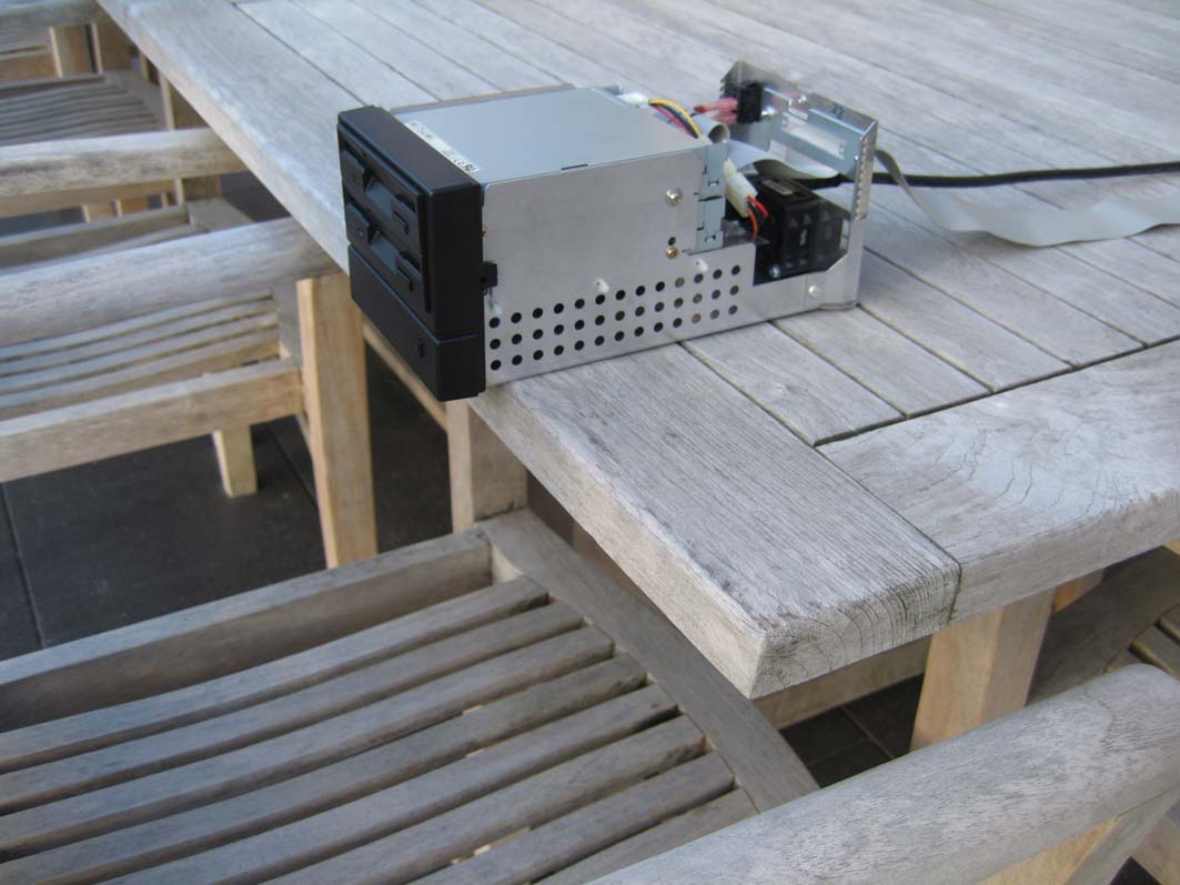

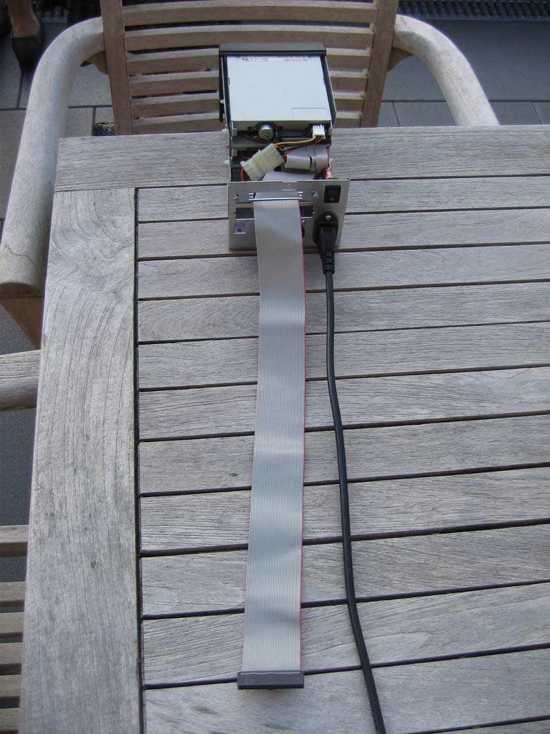

The case is an old HP optical 3,5" single unit with build in powersupply and green power led..
Disadvantage , beeing scsi it has a couple of really big holes on the back , but the advantage of a build in quiet-fan is making up for that.
Cut out the front panel to house double 3,5" , adapted the internal cabling , and ofcourse sprayed it black to suit q'elly .
drives are mitsumi's .
techy
Posts: 2853
Looks really good, I thought it was a proper QL drive unit! 8-)
