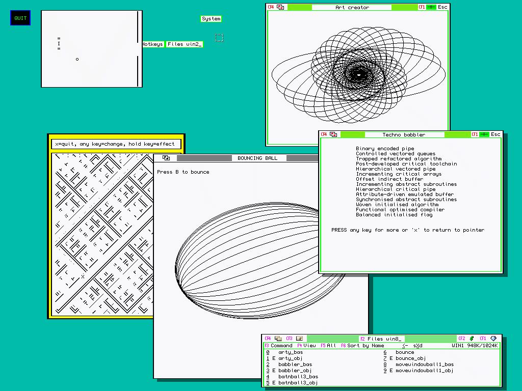

Some of the trivial but possibly mildly amusing programs I have written can be found in a zipped WIN disk as follows:
The bat and ball game might run on a QL and could be entered (if it works) into the "Crap games for QL" competition if someone wants to do this. The idea is move the "bat" to stop the bouncing ball escaping through the slit using the arrow keys. Esc kills the program
The "Bounce" program produces ever changing linear patterns that are adjusted by pressing or holding down a key.
The babbler is an improved (slightly) version of the one I posted earlier.
The art and ball programs are activated by clicking on the B or +.
5 trivial SBASIC programs

Here is QPC2 v5.01 SMSQ/E v3.38, running the SMS2 programmes from QD 2018 with QD/SBAS Interpreter Thing for each Basic file: Works in SMSQmulator, Q68, or anything that is running SMSQ/E
If I had used QBASIC, the output would be compiled programmes rather than the QD/SBAS Interpreted ouptut. But Multi-tasking Basic is very easy on a modern QL.
Not too bad for compatibility...
