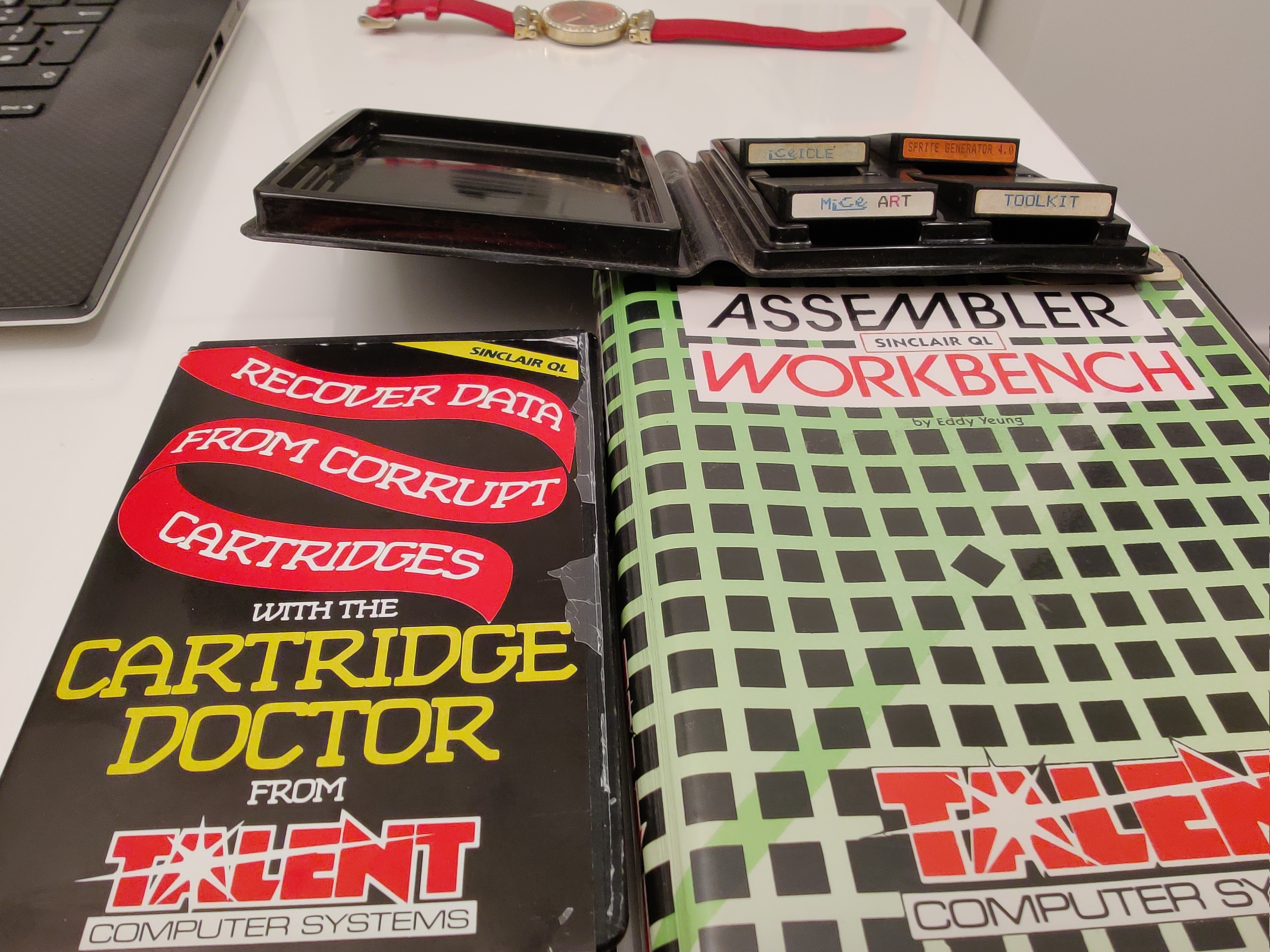

3. I have the following original software:
And if I can't repair and copy the carts, I'd like to potentially download MDV images of it all so that I can at least use the software, some of which goes with my ICE GUI ROM cart + mouse.
