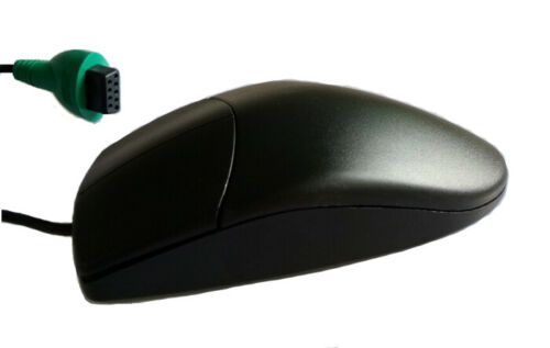

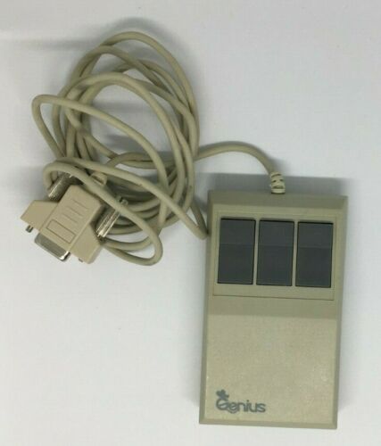

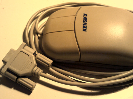

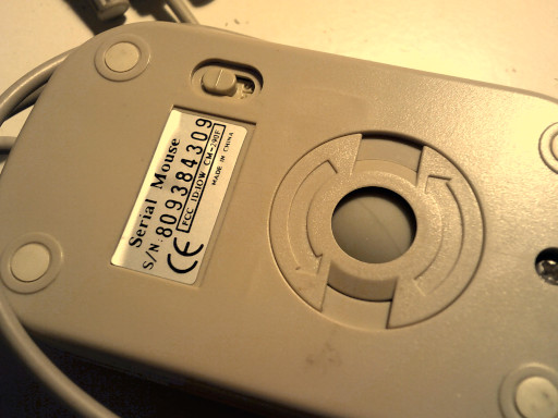

I can offer some advice, having recently struggled with the same issue.
Most mice did not work and as a beginner I found it quite confusing but I after trial and error and I can confirm that there is a black serial mouse on eBay that does work and also the original genius mouse does work (but only the one that has a switch in front to change it's serial protocol).
I have attached pictures.

mselkin wrote:there is a black serial mouse on eBay that does work
Is it the same mouse as this? viewtopic.php?f=2&t=3197&hilit=mouse#p33208
mselkin
Posts: 85
Re: QL Mouse cable connections
Post by mselkin »
Yes

Hi, here is the one I purchased but unfortunately it says zero left.
https://www.ebay.ca/itm/202851046724
mselkin
Posts: 85
Post by mselkin »
I found this one, from China, I believe it is the same mouse:
https://www.ebay.ca/itm/322588661391?ha ... Swf1FfA0bV
